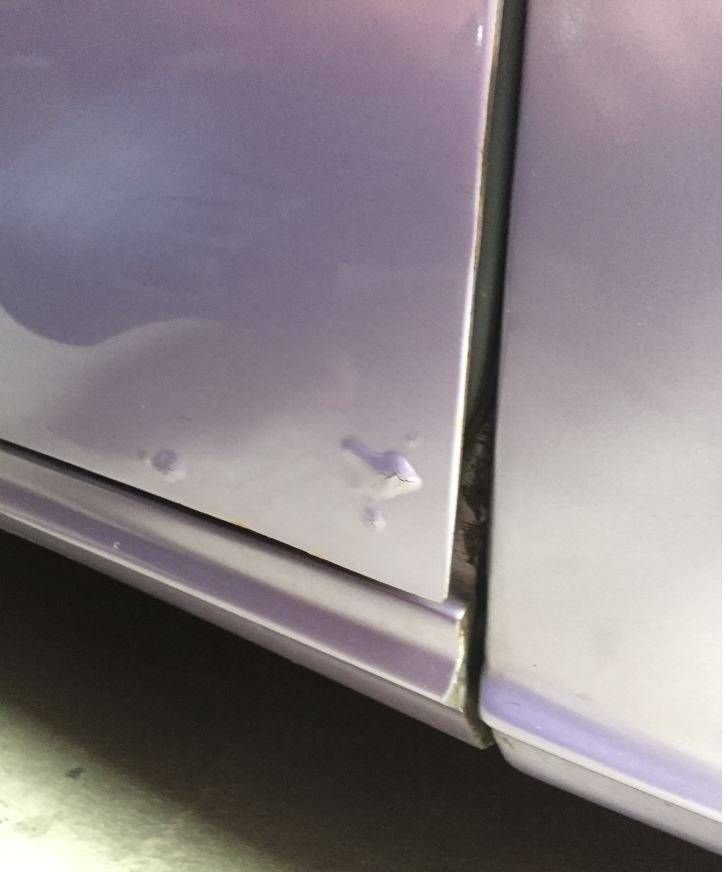

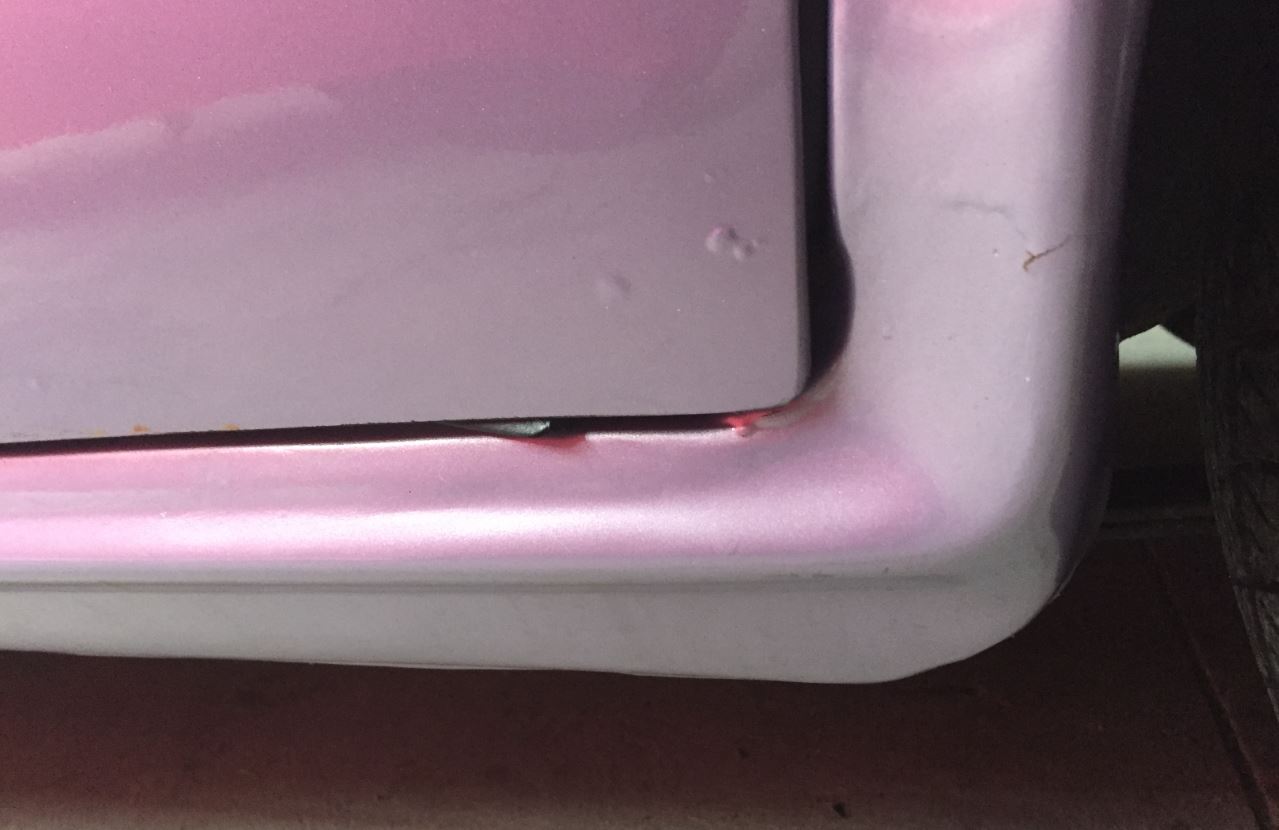

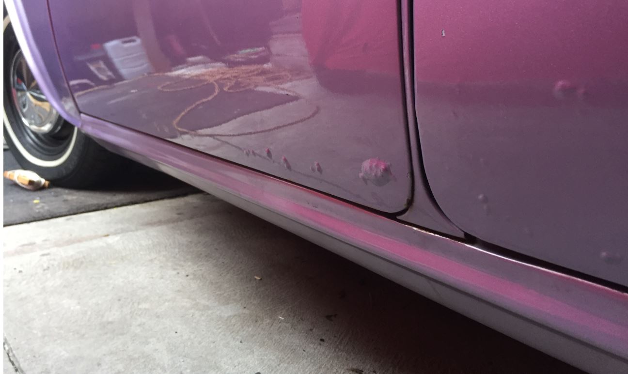

Well, i got 15 or so years out of the bottom of the doors being reskinned but as expected it back.
may have a go at the rear dog leg sections also and remove the bog.
will def hand it over for the paint but diy for the chop and weld?

The rule of icebergs applies here. What you see bubbling through is minuscule in comparison with what will be lurking under the surface. And the bottoms of the door frames won't be free of rust either. You'll have to undress the doors to make an honest appraisal of their condition - take the paint off the perimeter of the skins, take the trims off inside and have a good gaze at what's going on inside the doors. It looks to me like the body shop who painted the car last didn't rust-proof inside the doors. And you've got salt air to contend with too.
The two passenger's side doors will need the bottom of the skin replacing. The driver's door appears to have cancer pretty much all the way along the bottom and up the B-pillar side. Your RHR door may be the best of the four. Rare Spares sells half-door skins for FE-FC. The skins for the rear doors will suit FB-EK, and I'm pretty certain the skins for the front doors will also suit FB-EK.
My two cents' worth: unless you have experience welding thin sheet metal and are confident enough to re-skin a door, take the car to a panelbeater who specialises in restoring classics. They'll be able to get your panel gaps right too. But you'll need deep pockets.

I
Hi Marty,
I agree with Rob, what you see is probably 5 times worse underneath. No such thing as surface rust when there's bubbles.
These cars need lots of attention to rust proofing and draining.
Have you thought about finding some replacement doors, will be quicker and may be cheaper as well.
Hi Marty,

Have to agree, get the best panels you can, but it is getting hard to do.
Half skins can be done, but beware of rust behind the door handles where there is double skin. Rust holes in the inner flat sections are easy enough but corners and sides are trickier.

yes . agree, one bubble is what has made it t the surface from the other side with lots more ready to pop through. will poke around and see if its crumbly red flakes or if theres any metal still there.EK283 wrote: Sun Apr 19, 2020 10:20 am I
Hi Marty,
i did consider replacement doors and saw a full set of 4 for $600 plus shipping from east states but they looked worse than mine with rust coming through the frame.
i'll take to it with a wire wheel and poke around to asses how much has to be cut before chasing replacement parts
can't get that much cheaper than a bit of time on a welder and grinder in iso
