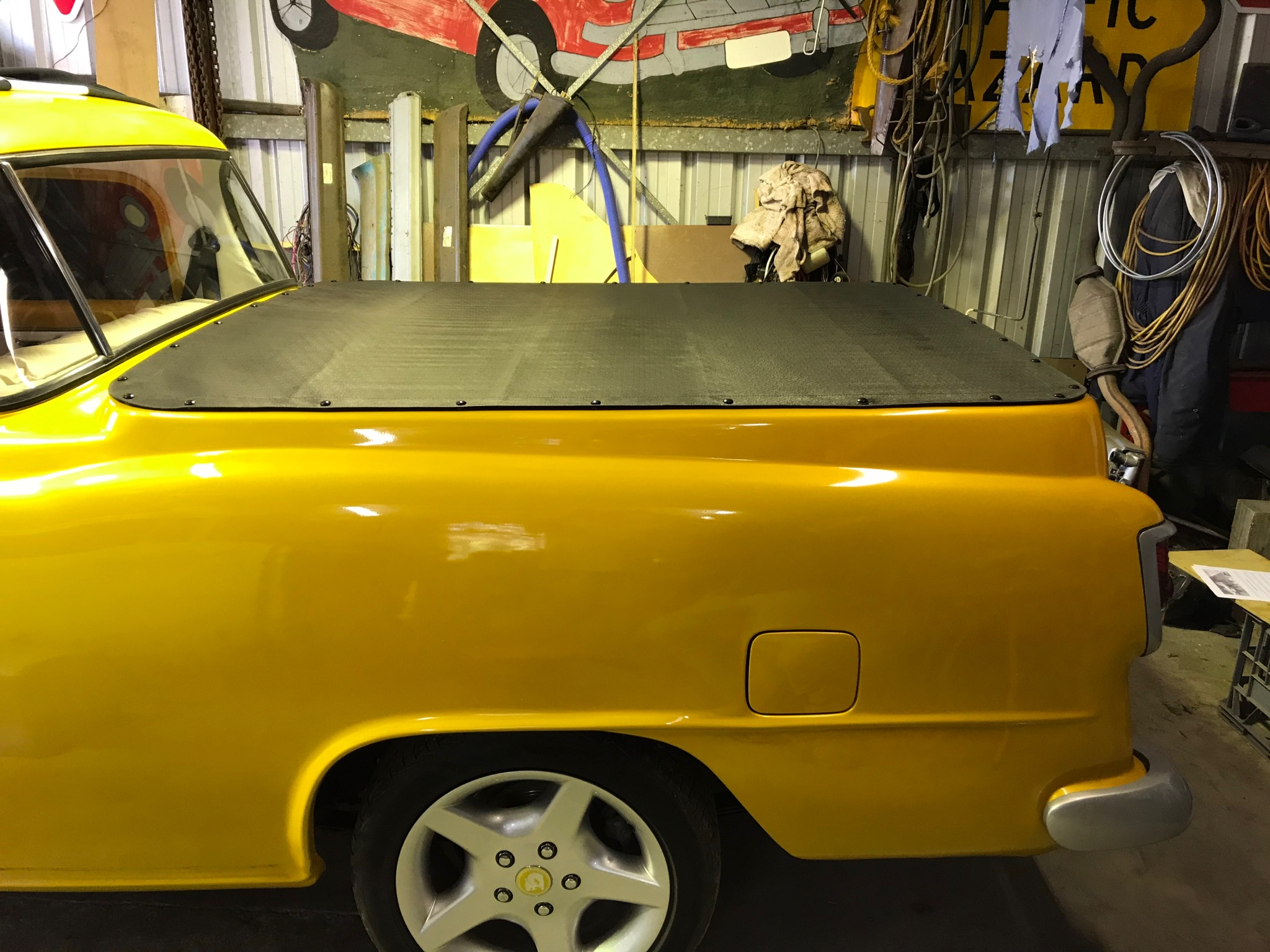

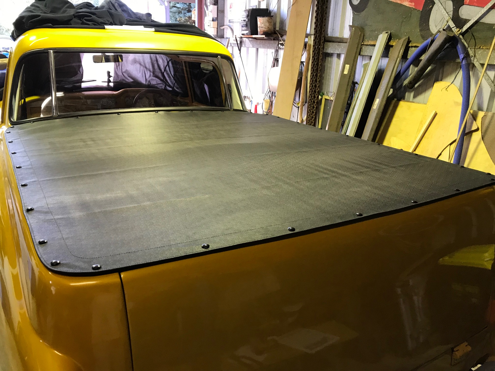

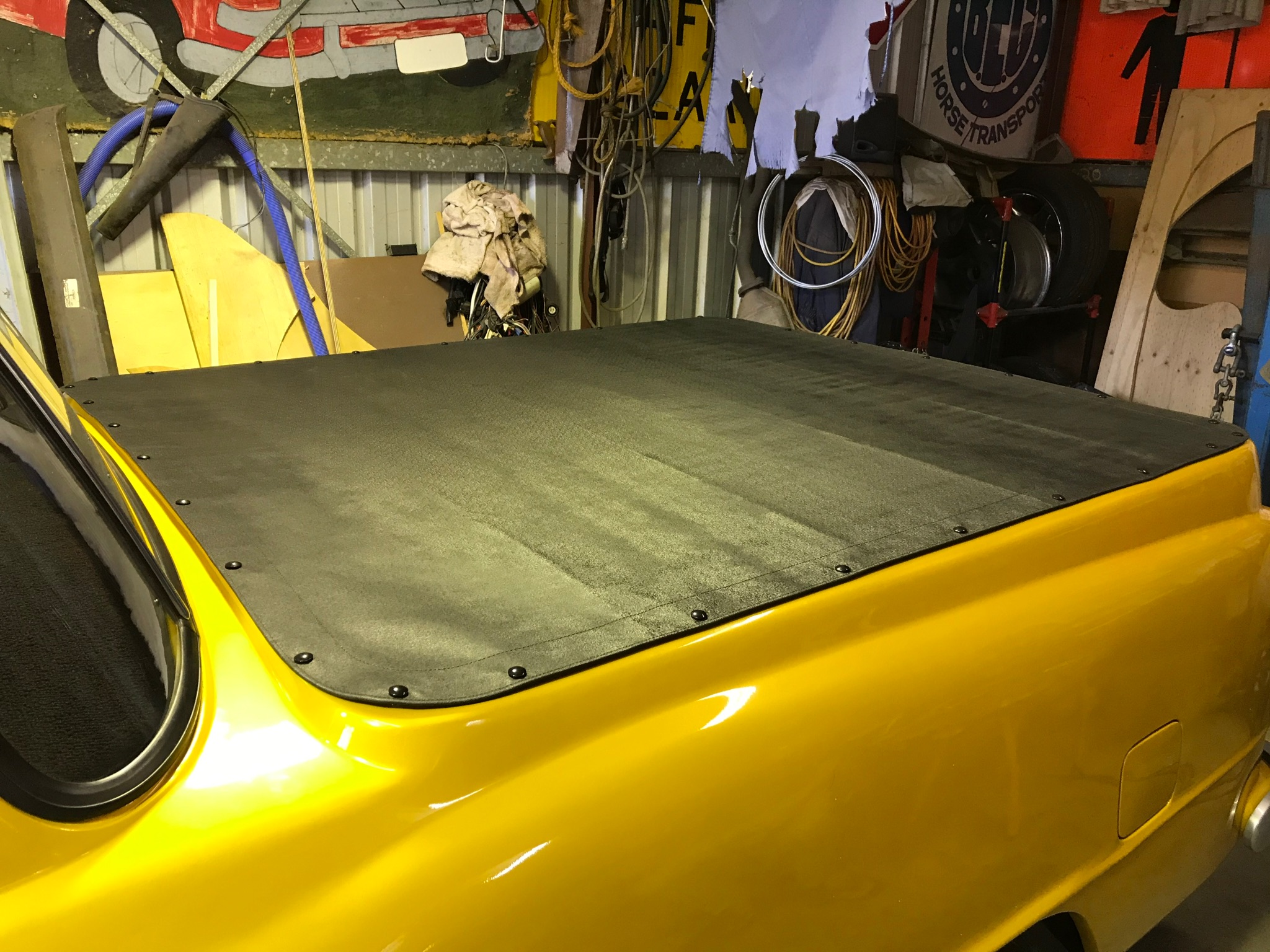

Thanks to Dave at Tonnos n Stuff I received my replacement tonno last Monday and Keith and I completed fitting it yesterday.
Really happy with the way it looks I always liked the flat look of Blacky's, we got it as tight as we could and I'm going to let it relax for awhile and then maybe adjust the height of the centre bow.

62ekute
Posts: 645
State: ACT
Re: Neils Frankenstein Ute
Post by 62ekute »
Hi Neil
yep. like the flat look...does it look like the edge will seal well?
Patrick
Posts: 11679
Looks great Neil. You would have made the nats.
mph
Posts: 787
Location: Perth's North
Post by mph »
Looks very flush mate
