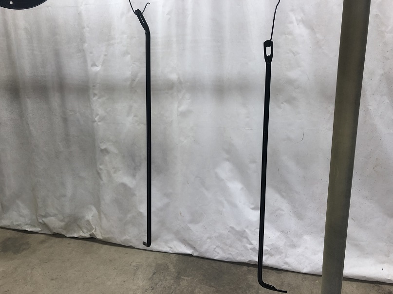

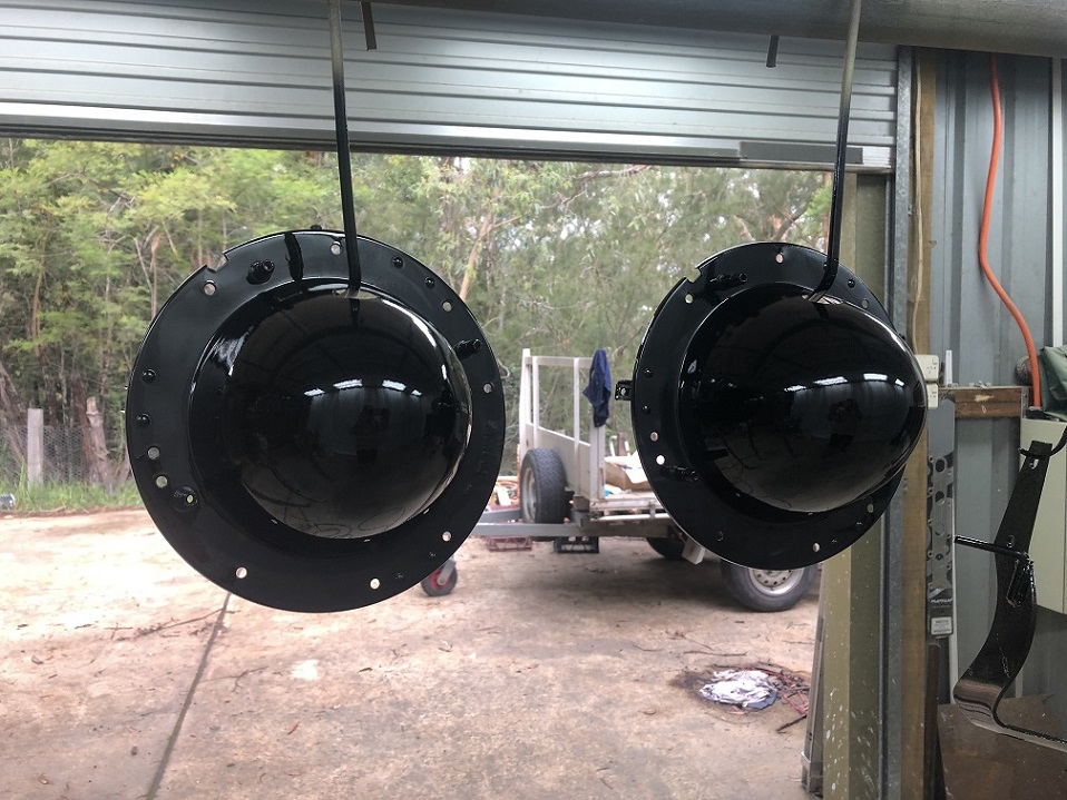

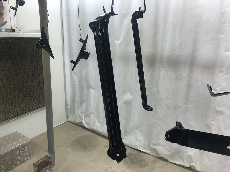

Sandblasted and painted all the bits and pieces I have left apart from the panels, getting there finally.
I've had 3 EK's and none of them had the front guard bracing as in the last two pictures, has anyone got a photo of where they go please.

They go from the top bonnet catch cross bar outer end bolt through inner guard, angling down at about 60 degrees and out to the bumper outer rear nut bolt through bottom front of guard. You must have had the lightened racing body cars. 8)8)8)

Thanks,
That's great probably would have been head scratching.
