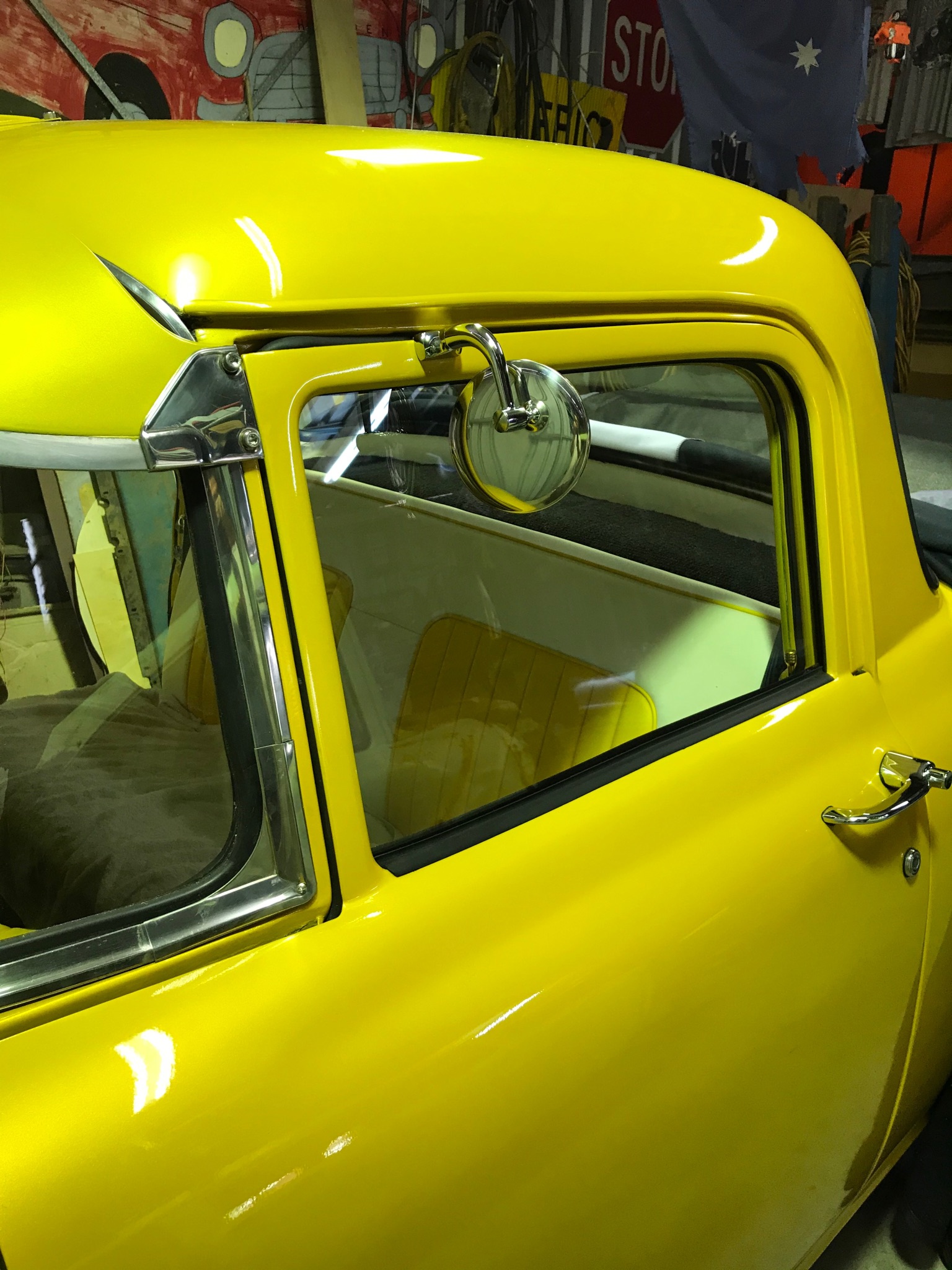

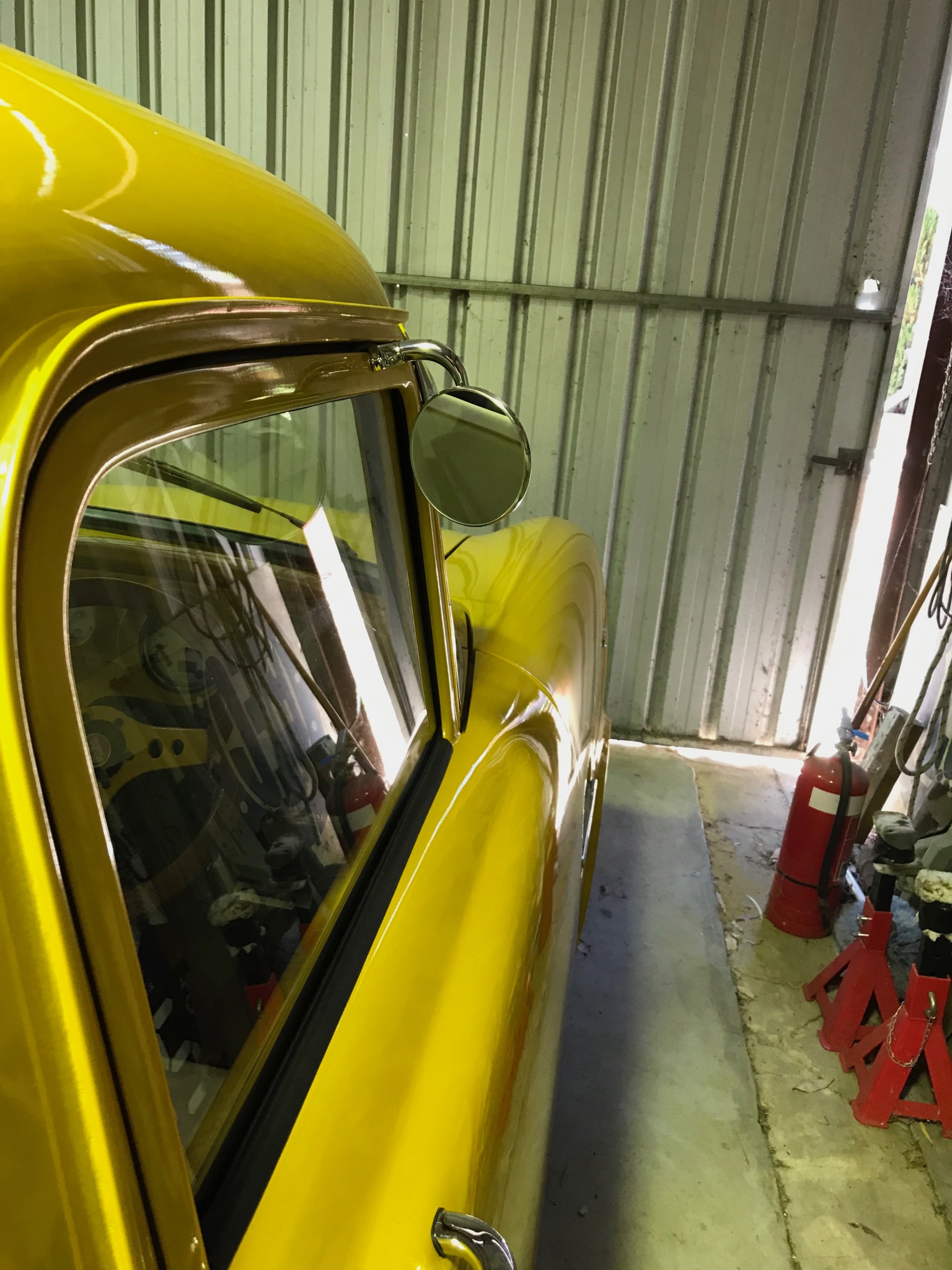

I see you have one piece side windows.
What are you doing for side rear view mirrors?
I would be interested in this as I believe they have to be fitted as part of Licensing.
Posts: 2819
Re: Neils Frankenstein Ute
Hi Cliff

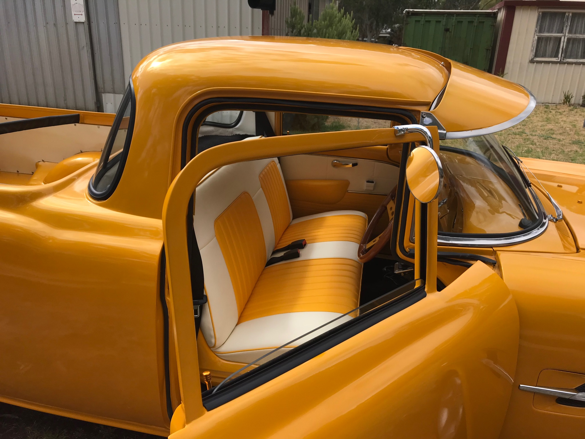

I have Peep mirrors to go on either side similiar to the one below, this one is on my 58 FC Sedan, they will go on the top of the doors of my ute.

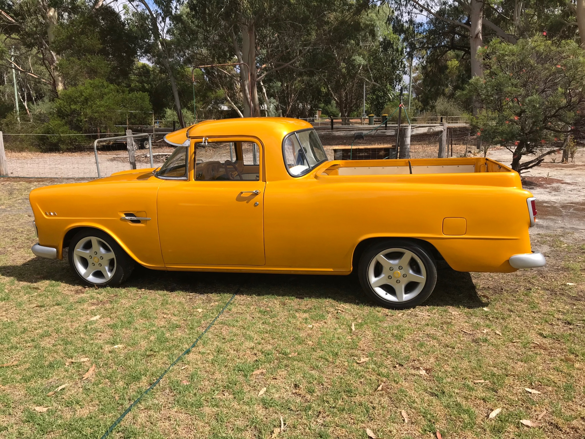

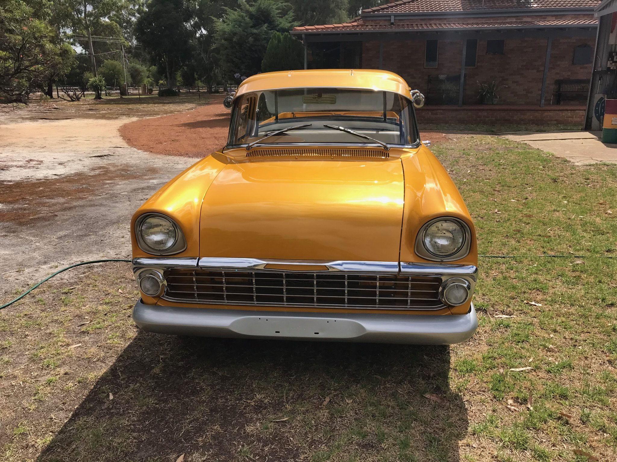

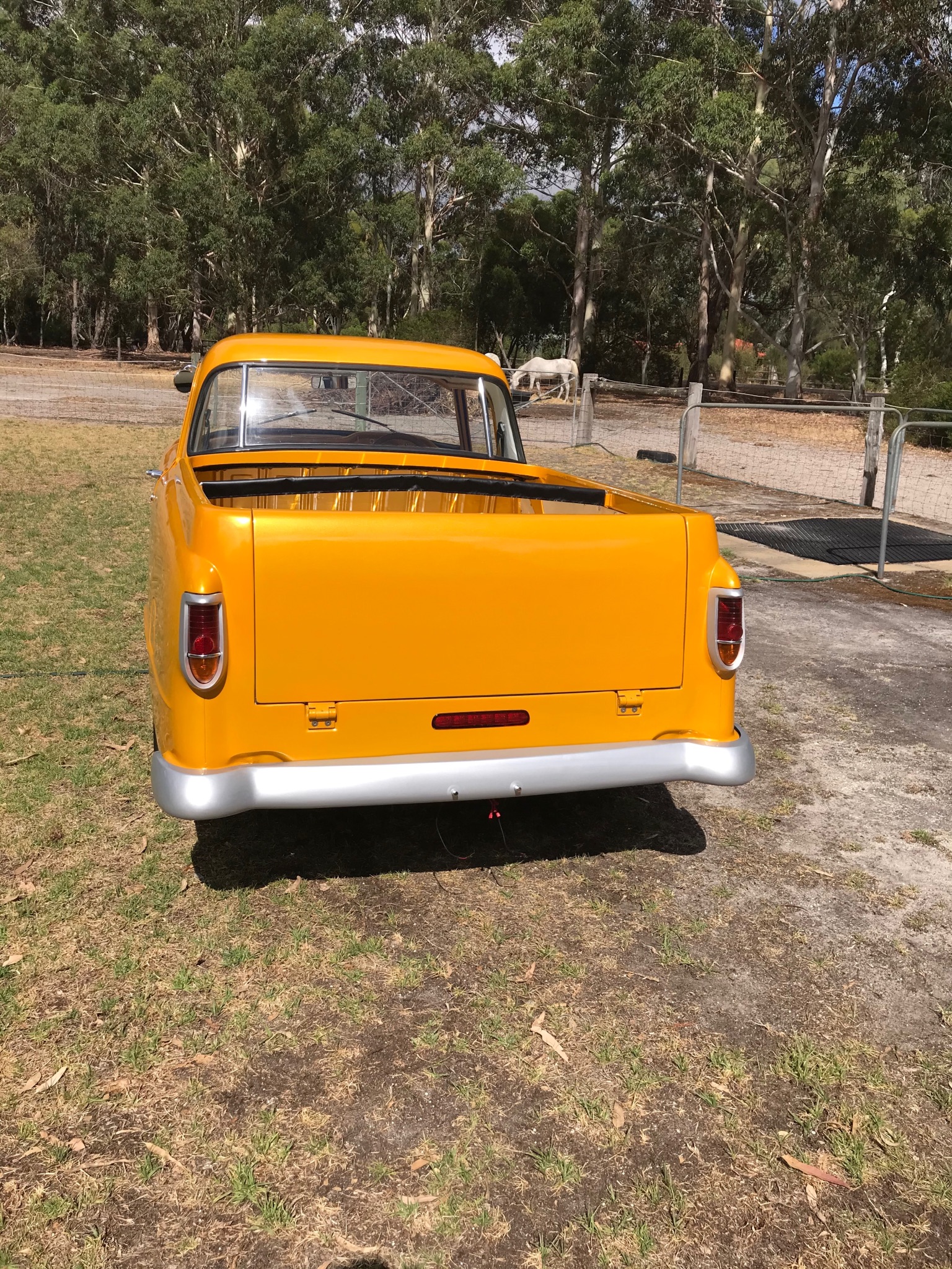

I got some more mirror adhesive and gave it another try I think the problem the first time was that it was just way too hot packet says between 10 & 25 degrees so it worked out great this time.
I also finally grew some kahunas and drove Frank out of the workshop for just the second time to check brake operation under power and I'm really happy to say they worked really great.
Thought I would post some photos of Frankenstein outside in the sun hope you all don't mind.
So now I think the last major thing is to have the exhaust done.

Looks great Kneel, and the timber deck colour is cool out in the sun.
Cheers, John
Posts: 11679

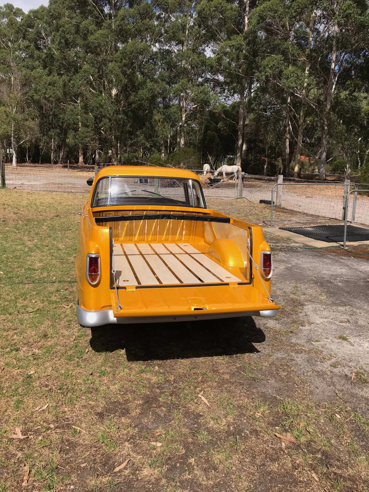

Wow Neil. Paint and attention to detail look fabulous.

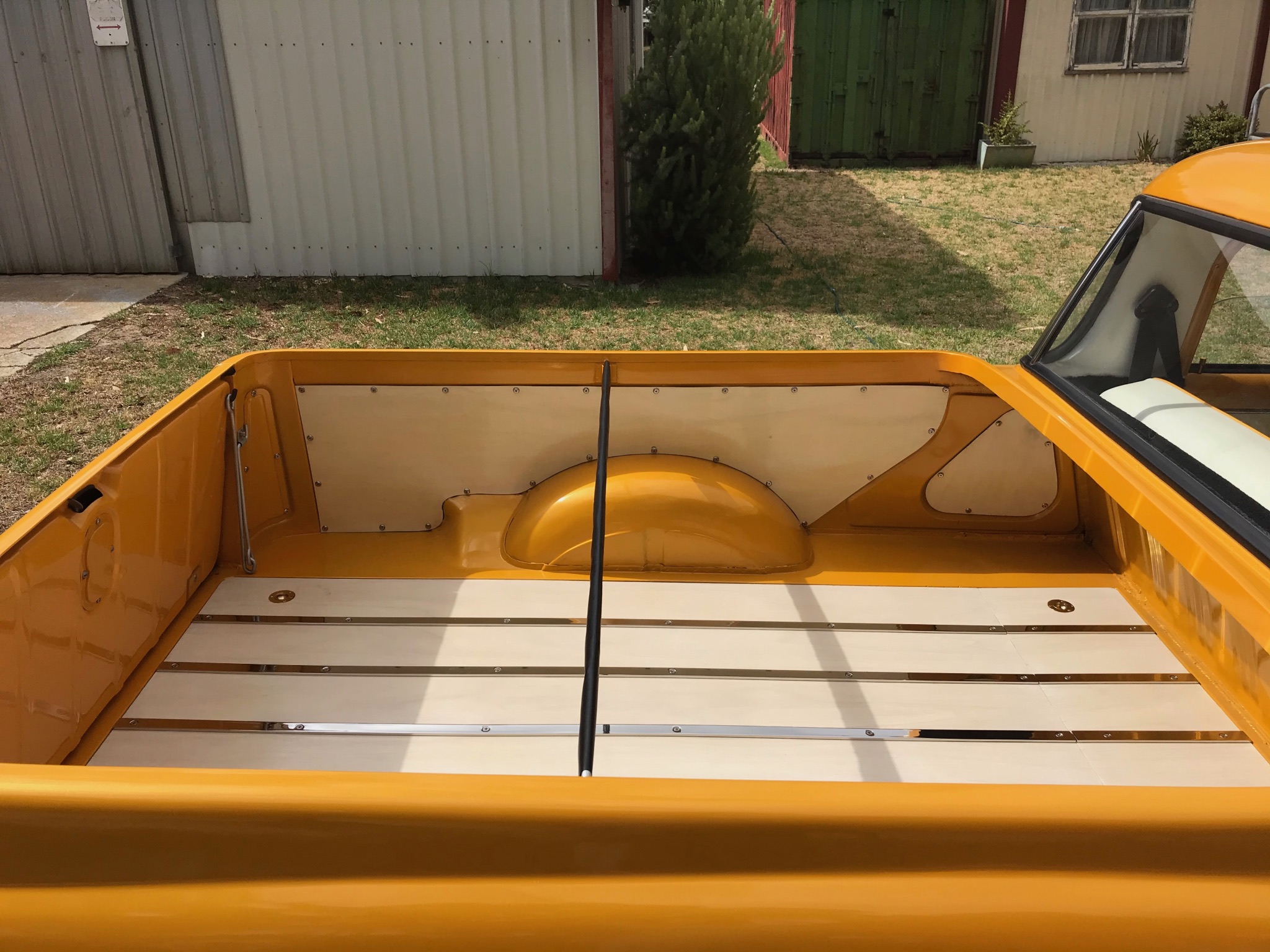

Can I ask what the fasteners are you used on the false floor? I’ll troll back and see if I can find it.

Posts: 2819
Thanks guys.
Gaz the colour is so different out in the sun the pearl really comes out and pops.
Clay the tray floor and stainless strips are held down by stainless M6 screws they go through the cross bars of the tray and each one is drilled and tapped so the M6 screws hold the floor and strips down together 30 or 32 drilled and tapped :crazy:
The front section that lifts out, battery is underneath, the stainless strips are just bolted through the piece of board.
Hope that is not too confusing :ebiggrin:

That yellow paint looks absolutely beautiful in the sun 😎

I meant the round things in the corners Neil. Are they a sort of latch or tie downs?
