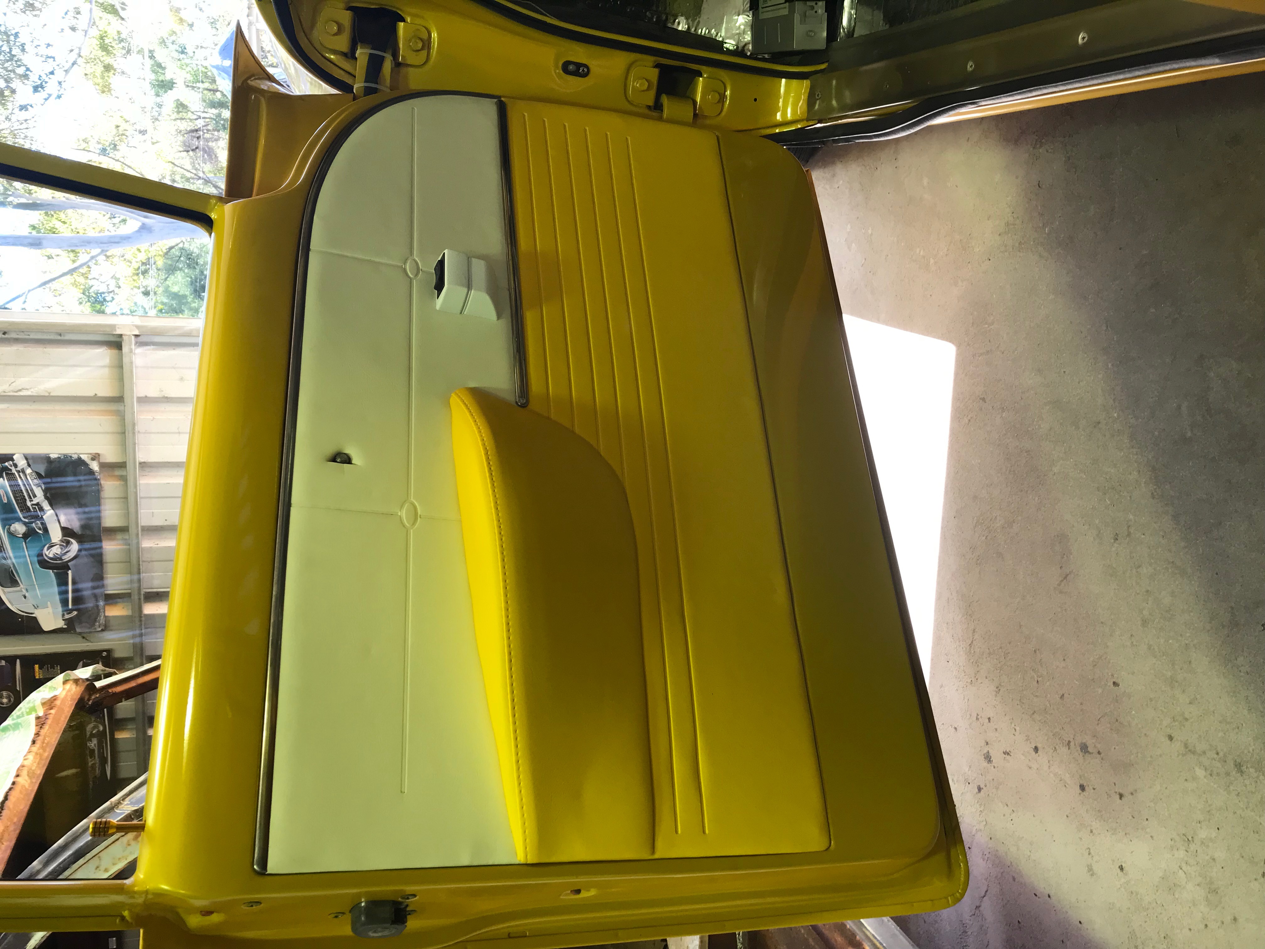

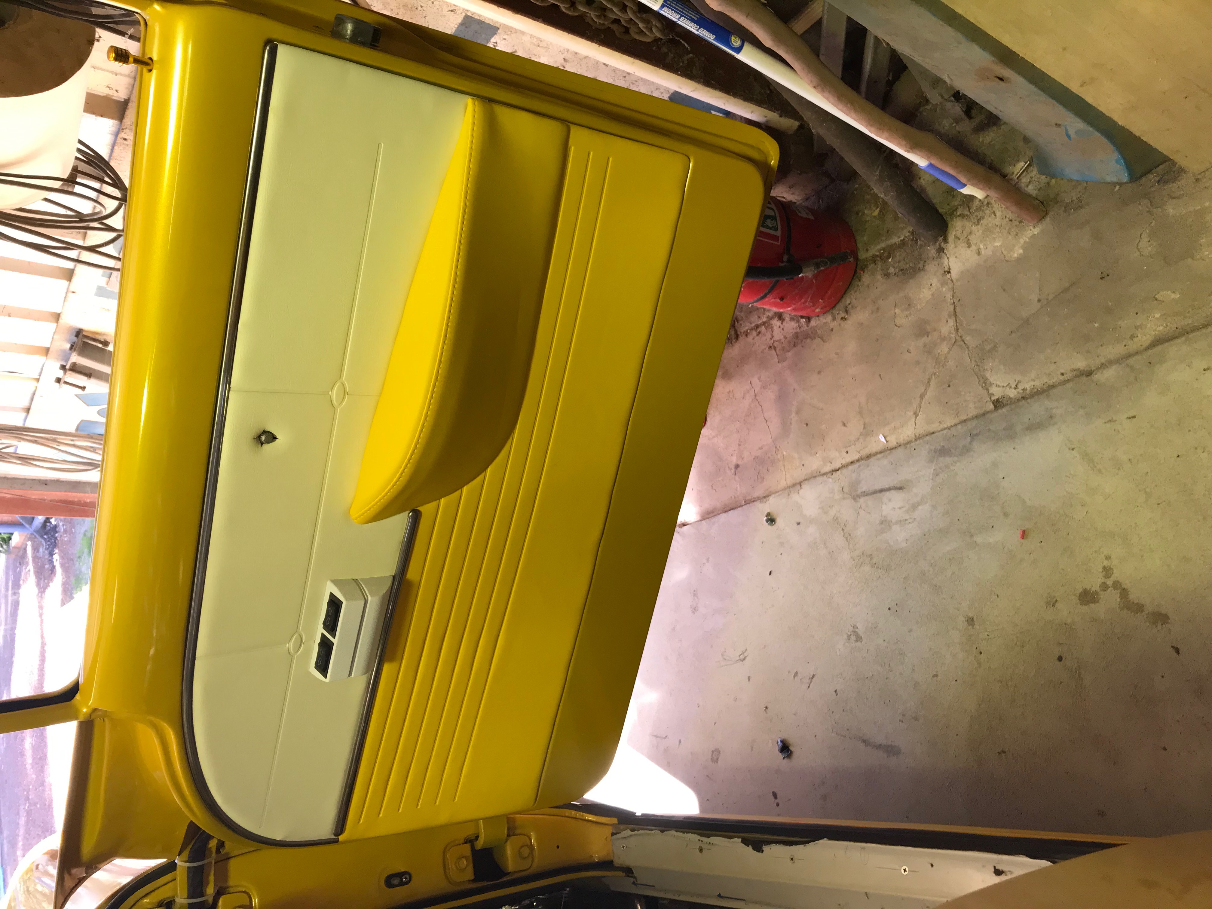

Fitted the door cards yesterday couldn't help myself :roll: the colour was very hard to get an exact match so is the closest the trimmer could get big thanks to Drew "Northside Motor Trimmers" fitted the switches for the electric windows and just to complicate things further for myself I've fitted central locking :crazy:

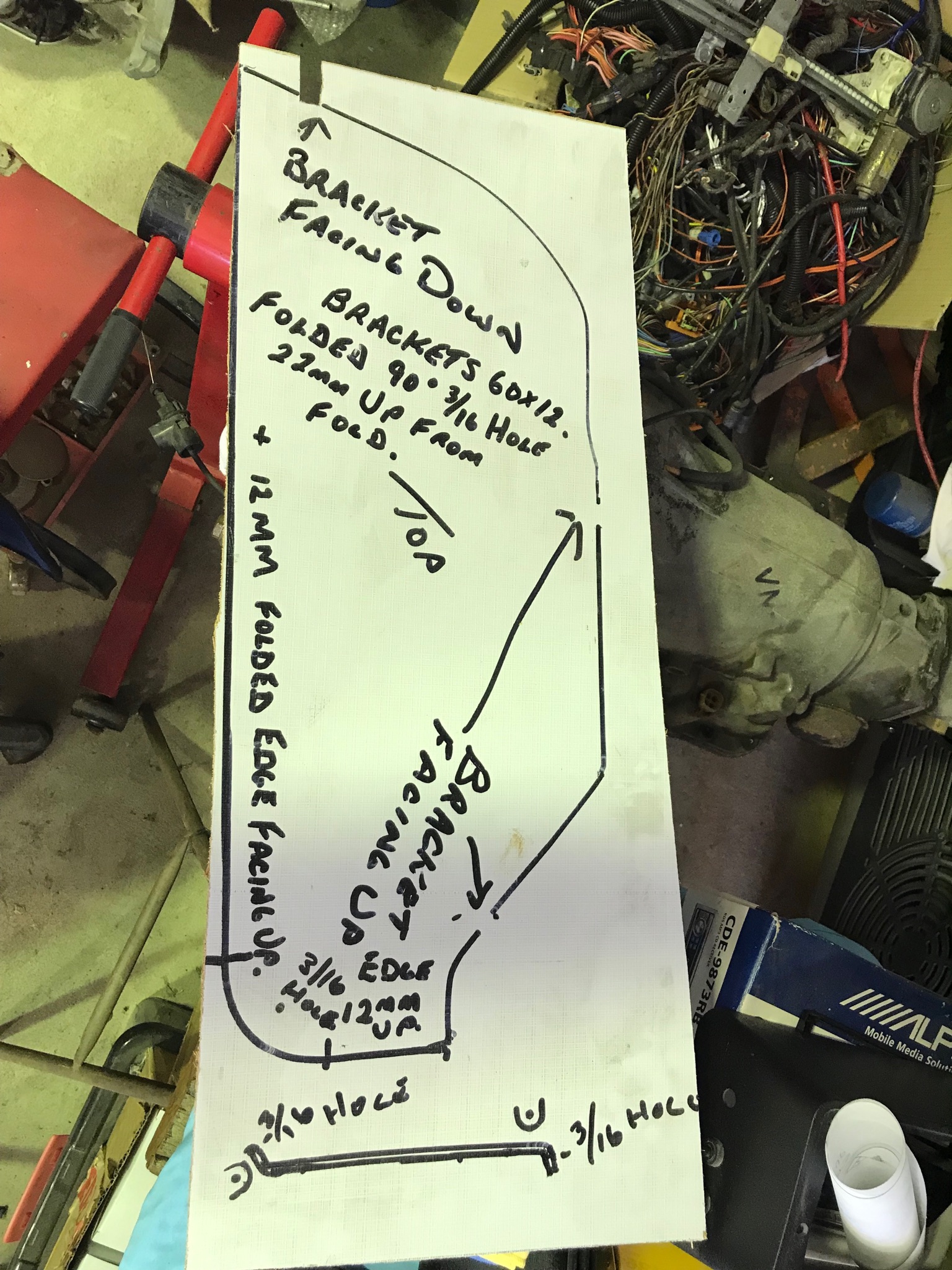

Borrowed Blacky's template for a parcel shelf and started making one that I had to slightly modify as I was going I'm going to use this to put the engine ECU on.

trims look sweet mate :thumbsup:

Nice template. Great resource ol Geoffrey.

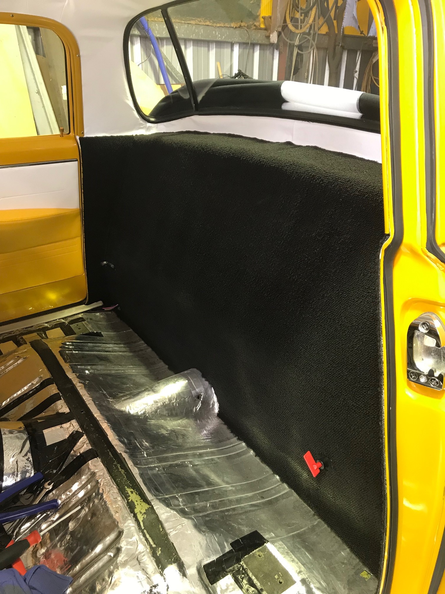

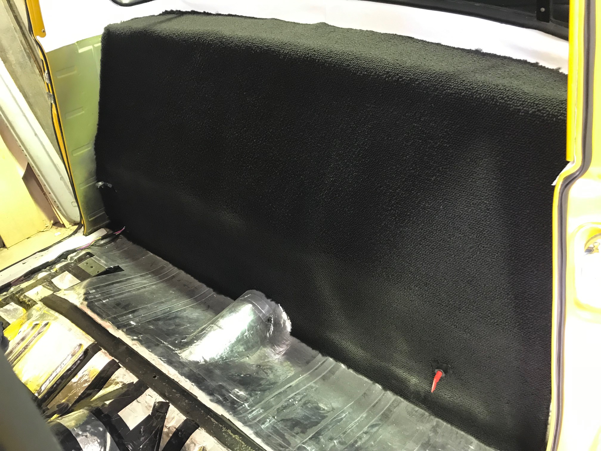

Fitted carpet to behind the seat just have to trim the edge below the rear screen a fraction overnear the drivers side and there are some loose threads to cut. Unfortunately the little bump in the middle top is where the join of the headlining is but I think I smoothed it out better than that after I took the photo :roll: :roll:
Next to do the 'B' pillar bottoms.

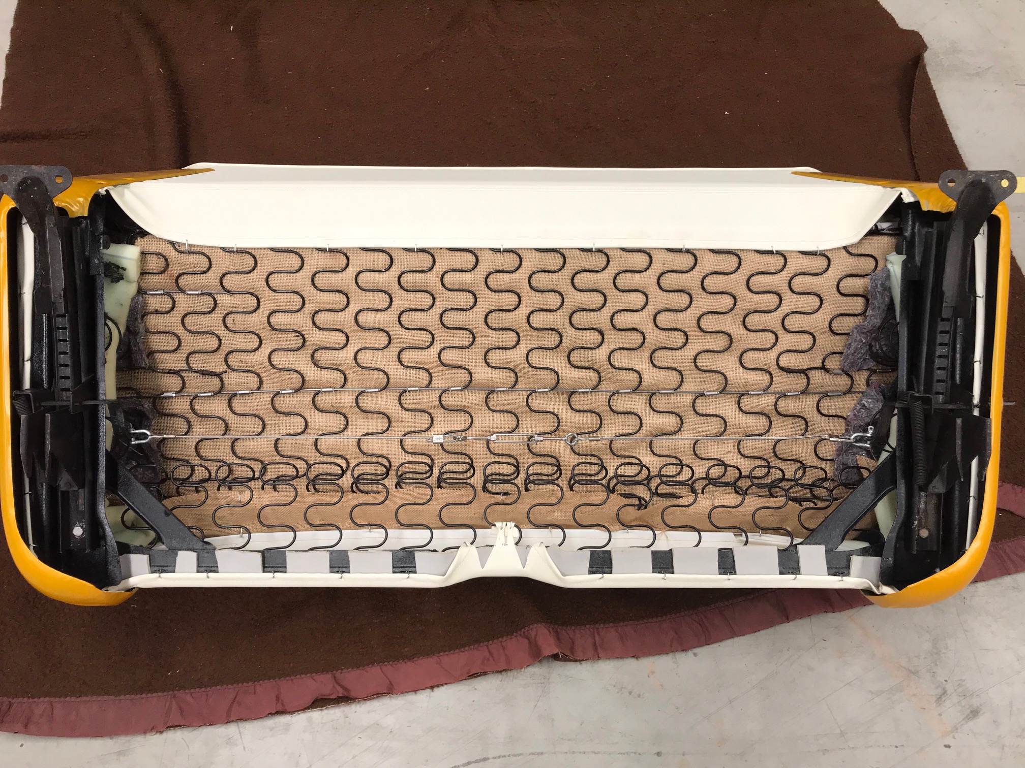

Put the bench seat sides on yesterday and made up a wire for the seat runners
