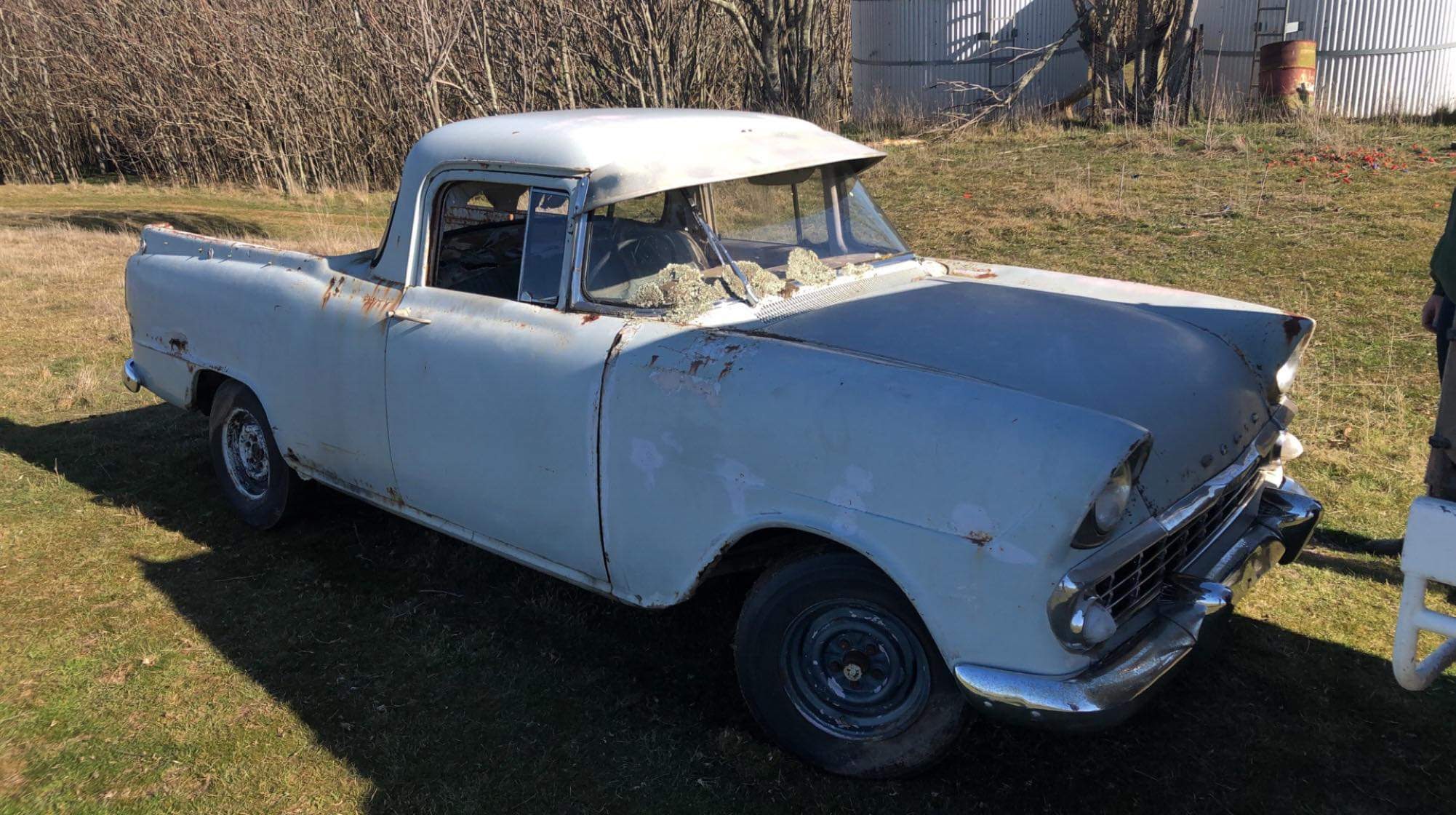

A recent purchase. Plan is to continue on Wilma and once finished move over to Project 2. As you can see Project 2 has a few minor holes here and there but if you don't count the tub it's about the same as Wilma was, so not too scary. Actually subframe arms are better. The ute may have spent time in Woolongong 'cause I found a dog collar amongst historical detritus that had a 1977 Woolongong council tag. Purchased from near Goulburn.
Must have a sedan seat in it as there is a lovely sedan ashtray facing the back wall. Don't know about motor or drive train at the moment but may spend an hour or so seeing if she'll start in between atending to Wilma's floors. Original paint might be the infamous Cameo Beige(?), but is over coated with a light blue/grey.
I'll add bits to this post as I go, but don't plan to do much more than gather bits for the next few months.

More photos please Brett.

You either need to find a van to cut up or fabricate around a donor tank of course, which is the more viable option. Particularly if you are planning on a later injected motor. How are the rear spring mounts and rails? Maybe a candidate for a tubbed rear end.

I've got a stainless tank to go in when I get there eventually, but yes a rear end would progress things along rapidly. I actually have a spare sedan rear end that would take care of some of the bits but the tricky bit for me is getting the back panel made or sourced, as not having another ute here to compare to means I'm working from nothing. Would be very happy to pick up a solid rear if one is out there.
Rest of body is usual holed floors and rusty bits but not bothered by that having just gone through it on the sedan.

Any ute or van that has a half decent rear floor is very likely to be better than yours. You can use the sedan floor to address the rails and mounts if you have access to that. Good original tanks are like hens teeth. You fabricate a floor around a commodore or xabc &*#@ tank. One fella used a mk1 cortina tank, got he reckons. Neil has just done this on his Frankenstein ute.

The really good thing about rust in this condition is you don't have weeks of removing, making bits and days of welding and grinding.
You will come across a donor eventually and then its just remove and replace. Hopefully the rails are ok but then people have manufactured whole chassis to fit under them.
Hard work that's all it is and time, good on you for giving it a go.
