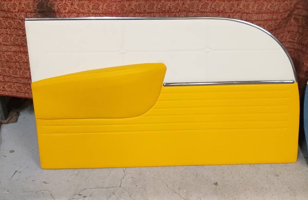

Ordered carpet the other day from Knox carpets on eBay.
Also Drew the trimmer sent me a couple of photos of my bench seat and door trim will pick them up later next week. Regards

I'm waaay too grotty to ever own white trim, but those door cards look stunning. Very neat job

Trim looks great, some tidy stitches there

Looks schmicko Neil
So you didn’t need a cutout for the gearstick - cool.

Very nice Neil. Love the yellow piping. Don’t forget to take the scanners out of the back pocket of your greasy overalls before you get in the car mate.

Trim looks Awesome Neil - can't wait to see it in the truck
