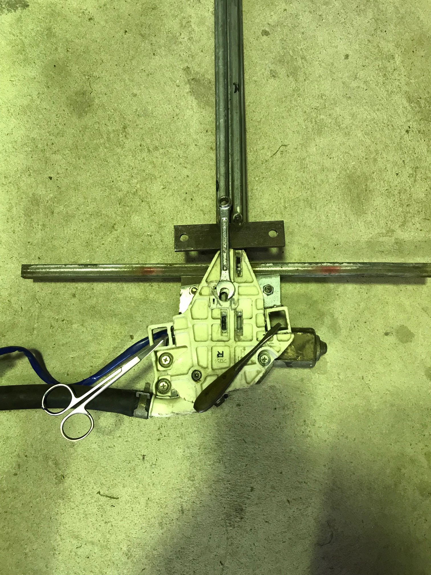

The window mechanisms are from an early f@*d laser this was what Peter had used. They have a bent runner but it can be removed from the mech and straightened, some photos below.
First pic shows extra mounting bracket tacked to the runner
Second pic shows glass runner mounted to the mech
Motor details
When I was trying to mount the plastic part I found that the mounting points were angled and I could not get it to sit flush so I removed them and only used the one I tacked on, the little tools show where the mounts were and now are not :esurprised:

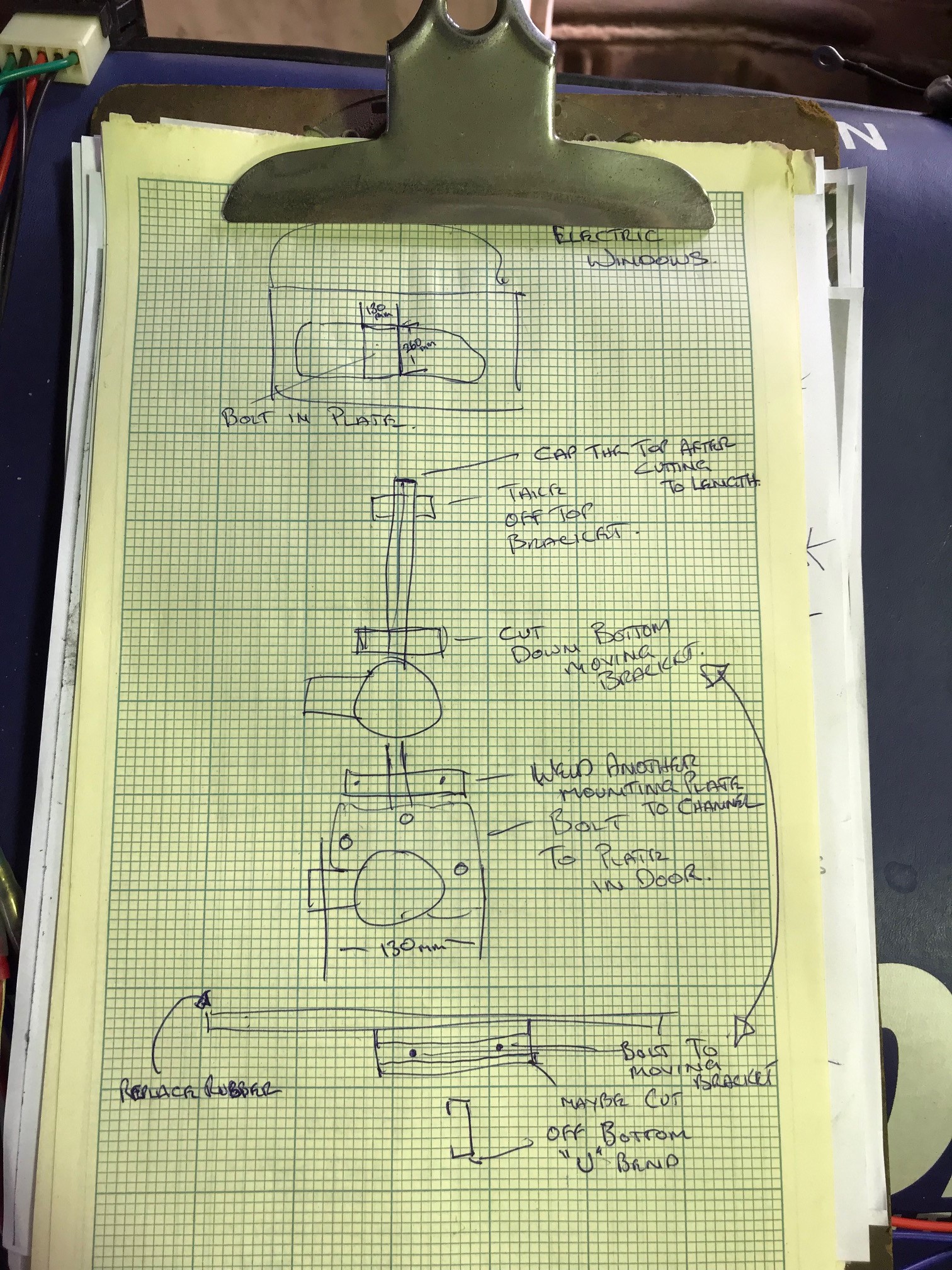

And the last one of course is my notes and drwaing before I started if this makes sense :roll:

Also, that’s a great engineering drawing, it’s to scale and everything!

Ended up sorting out the electric windows, I found that because the mechanisms are second hand they can be a little tied :crazy: I had a spare passenger side motor, swapped it and it now works really well, used Sikaflex one the bottom of the window to window runner channel and let it set for a couple of days and now goes up and down no dramas, drivers side motor seems a tied so may have to replace it.
