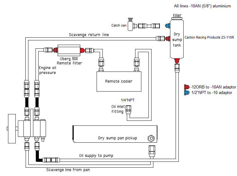

My intention is to fit a dry sump to the meth monster motor. Why? There are some horsepower gains to be had (from less oil mist bouncing around in the crankcase)… but mainly because I have the bits, and like the idea of running one. The overall layout of the system is as per below:
dry sump plumbing.png (20.6 KiB) Viewed 1760 times
In simple terms, the GMH oil pump gets removed from the grey, and it’s discharge port blocked off inside the block. An external pump then takes suction from the sump, and a heap of fancy kit is used to clean, store and pressurise the oil before returning it to the motor. The diagram below gives you some idea of what this looks like – standard grey motor on the left, dry sump on the right:
Drysump oil flow to oil users.png (593.78 KiB) Viewed 1760 times
Note that the image on the right shows a shallower oil pan (that’s the plan), but shows a heap of “red” oil in it. In reality, the pan will be nearly dry, with the external oil pump scavenging as much as it can.
