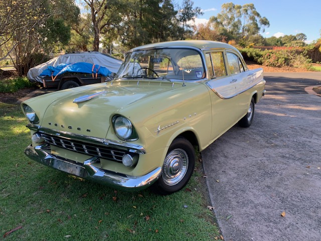

Ive recently become custodian of an FB special, still with original nitrocellulose duco. (Fernando Yellow/Arctic Beige). Paint is in reasonable condition, but quite dull and needs some TLC. Id like to restore the shine, but don't want to damage the original paint. Any suggestions appreciated. Thanks for your help

Hand buffing with buffing compound if the paint is dull and thin followed with a turtle wax polish.
If you use a machine buff you have to be very careful, if it burns through well repaint it is.
Any pictures ?

Many thanks Greg. Planning to do it all manually. The old girl already has a few spots where some over zealous polishing has been done by previous custodians. What buffing compound is suitable for old nitro paint?

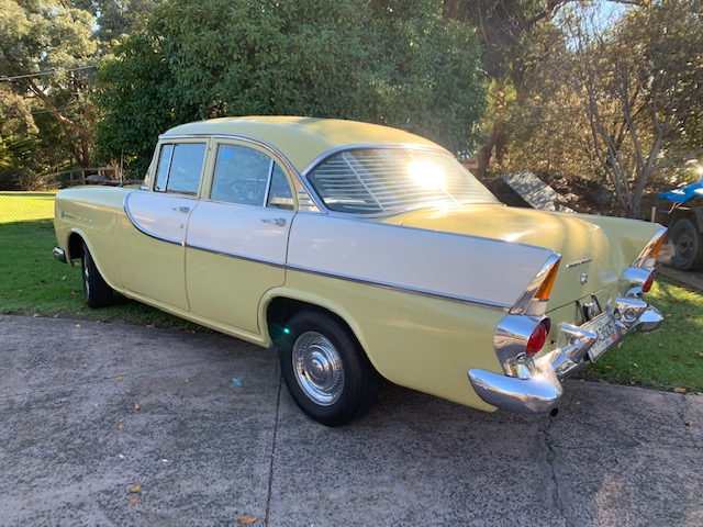

what a pearla :loveee: :loveee:

Yes, Blacky. She's a ripper. Ive been on the hunt for quite some time. Patience paid off, and she has finally followed me home. Nice history and running beautifully thanks to a dear friend who is much more knowledgable under the bonnet than I! Even have the original purchase receipt for 1250 pounds! The original owner traded in an FC and received 810 pounds for the trade in!

Beautiful Ferdi. You’re a lucky bugger!

Whilst flash new colours are nice, the original colours really suit the FB/EKs. That yellow looks great, as does the coral colour on Greg's car. Tiger Mica and Hothouse Green will age, but the original colours haven't.
