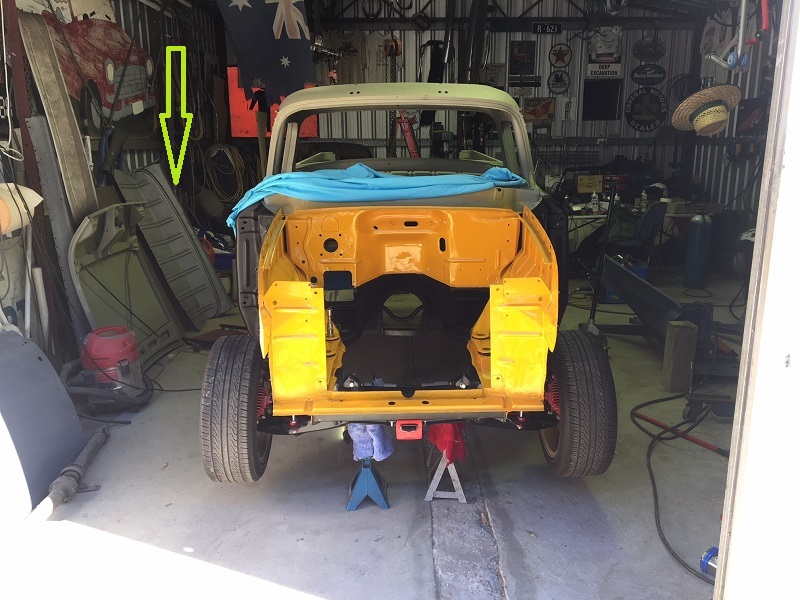

looking sweet mate , I reckon you are better off concentrating on the fuel and brake lines etc - easier to do with the donk and box not in the way, plus the ute will be easier to maneouver in the paint shop without the added weight. Motor and box in looks like bulk progress but its actually one of the easiest steps to do :thumbsup:

I’m with Blacky, motor in later rather than sooner. Lookin’ good mate!

I had better do what I'm told then and get on with it. :wtf: :roll: 8) 8) 8)

Spotted this on the net, looks to be a similar color ?
G'day Neil,
Is this panel a parcel tray?
Posts: 2800
Re: Neils Frankenstein Ute
Yes OZ it is, there is a section of it, actually the piece that goes underneath from side to side in the tray, that has to be unpicked and replaced in my ute.
The panel and paint guy is going to do it but he is not sure if he is just going to unpick the piece or cut the lower window seal section out completely and fit.
What part of it do you need mate :lol: :lol: :lol:
I need the lower section behind the ute seat.... I'm surprised someone hasn't marketed sheets of patch panel with those swage lines pressed/rolled in, given how much it's used throughout these old Holdens.

I share your dream Neil. Been using odd bits of floor to try and match swages on the van floor. The bottom of the vertical panel behind the seat is not good. I think this is the same panel Phil is after.

Errol62 wrote: Wed Feb 28, 2018 4:59 pm I share your dream Neil. Been using odd bits of floor to try and match swages on the van floor. The bottom of the vertical panel behind the seat is not good. I think this is the same panel Phil is after.
Yeah that's the one!
