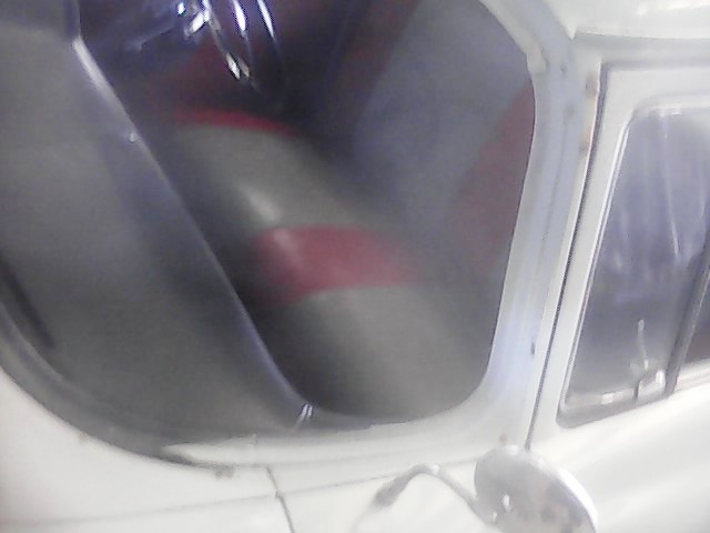

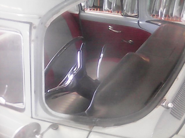

Thanks Rosco, I'll try and digest all this over the next week. I put off the painting as its been humid wet and windy so not the best conditions.
Today we attempted the windscreen with no success. In and out three times. Looks like the Rare Spares seal is the problem. Where the corners are bonded to the top and bottom rubbers they have been overlapped and there is a corresponding ridge and extra thickness in the seal which is preventing the screen from going all the way in. Severly dissapointed. We checked against the old seal and there is a marked difference. Screen fit with out seal (dimension check) was really good.
The old screen hs been saved and will be stored away. Body wise still no rust.

Fitting laminated Tim. We measured up the glass incl thickness at it was all good. Shape and curvatures all good too. I've got it with all the trim screws fitted including the top centre one but the rubber doesn't sit right at the lower rear corners just above the cowl. It's displaced away from the window on both sides because for the lump at the joins.

We've ordered another screen to compare with as well as another seal from a different manufacturer. I'll let you know next week how we go.
