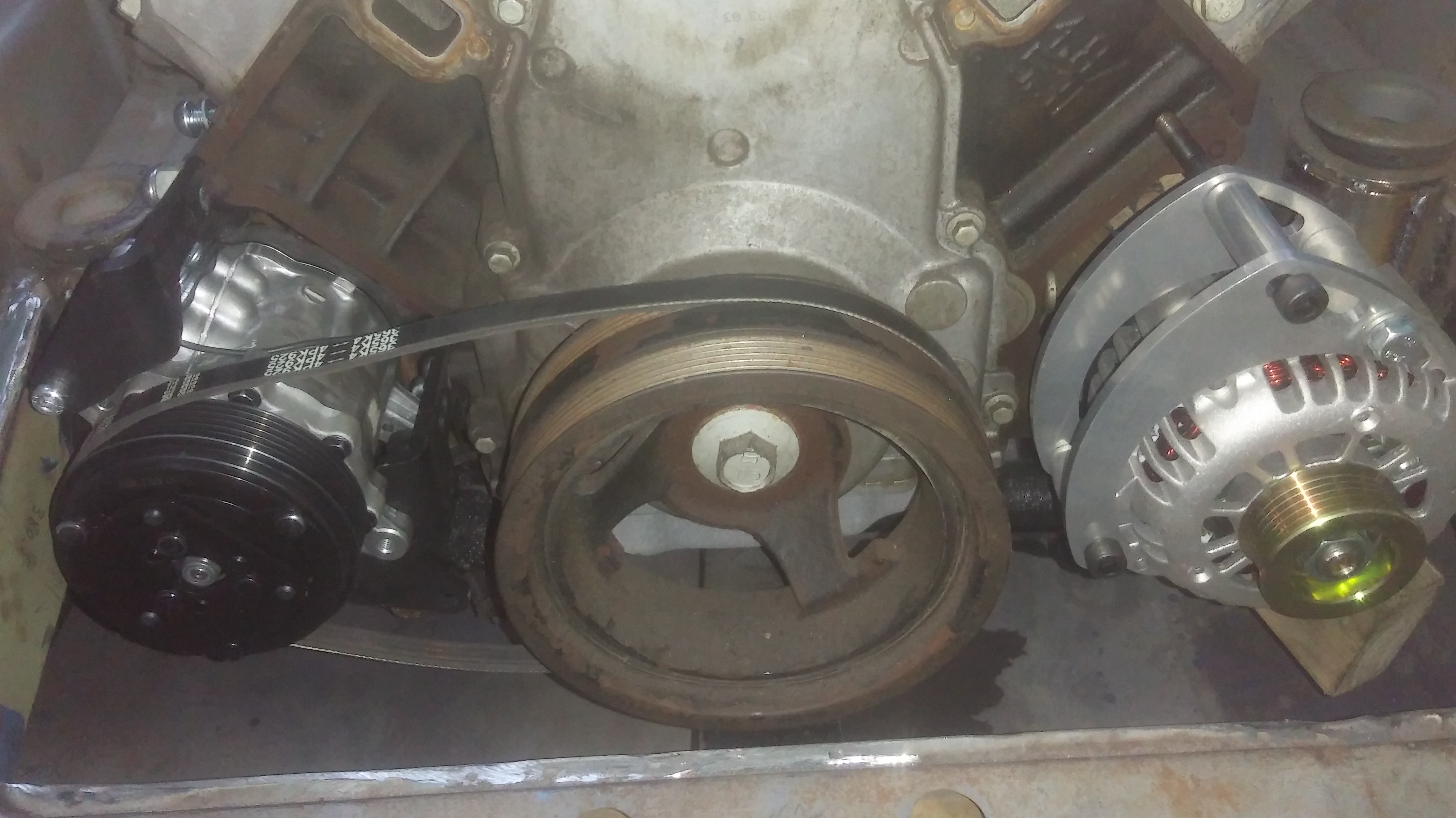

So alternator and air con pump fit up finally completed including boxing the rails, will finish welding etc once on the rotisserie. Plenty of clearance now, next job finish the passanger side floor and then tunnel.
Sent from my LG-K500 using Tapatalk
