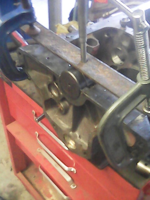

Anyway block stripped so I can replace the rear main. I am sacrificing to the gods my last asbestos rope seal. I was going to save it but now my hand is forced as these graphite seals don't cut it. After that I'll be looking at working a conversion to lip seal if the rope seal leaks again. Had enough of pulling engines down for oil leaks!

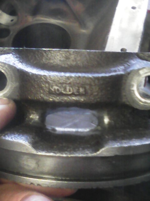

Smashing it back together now. Did some relief work on the oil drain hole in the rear main cap so it'll get a bit better drainage but not too much in that it exposes the rear seal to excess oil splash from the crankcase.
Set rear main seal (crank in and out 4 times to get it right).

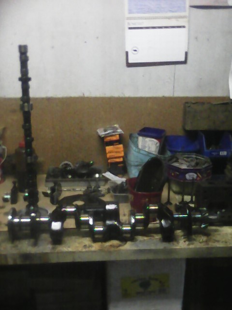

Crank and pistons in. Side note all bores measured up well. Wrote a letter to the mob who built the head, don't think I'll hear anything from them. Knock off.

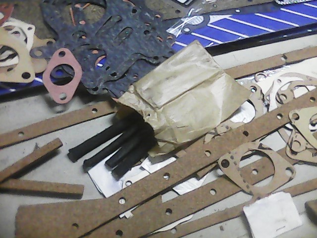

Digging through all of my old gaskets and found some original rear main seals in a brown paper bag. Todays bonus!

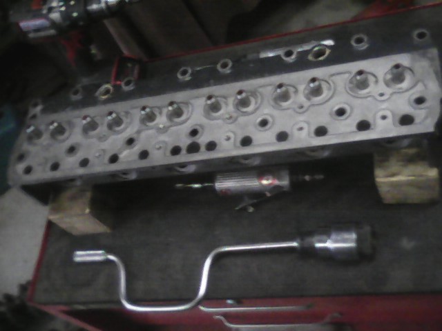

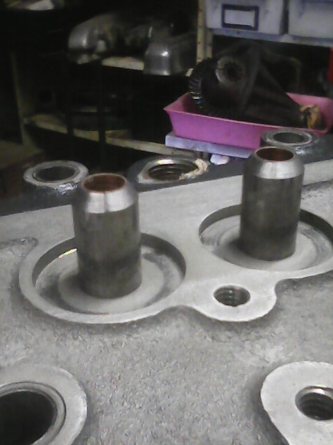

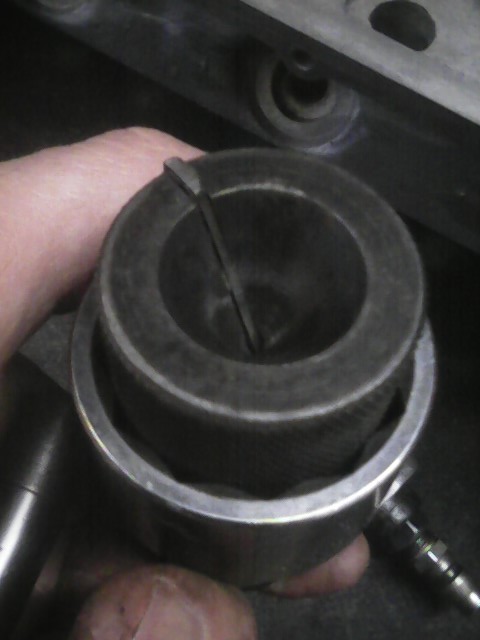

Ok a bit more today. Valve guides done but I've been scratching my head to find a way to chamfer the top edge of the valve guide. Chamfering mill tools are very expensive and no one seems to have heard of them out this way. Closest I can get is $124 for a deburring tool that might work. Some of the reviews were ordinary. So I ended up using a tube work deburring tool that is in my flaring kit. Pressed it into a large 3/4 drive socket and with a speed brace we're away. Got cocky and found a adapter for the cordless drill and managed to do all of them in 20 minutes. Lucky I think as the guides are cast iron. Not sure how the tool would go on anything harder. Next job to rework the coolant holes for the new revised head gasket.
Hoping to turn the key this weekend.
