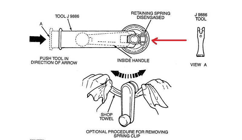

Have you installed the locking spring to the inside of the handle? Did you use a removal tool to remove the dodgy handles? The spring clips that hold the handle to the spline must be pushed all the way through for it to engage onto the spline. There is a spring behind the door trim that keeps tension on the handle so the locking spring stays in postion.

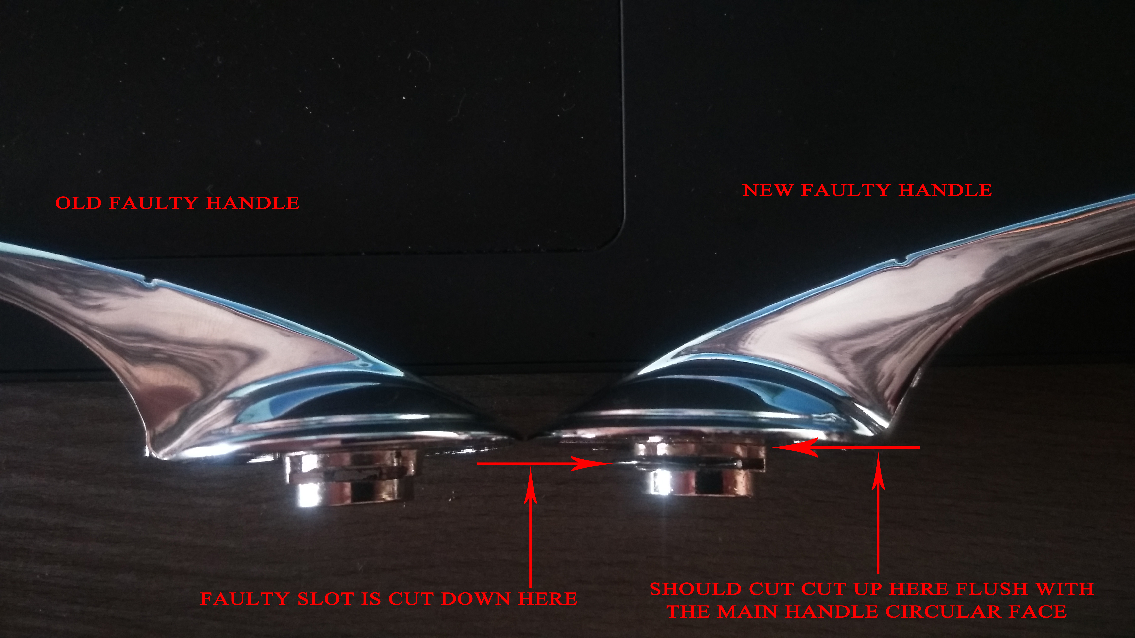

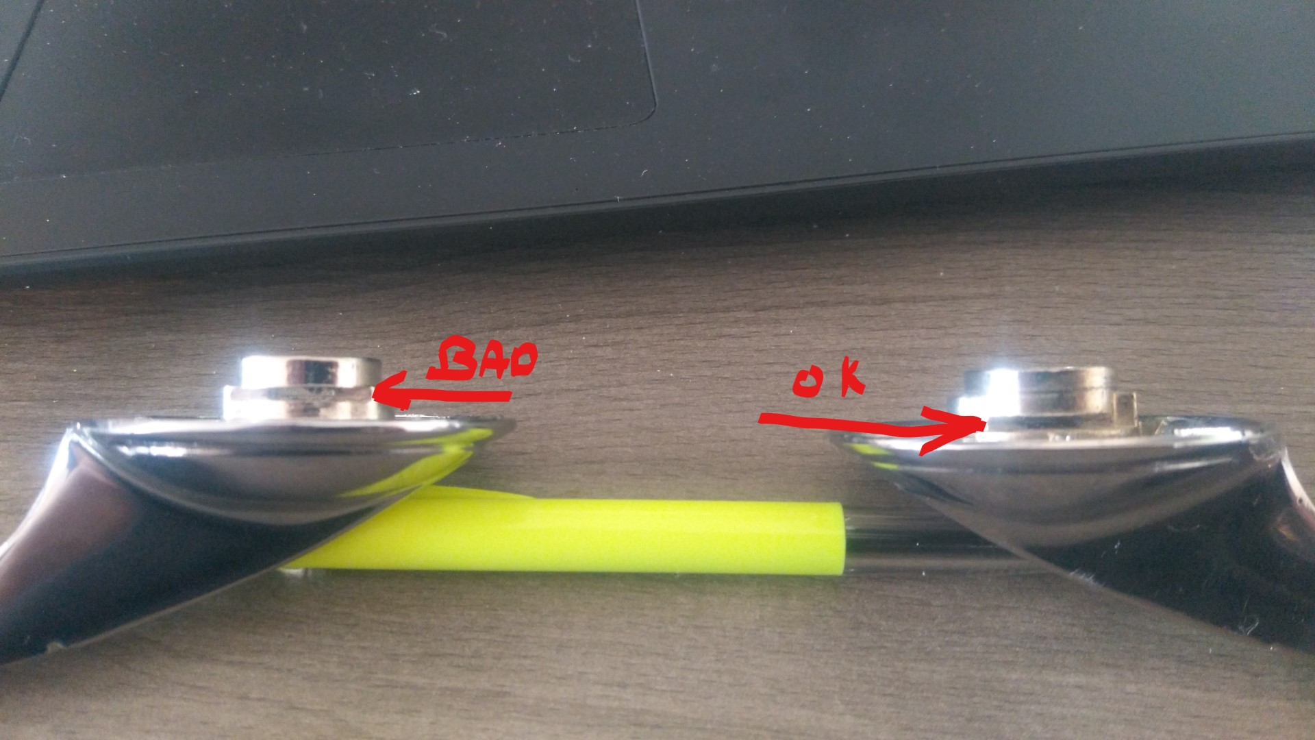

I found the problem. Its faulty parts from Rare Spares in NZ. Seems like even though you pay top dollar at Rares you dont always get top parts :OMGGG:
See attached image. The "Slots" for the clip which is a secondary operation after casting in China have been cut in the wrong place in some handles. I had a brand new in the box from the previous owner handle which was faulty. I explained the fault to Rares in CHCH and they checked their stock in-house. They had 5 in stock 3 were faulty 2 were OK :erm:
Also, one handle had the slot OK, but the internal "splines inside were to shallow, not allowing the handle to attach properly!
Would replace the new faulty one I had (I didnt purchase it) so I ordered 2x more.
When they arrived one was good, one was faulty.... :yeahhh:
They then posted me another which was also good. So I now have working rear interior door handles!
Pays to check the parts though aye!
