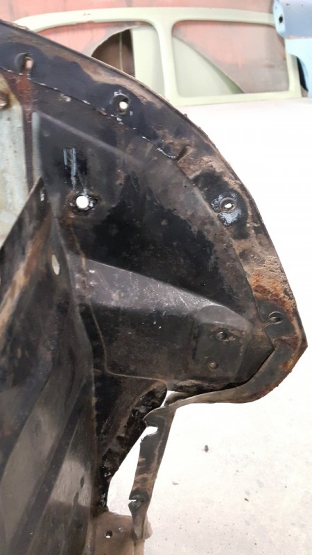

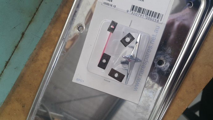

Spent some time doing some of the fiddly bits on the guards and bonnet, ready to throw them on. The guard slashes are driving me nuts though... the little clippy insert things really do not want to go into the guard, and I'm frightened of forcing them. Apparantly the guard slashes are left hand, and right hand too - it would be just my luck to put them on backwards. The difference is subtle, but I bet it would drive me nuts. Anyone got a photo of an original guard please so I can see which way the slashes "go"?

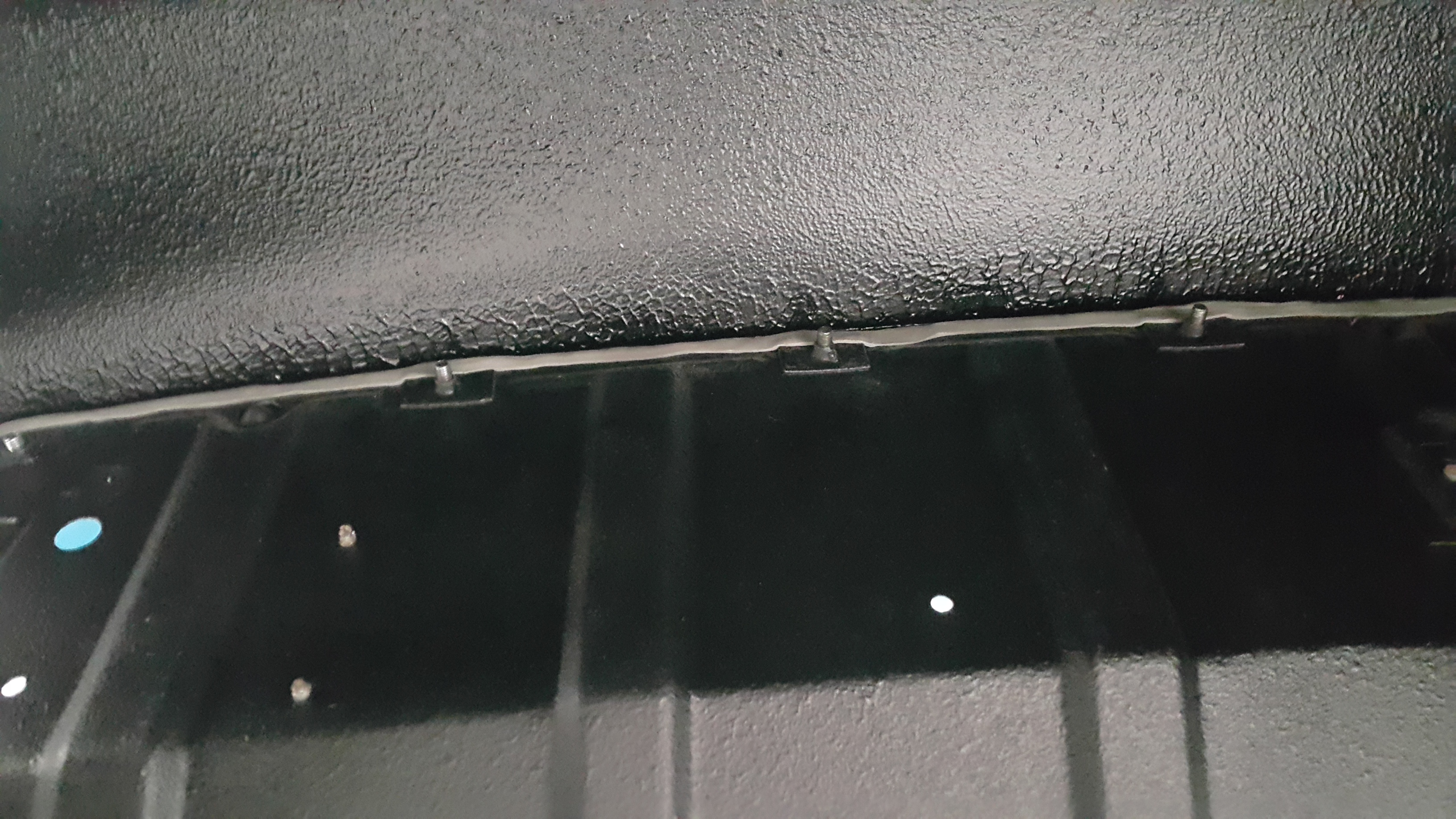

Made up a rubber gasket out of an old bike tube to sit between the guard and subframe. Should have been an easy job, and I even saved a bit of the old gasket to act as a guide.... do you think I can find the damn thing? Looks like it will be fiddly to get the gasket to "sit" whilst putting the guard on. Are most people making a gasket, or doing without them?

G'day Harv,
I can not help you with the "slashes" as mine has star's, although I purchased some new stars and they came with the little clippy inserts, but originally my my stars were held on by some spring metal clips, then there was a dollop of putty over the clip on the inside of the guard, please see photo,
the gasket between the sub frame and the guard, please find photo of the original, also photo of what I have went with, I have went with a Wurth product, it comes in a tape, about 1 inch wide, it comes in a roll and has a paper backing both sides, its soft and can be formed to any shape and does not go hard.
hope this helps regards
Thomo.
Thomo.

FC site has info on this too. Can't remember who used an extrusion from Clark rubber and punched holes in it. Appeared to work well.
Clay
Clay
Re: harvs ek 327 wagon
Thanks gents. The slashes originally had one "square tube" type clip (that inserts into the guard), and one "tiny bit of punched plate" on the back. I'm thinking I may end up running no clips (as the slashes are fairly tight) and just using some stickyflex. Just got to work out which way round they go.
I used stuff from Clark Rubber - it was almost an exact fit.
