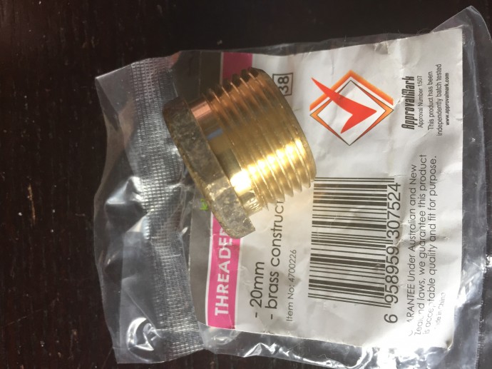

Went down to Bunnings and when I started asking about 1/2" NPT threads and non metric sizes they had no idea what I was talking about and told me that they didn't make them anymore
I did manage to find a 20mm but don't know if this will fit

Careful... there is no way that the grey motor threads are metric. You might be able to get it to jam in there, and hopefully the brass smooches to make a seal. Pretty dodgy though.
If you are unlucky, the brass plug has been work hardened or the grey motor threads are soft... and it strips the cylinder head threads.
