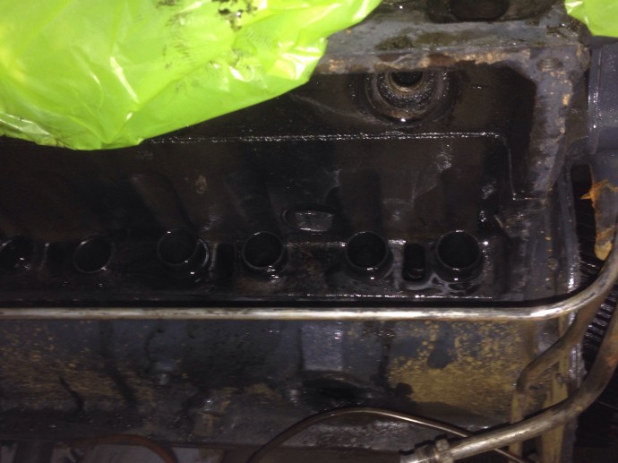

The second is removing the lifters, I can put my finger in the top and pull up but I can only get them to come up about 20mm then they get stuck. Any thoughts?

In the photo you can see how high I get the lifters before they get stuck.

Lifters might have a bit of buildup on them if the motor has done a lot of miles, can you not get ANY of them out ???

I can't get any out yet Blacky, they all come up a little then get stuck. It's been parked up for over 20 years and looks like there has been no major work done to the engine, can that be why there's a buildup on the lifters? How can I get the lifters out without damaging them so I can reuse them if they have build up on them? Can I clean off the build up???

Give them all a good squirt between the lifter and the block with inox or wd40 and leave overnight.

For the lifters as eveyone says it is just carbon build up on them ,... i used Carb cleaner and sprayed it on them to dissolve it , that worked best for me
