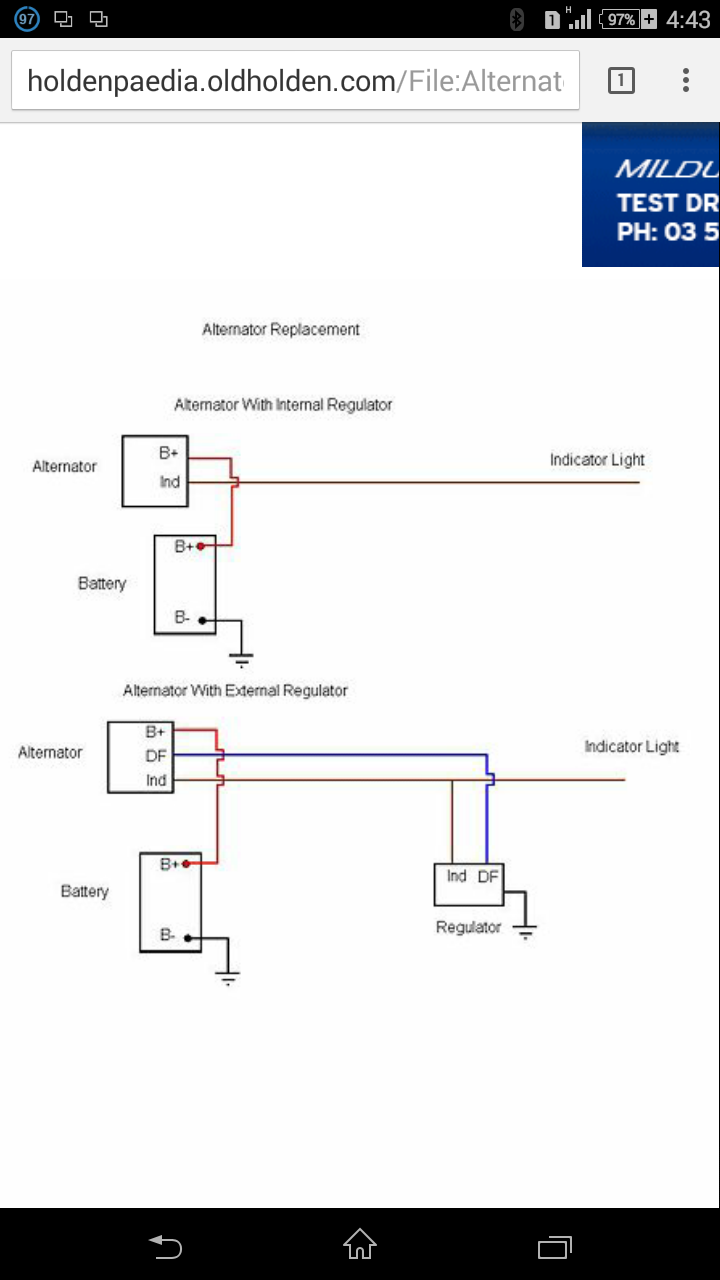

This for me is a great success when it comes to anything wiring related.
It took me a long time I've searching the internet for a how to the I can understand, this is why I'm posting this.
Just incase someone else would like to know.
It ended up being real easy.
Easy wiring diagram.
