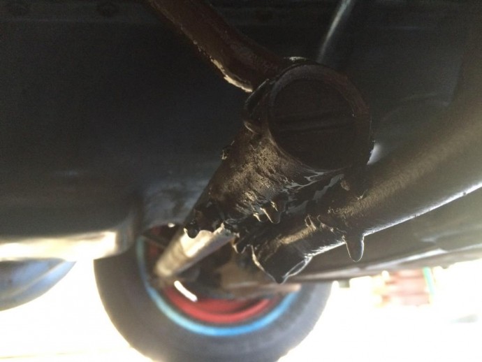

Also, there was a fairly good coating of oil/steering box grease which had leaked from where the pitman arm joins the shaft, which then dribbled down to coat the area where it joins the steering arm. When I first bought the car the steering was a bit stiff so I added SAE 90 oil to the the steering box as per shop manual. It freed it up but for the last year or so it has been constantly dribbling out. I figured by the time I was ready to register it most of the oil had dribbled out so I replaced it with Penrite steering box grease. I assume what I see coating the steering arm is a mixture of the brown colored steering box grease and SAE 90 oil.
Can anyone tell me if there is a seal in the bottom where the pitman arm joins that can easily be replaced (and how), or should I accept it as is and keep an eye on the grease level in the steering box?

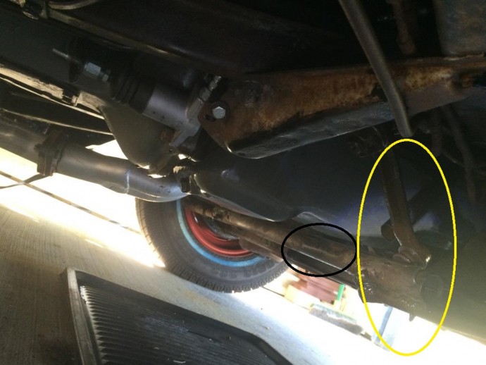

Photo shows oil stain on steering arm from engine breather pipe (black circle) and oil/grease stain from steering box (yellow circle), and the amount of grease/oil drips. This area was pretty much completely covered. Other photo of course shows the finished product. Another FB brought back from the grave! Hopefully many years of enjoyment ahead.

I replaced the seal in the bottom of my stering box - just removed the pitman arm , dug it out with a seal pick , went to the local bearing supplier and bought a new one and fitted it no problem. No need to remove the steering box from the car .

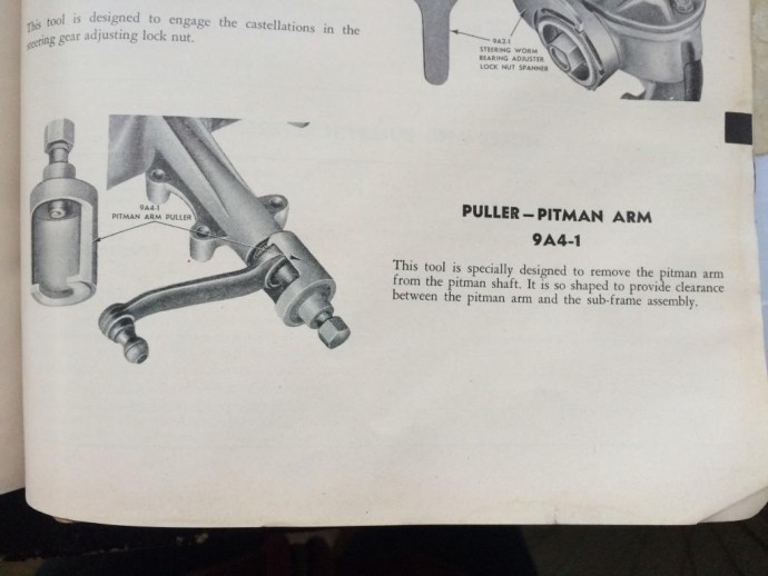

Would the seal you replaced be the one numbered 20 in the exploded view diagram from my shop manual? If so, did you need the shown tool to remove the pitman arm to get to it, and would you then need to do a wheel alignment again?

Hi Matt,
I have the original steering box in my old bus - like you, about 30 years back, I put some SAE 90 in at one stage - and it leaked almost straight away.
I chased up that Penrite grease and took the steering box cover off.. scraped, dug, scooped out all the muck and oil I could and then filled it up with grease and finished off the fill to the suggested level with the cover back on.
Same deal - grease started coming out from the pitman arm. I didn't know there was a seal around the shaft then - but when I found out about it - GMH service department told me that I'd have to replace it. I used a common garden variety puller to remove the arm - dug out the old seal (shot) like Blacky posted and pushed in the new one..
As I recall - the shaft and arm are splined - I can't remember if it was the original arm or the current one (HD/HR) which was "quadrant keyed" - will only go back on in one of the 90 degree quadrants..
If you have concerns - mark the end of the shaft and the body... with the steering wheel set at exactly 12 O'clock...
Don't stress - if it is possible to be a tooth out - you can simply move the steering wheel around to match.. but I doubt that this will happen - there'll be a noticeable difference in steering wheel/road wheel alignment if you are one tooth or more out .. and again, if it is possible to just be out by that much...
Take a good look at the shaft when you pull out the seal - check that it has not got any burrs or marks in it where the seal face runs....
I fully expect that it's just the seal which has cracked, split or "aged"...
As for the oil breather - yep.. my recollection of when I had the grey motors .. they both blew out condensate.. with whisp of oil added in.
If you are concerned - you can remove the breather pipe and give it a good clean out.
The breather uses the draught of of airflow under the car to draw out these fumes.. along with the open faced intake which gets some positive pressure from the radiator fan...
That long trip you did up into the hinterland probably got the oil hot enough to evaporate any condensate in it... you didn't mention when you last did an oil change - so, I'm just expecting that the oil was not fresh....
Greys are quite happy to have wafts coming out of both these areas - the top one particularly when stopping the motor.. it's just fumes.. and nothing to be concerned with... but, if it was "belching" out blue smoke - well, we might have need to go looking for cause....

Yes , that is the seal I replaced - your pitman arm should come off fairly easily if you have just finished a rebuild ? I cant remember how I took mine off , probably with a standard two leg puller I would assume as thats all I have at home and cant recall it being a problem. There would be no need for a wheel alignment as you arent going to adjust any toe in/out doing what you are doing.Megamatt wrote:Hi Blacky,

I just dug mine out with an oil seal pick - cant remember how I put it back in but a pin punch would probably do the job , or use a piece of pipe ?
Re: help with oil leaks on recoditioned engine and steering
From memory, I think I dug mine out using a sacrificed bent small screwdriver.
Like Blacky, I used a pipe to push the replacement it - think it was a piece of copper pipe..... way, way long time back... no entry in my logbook that I could find either... way before I got serious about detailed entries.
