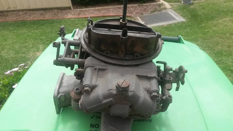

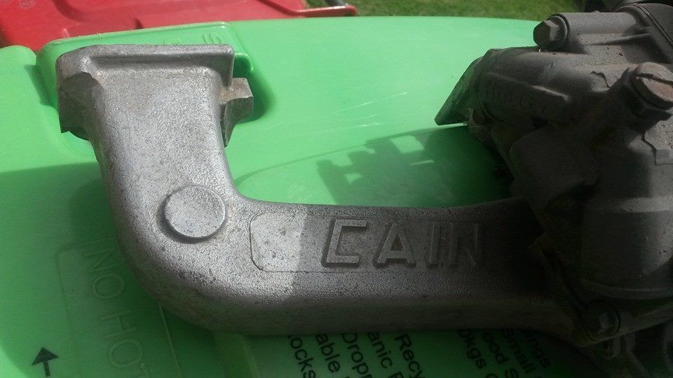

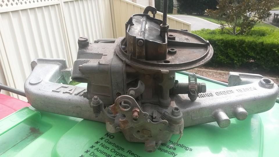

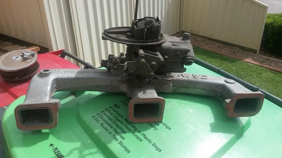

Can someone tell me what I'm looking at here?
Was told it came off a Grey from a FE?
Cain Manifold with a 2 Barrel Carb... :egeek:

Red motor

350 holley

Question, my mate wants to know can it be used on a Grey is there a adapter?
fb delivery
Posts: 1702
Location: Toowoomba
Re: What do I have here?
Post by fb delivery »
i would'nt i would use a ww2 or a weber from XE falcoon

SunnyTim wrote:you would be better using a spaghetti strainer to feed fuel to the engine than a 350 Holley on a grey.
Ha ha FunnyTims on a roll.... :lol:

Wayne,
FB delivery is correct, it's a red motor manifold. The easy giveaway is that the red motor manifolds are normally rectangular port, and the grey motors are round port.
The carb may well be a 350 (or similar sized) two-barrel Holley. Take a look on the air-horn, and their should be a List Number stamped into it. The 350 Holleys have the following List Numbers:
R3660
R4055-1
R4056-1
R4144-1
R4670
R4791
R4792
R7448
R80120
R80320-1
R80787-1
R82010
R87448
If the List number is anything other than one of these, give me a yell and I'll hunt down what the carb is.
You can adapt the two-barrel to the grey, but the adaptors are ugly and do not distribut fuel well. The carb is hugely oversized on a grey for anything but land-speed record attempts :D .
