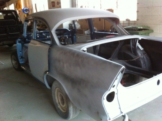

Hi,
I've go some butyl mastic ready to seal up the newly chromed tail lights, but I can't work out whether or not to run a bead along the very bottom lip. Does anyone have any thoughts on whether to just seal the sides? The way I figure it, if water gets in through the dust seal holes it might escape between the bottom of the tail light assembly and the lower lip. But then I worried about stuff flicking up from the road, and maybe I need to seal the lower part to stop that getting in?

way over thinking it. if you have to: bead all the way around and in between the taillight and indicator housings.

Run the bead all the way around.
Get the stuff everywhere… your hands, the driveway, all over the caulking gun, and at least one painted surface.
Use some kero on a rag to clean it up, and smooth the bits that ooze out of the joint as you tighten the taillights.
Run out of rags, and curse the mastic.
Least, that’s what I do 🤪

Factory used a latex gasket originally that sealed around the entire edge.
