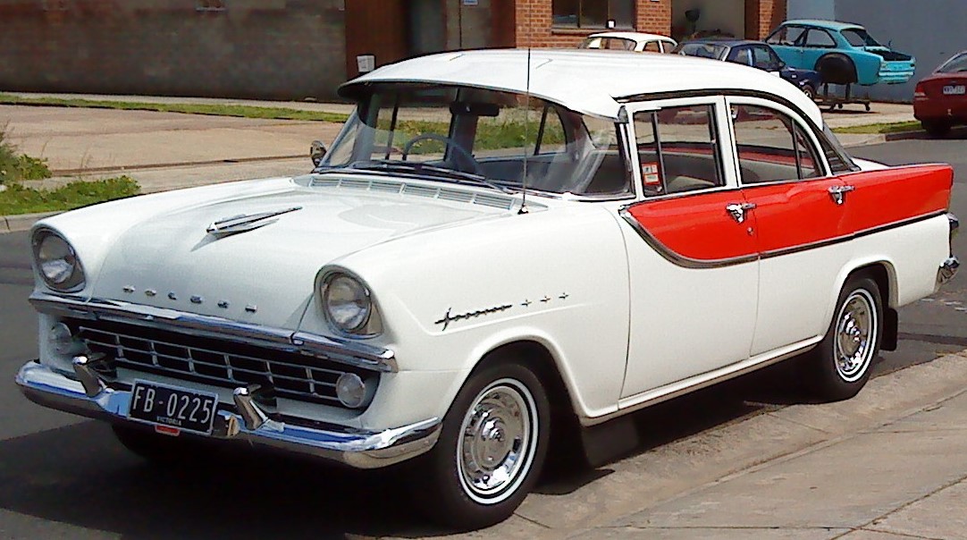

Todays little update.
Got some colour matched paint to do the kickboards. Pretty happy with the results.
Todays milestone was giving the car its first wash. The car has turned out pretty well water tight with only a couple od spots letting a few drops in. Just need to sneak up the door strikers a bit.
Insurance done.
Exhaust for Jack Meyers Headers gets done next week.
Tomorrow wheel alignment is booked in.
Monday final touch ups cut/polish and prep for the wedding.
Looks like I'll have a couple of days spare!!!.......maybe
Time to kick back now the bulk of its done!
WayneXG95
Posts: 2565
Post by WayneXG95 »
Looks great... :thumbsup:
WayneXG95
Posts: 2565
Post by WayneXG95 »
steved57
Posts: 239
Location: Cairns, Qld
Post by steved57 »
Me x 2 too!
Craig Allardyce
Posts: 1525
Location: Stratford
Post by Craig Allardyce »
Thanks guys for the comments.
Its very close now and I'm pretty well spent. Its been 12 months since we decided to use it for the wedding and its been a real demanding job. My hat goes off to those that can do it in less time.
Special thanks goes to those that have supported me on the forum and especially to Russell and Wayne that helped me out with trim at the last minute (still waiting for the new trim from the states). The big tick goes to my wife to be that has put up with it all, fed me in the shed, driven everywhere chasing parts, and worked on the car side by side all the way. I love her to bits. Hope she's up for the EK ute next :lol:
We still have other work to go for the nationals but it should be nice and easy now with 6 months to fit that work in.
Anyway I spent an all nighter till 1am making the rest of my exhaust and fitting it. The exhaust place that I had booked to get the system made up for the headers couldn't fit me in on the day when I turned up. Don't know why I booked it in... :wtf: So I'm still running the standard system till later. Another minor tune and brake adjustment done also. Todays mileage check comes up at 26mpg. I'm running a 58 main jet a the moment as the engine is breathing a little better mid range with the ported head. Cam is real nice, still good torque down low, good pull mid range, smooth idle, and no tappet noise! Definitely looking forward to the weber going on and the headers. I hoping with final jetting on the weber I might get close to 30mpg as the current Stromberg is a bit rich on the progression circuit with the larger main jet.
Anyway we look to have made the wedding deadline with 2 days spare. Just have to fit the ribbon tomorrow and we're all good for Friday. :thumbsup:
We will post some good photo's of the cars on the day next week.
Cheers everyone. :thumbsup: :thumbsup:
