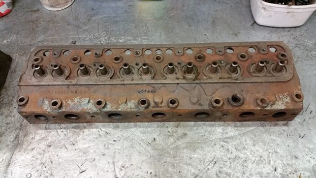

What is the best casting to start with when modifying a Grey motor head?
I have a few here and I hot tanked a std, un machined head today with intentions of porting it, fitting red motor valves, duel springs etc.
I know the early ones had the GMH logo on them, later heads had Holden, EJ heads have a 2nd water outlet etc but id there a definite "must have" head to use?
Also, has anyone got any photos of a sectioned grey head to show water jackets and port wall thickness? If I have too I will section a grey head but I am sure someone out there has done it in the past?
DW.
Grey head.jpg (48.75 KiB) Viewed 1593 times

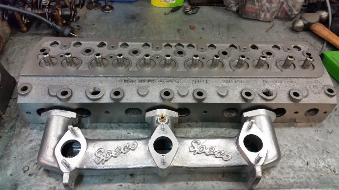

850man
Posts: 19
Joined: Sun Aug 10, 2014 8:42 pm
Location: Melbourne, Australia.
Re: Best Grey motor head to use?
Post by 850man »
I picked up my EJ head and Speco manifold from Hydroblast today, they look like new now.
