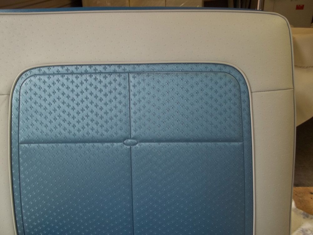

Was over that the trimmer today and he had my front seat almost finished.
I asked him about prices for the material and he indicated it was
around $60 a metre for the plain blue, $90 a metre for the blue patterned insert
and I forget about the star white heavy weight, sorry.
Other people seem to have a problem with the time in getting the product landed, mine took about 3 months
from SMS Interiors in the states but my trimmer now has a contact he works with
and has no problems.
My trimmer is
Daniel Misfsud
A Stich In Time in Sydney
Mobile 0416 119 224
If you want to contact him. I can't help other than that.
It's up to you if you want to contact SMS direct but as you can see the products perfect!
:D

WayneXG95 wrote:Was over that the trimmer today and he had my front seat almost finished.
My trimmer is
Daniel Misfsud
Mobile 0416 119 224
:D
I'm real happy for you Wayne, you must be wrapped with your trim.
I feeling a bit disappointed with the whole affair regarding my trim as I'm dealing with the same mob.
I thought what the hell when it started, I'll go the guinea pig and see if I can get these trims reproduced so everyone can benefit. I don't mind saying it hurt to cut up samples and send originals overseas in the hope that they don't disappear into the black ether.
Well its been over a year for me now, I placed my order on the 1st of May 2013! and I'm still waiting. My headlining came reasonably quick but that was the end of it. I only got my red fleck just before the nationals, but too late for my wedding last year. I was so lucky that Rusty helped out with some seats/trim from a donor car. I'm still waiting for my seat bolsters (they cocked them up first time around) and as of last month they had forgotten all about my door trims. I was even queried on what the pattern should be for the door trims when they have my original samples!
I don't know what it is, maybe I'm a prick to deal with, or they only deal with companies direct, or Wayne has just been dead set lucky, but please people, do your research on this mob. They have a facebook page that reveals some pretty bad comments about them. SMS has also been referred to the Better Business Bureau (USA consumer affairs) for various issues. One thing they are really good at is charging your credit card! Don't get me wrong, the head lining I got back was perfect, the red fleck looks to be spot on, but all that's no good without the rest and its taking a long time, which they don't elude to on their website.
This is one reason why I did not want to refer them to anyone until I was done with my trim and I knew what the outcome was. If I had my time again I would not use them.
Sorry Wayne, I didn't mean to steal you thread but I thought I better warn others of what might happen to them.
