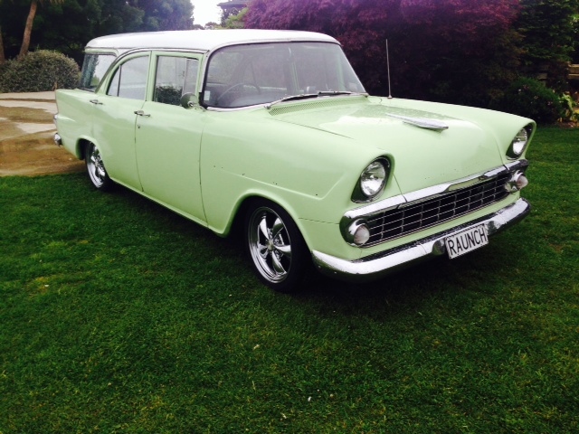

He guys and girls would like so help on the best way to insall a sun visor, any help regards screws etc would be great help, even some close up photos of a fitted visor would be handy.
cheers jono

Ripper looking wagon there Jono
Sorry no advise on visors, but will be looking at answers for my own reference.

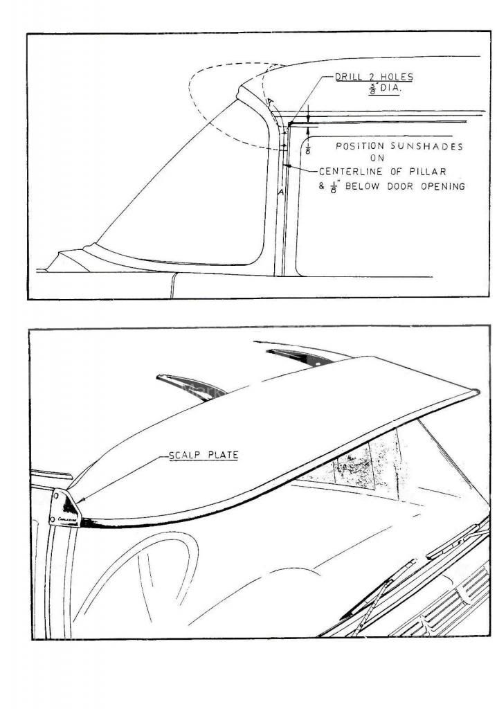

This may help:
Notice that whilst the actual visor is common to all body types, the brackets are unique for sedan, wagon, ute and van. Getting the right brackets is the largest source of angst.
Harv.
Harv.

cheers for that great help, yes nice wagon brought about a month ago.
history was brought in aus about 8 years ago by perivous owner he spent alot of time and money on a full rebuild on drive gear did a respary etc,
brought over to nz to find it needed alot of work and money to get a cert.
so now its my turn to finish the old girl off, got new carpets going in next week also trim going on outside in next couple weeks.
next yera i plan to do a re fit on the seats and doors once i save some coin.
cheers jono
cheers jono

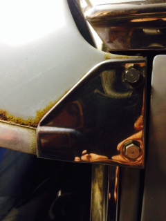

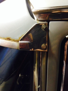

I hope I might be able to offer some help? The brackets on my ute were rather dodgy so I made a pair of outer brackets (scalp brackets) from 0.8mm aluminium. See http://www.fbekholden.com/forum/viewtop ... 11&t=17288 of what the end result was.
I have also included some photos from my father's FB sedan. As we have had the car since Dec 1962 we know the brackets (stainless steel 0.5 mm) are original and not been messed with.
- Visor bracket 2.jpeg (30.39 KiB) Viewed 1733 times

Re: Installing a sun visor
The other photo
- Visor bracket.jpeg (30.36 KiB) Viewed 1731 times
