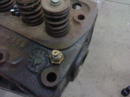

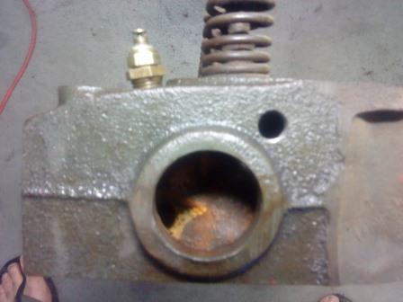

Stewart I had a look at this again this arvo and drilled and taped an old head I had lying around. It took all of 15 mins to do and you could do it with the head fitted. I've showed the spot were the sender can be fitted at the rear of the head but you have to be careful with spacing between the sender, the firewall seam, and the throttle bar. The other option is next to the rear head bolt on the left hand side. There is plenty of meat in the head to tap a hole and heaps of gap inside the coolant jacket around the port and combustion chamber. I drilled and taped to 1/4 NPT and used a adapter to fit a VDO sender (1/8 NPT). Looking at a EK you might have to remove the wiper motor to make room to drill the hole. Alternatively you could drill a smaller hole next to the original sender spot as there is good room there for a 1/8 NPT fitting. I would also use a suitable amount of grease or similar on the drill to catch the swarf and do a flush of the cooling systems afterwards. Hope this helps.

Craig - many thanks for taking the time to do a 'test run' and posting the pics up.
