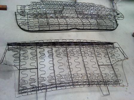

A little progress today, finally finished the seats in preparation for the re-trimming.
I have to say it was a bastard of a job and took well longer than I thought but worth it. I'm now wondering if anyone has had a seat foam packed in around the spring work. I'm thinking this may help a lot with support in the seat and prevent further spring breakages.
I think my trimmer packs foam around the springs. I'll be seeing him next week and ask for you.
stinky
Posts: 906
Post by stinky »
Craig Allardyce wrote:I'm now wondering if anyone has had a seat foam packed in around the spring work. I'm thinking this may help a lot with support in the seat and prevent further spring breakages.
Springs will always break and warp out of shape, the best thing I have seen for these style seats is to have 2 or 3 zig-zag tie wires going across the seat. Not sure if this is a factory thing or not because I have only seen it once or twice, you just need some of the zig-zag wire that is used in the seat covers and then hog-ring them to the base springs to spread the load.

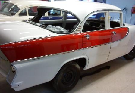

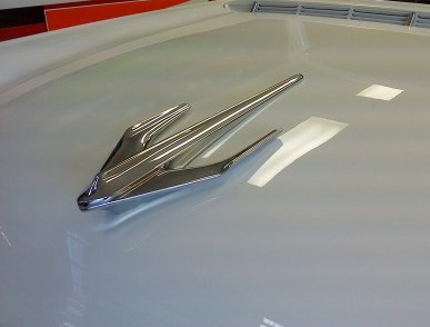

A little progress this week. Have managed to fit up all the stainless bling bar one piece that I'm still chasing. If anyone could help out with one it would be a bonus. http://www.fbekholden.com/forum/viewtop ... =4&t=18672
At the moment I'm still waiting for the headlining as its holding things up as I want to get the windscreens in. Next job is to clean up the inside of the roof and paint and line with some dynamat. After that will be the fun job with door seals and door strikers.

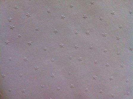

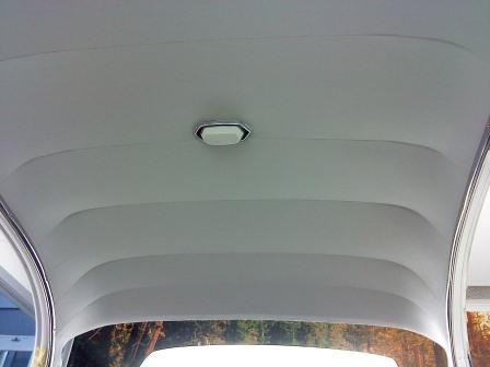

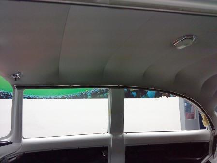

Well I've finally received my headlining back from the states.
I'm still at work but have been sent some pics from home and by all accounts its a spot on match! The star pattern is hard to pick in the pictures but it matches up to the material on the old sunvisors. The off grey color is also a good match.
Busting to get home to have a look. Cant wait for the rest of the trim now!!!
I'll post some pics of the headlining as soon as its fitted. Stay tuned! :thumbsup:

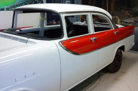

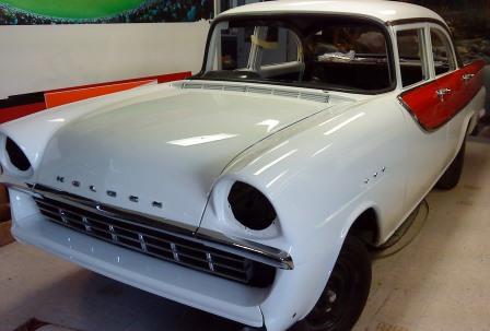

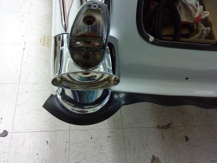

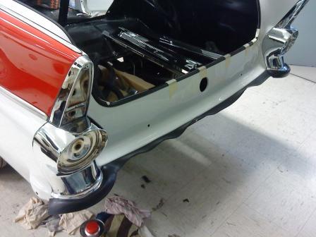

Some serious movement this week with the headlining going in finally! Have to say I am wrapped with it. I'm seriously looking forward to the rest of the trim turning up soon.

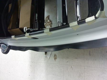

Also fitted the taillight housings........what a messy job sealing them with Butyl Mastic. Took ages to clean up excess but it did turn out ok. Also fitted up the bumper dust seal and just have a bit more work to do on that with forming it with the heat gun.
