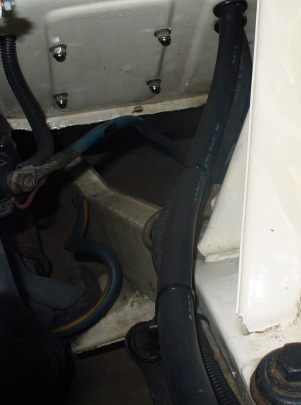

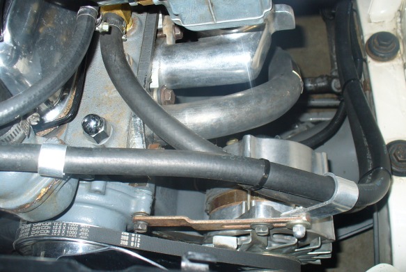

Stewart I know what you mean I didn't want heater hoses draped over my motor eitherparisian62 wrote:Thanks for that info and advice guys. After posting up the thread I did some googling and further reading and realised they're not much chop.
Looks like we will be packing extra ugg boots, tracky dackies and jumpers...or is there a heat wave forecast for Wangaratta in June...?
Thanks Tim.I've got a poor man's heater here...am trying to keep the engine bay clear of the rubber hoses.
But as a heater is almost compulsory here in winter I didn't have much choice (I hate driving with so many jumpers/jackets on that I look like the Michelin Man
From there they follow the subframe rails back to the firewall then through the firewall to my Smiths / Suzuki heater mounted under the gloveox (Smiths bullet heater that leaked so I used a core from a Suzuki Stockman heater / perfect fit
- H1.jpg (76.85 KiB) Viewed 1265 times
- H2.jpg (74.23 KiB) Viewed 1265 times
- H3.jpg (25.05 KiB) Viewed 1265 times
- H4.jpg (55.56 KiB) Viewed 1265 times

Many thanks Mick and for posting up those pics too.
