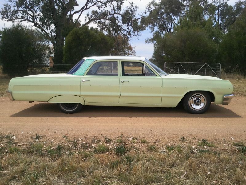

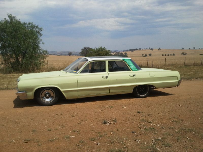

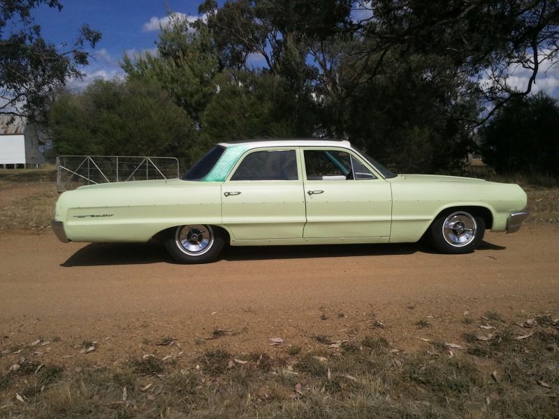

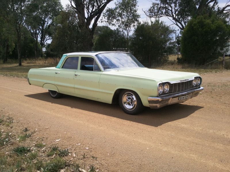

Posts: 4366
Re: what you buy when FB/EKs become to expensive
here's the lowered pics could come down a little more in the rear but as i said the springs fall out allready when jacked up

You can always run a piece of chain from the body to the diff somewhere to stop it from spitting out the springs when at full drop, Mick. :thumbsup:
I did this to a lowered arsed bike id built in the 80's...it worked well. :wink:
Scotty.
Woofto Car Club Member No 2
Posts: 4366
Sputzwagon wrote:You can always run a piece of chain from the body to the diff somewhere to stop it from spitting out the springs when at full drop, Mick. :thumbsup:
Scotty.
:thumbsup: that was my thought, from memory years ago with another i had i got shorter shocks, it's only real an issue if it goes on a hoist
gotta use 2 jacks to jack it up one under the diff to get the wheel off the ground and another under the body to raise it for clearance and just watch that the spring still has weight on it, but i need 2 for the front aswell one to get it up a little to get the other under :lol: gotta love low cars :lol: :lol:
