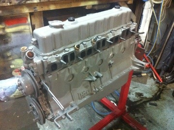

Anyhow, bought myself a re built 186 sans head. bought a gasket kit on the way home last night and burnt some midnight oil. Here's the result so far:

Good to see the grey is going back in

I'm with you, Richard - I pulled my "red" motor out and put a "grey" one back in....

Brett, I suppose without paint - they would all be that colour under the rust..... perhaps with a few "silver" bits...

I've had grey - grey, red grey, red red and now grey red in mine, Brett....
