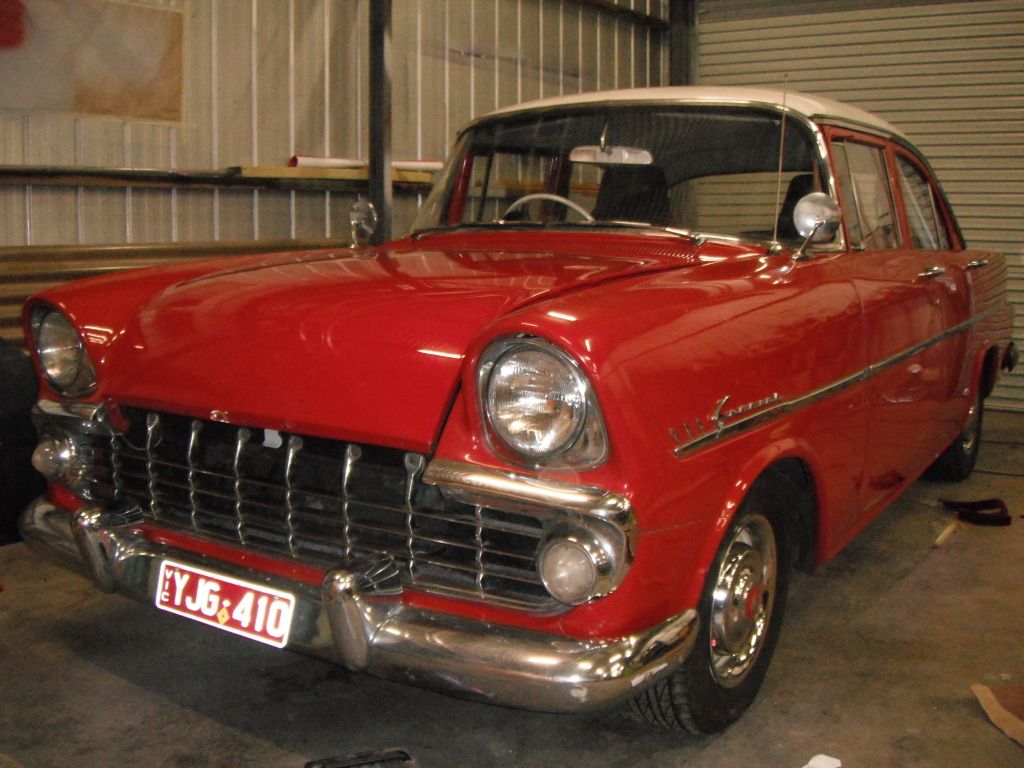

Used 2 pack Cobra was 15 degrees on the weekend so used my worklights to heat the panel.Used 30% thinners and heated the paint in hot water while still in the can.

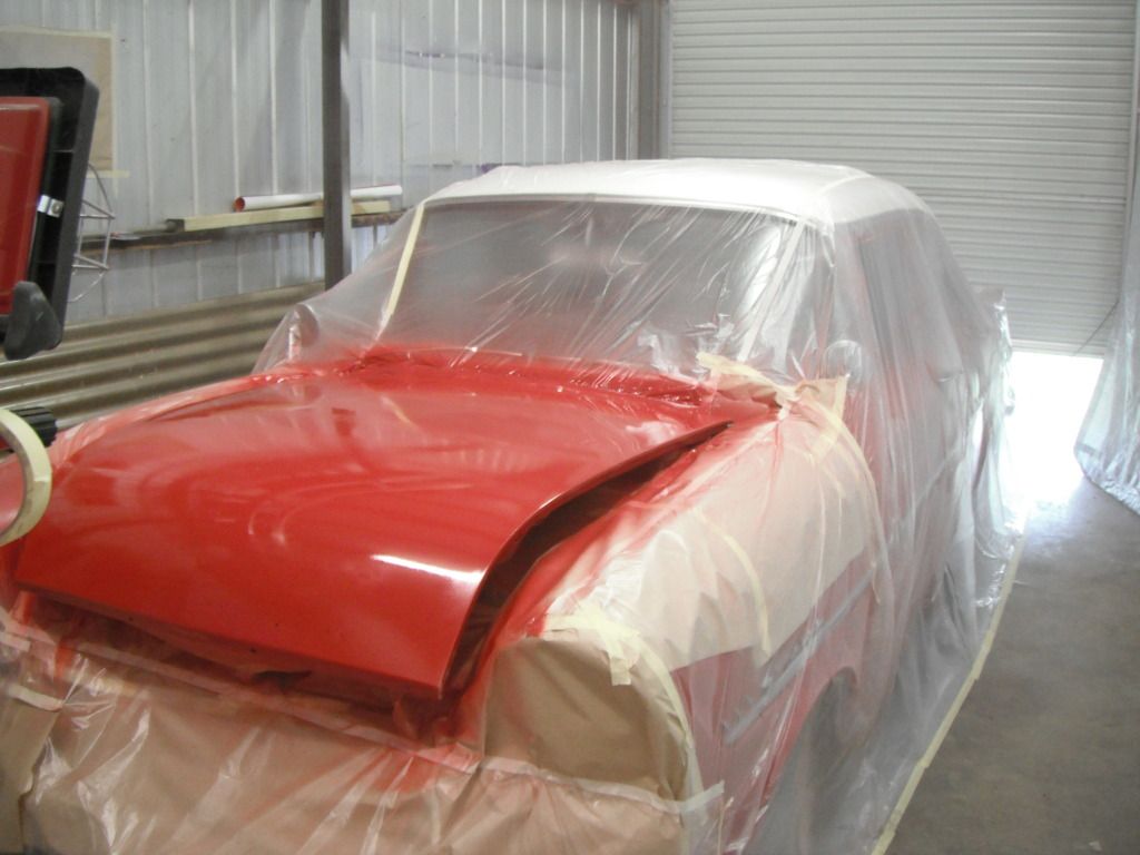

Base coat.Apache Red 2 good coats
Clear coat 1 tack coat and 2 wet coats.
Looks pretty good but I got a run on the front of the bonnet as the compressor kicked in just as i went from horizontal to vertical.Argghh!

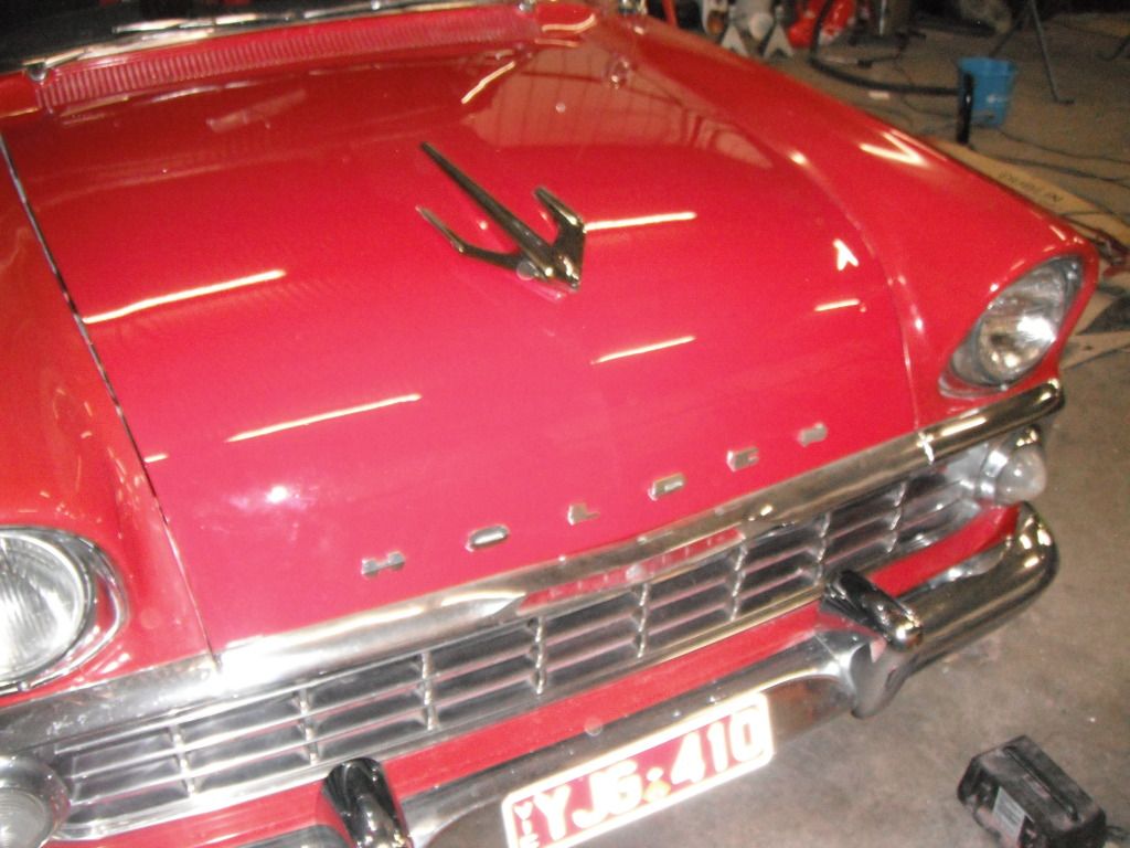

Left it until late Sunday then used 2000 wet and dry to sand it back then unmasked it and left it till Monday night
sanded it some more then used rubbing compound by hand then some glaze compound by hand.The paint was still too new to put a buffer on but I had to get rid of the run.
Cleaned and polished the jewellery while it was off the car
Put the bonnet letters on last night.Had to use speed nuts as some of the original clips pushed out the back and wouldn't hold.Couldn't find the same pin clips anywhere and rare spares were useless.Also fitted the "Bird" with the help of my lovely wife.I tried making a rubber base so it wouldn't dig into the paint but it was a pain so just bolted it straight on after careful manipulation to get the pins in the holes.Did all this without damaging the paint.
Gave the car a Meguiars quick wax and polished all the stainless and chrome and went to bed.
