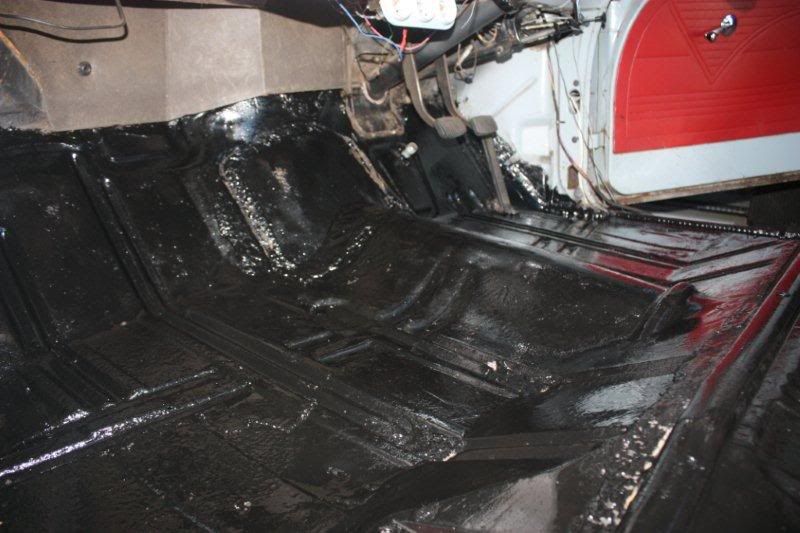

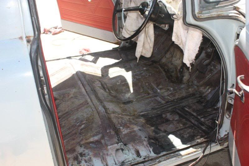

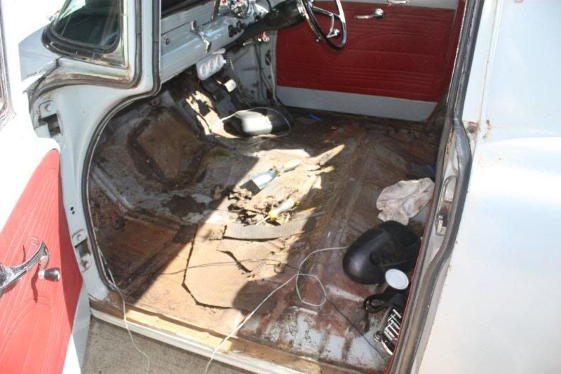

Decided to give the ute floor a bit of a birthday yesterday, got some new carpet and some “Resomat”

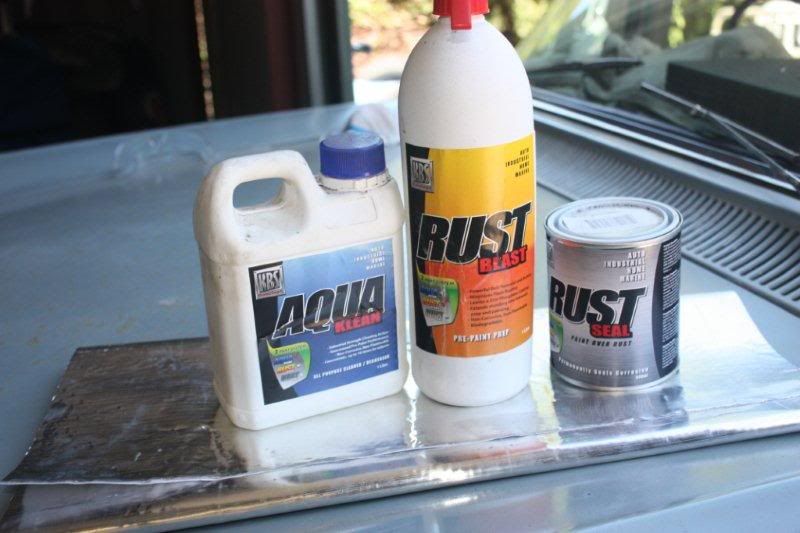

Will give it the KBS treatment rust blast & rustcoat, needed a break from welding on the wagon anyway.
The floor is in really good nick, a few minor spots & that's it.

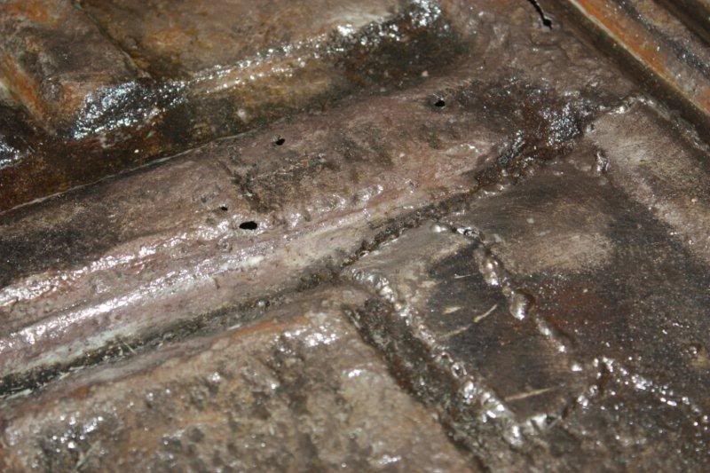

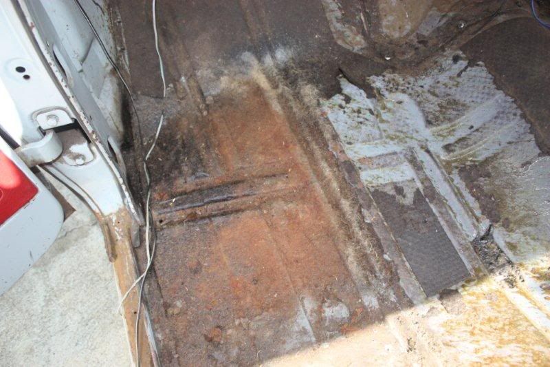

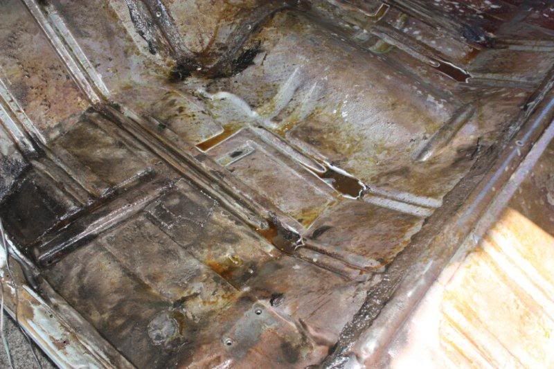

Wire buff found a few small holes, nothing to major, will replace floor pans next year, for now it fix & drive. :thumbsup:
KBS System works very well & simple to use. Needs good ventilation

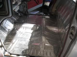

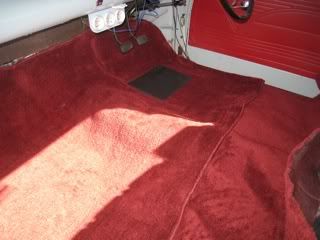

Reso Matt in today, seats back in tomorrow morning, Paint the new kick panels then off for a cruise. 8) Its much eaier to install when cut into small sections. Should have looked at the picture on the box :roll:
Pub lunch in order, I think, will be interesting to see what difference the Reso matt makes? If any. :)

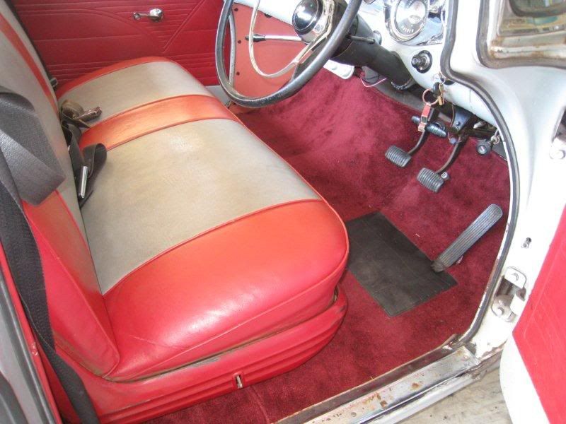

Ute back on the road, new carpet & kick panels :D
Resomat made a big difference to the road noise :thumbsup:

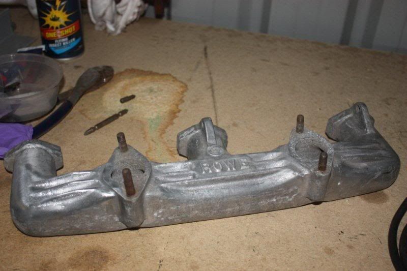

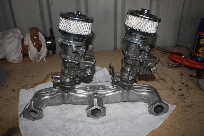

Sending one on the many spare Grey Motor heads to the local machinists for a freshen up. :)
V6 valves porting ect.
A Wade 446 cam & twin Stromberg's unless I can fine some triples.
Gave the Twin manifold a clean up this arvo just need to drop the cabs of for an acid clean to remove the paint ( bloody EBay) and the a kit through both. :thumbsup:
Fleck coat the tray internals screw the timber in and the ute is done. :thumbsup:

WesternWagon wrote:Sending one on the many spare Grey Motor heads to the local machinists for a freshen up. :)
Gazza
Might struggle a bit with that intake, by the angle of the carbs it looks like it's a marine one ( engine tilted a lot more than in a car ) Just my 2c
