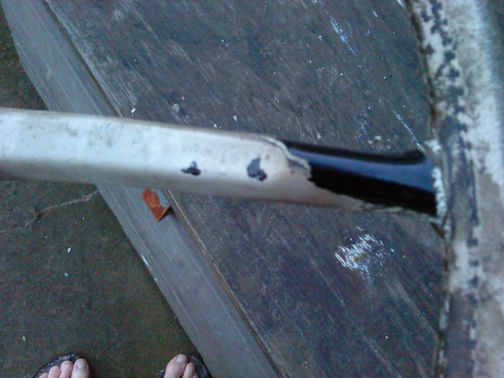

I'm also curious to know if any FB Specials were ever optioned with white steering wheels. By all accounts from previous owners mine has always been stock but the wheel appears to be a black one painted over. I couldn't see a reason why someone would just paint the wheel and do nothing else to the rest of the car. The car does have other options such as Warmaride heater, handbrake warning light, boot light, Holden Deluxe Radio, "H" emblems on hubcaps, etc. Was maybe thinking the white wheel was an option too??
White Steering wheel
Wear mark on wheel showing original material
Cheers :esmile:

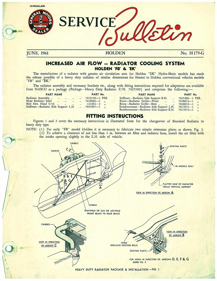

Also noted in the add the possiblilty that it may be fitted with the heavy duty radiator option although no cross bars appear to be fitted in front of the radiator.
Re: Trim styles FB-EK
Crossbraces on radiators are for hydramatics? Not sure...

Post by Craig Allardyce »
Yep your right, but there was a heavy duty radiator option for the FB & EK manuals after the release of the Hydro in the EK. It also included the cross braces. They are a pretty rare sight in an FB by all accounts. :egeek:
:thumbsup:
