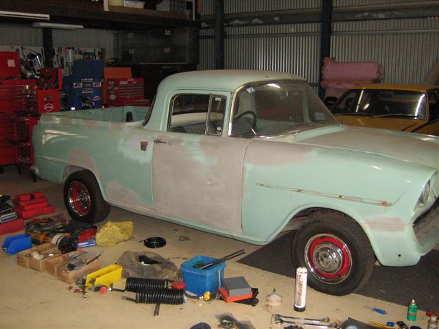

I purchased this out of Perth back in January 2011. I had my older brother check it out and he was impressed, “the ute looks as good as I have seen in a long time “.
He send a bunch of photos and I sent the money.
Restoration had started as you can see.

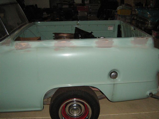

EK UTE PHOTOS 004.jpg (61.56 KiB) Viewed 25687 times
EK UTE PHOTOS 005.jpg (76.99 KiB) Viewed 25687 times
EK UTE PHOTOS 008.jpg (59.49 KiB) Viewed 25687 times

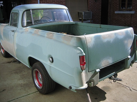

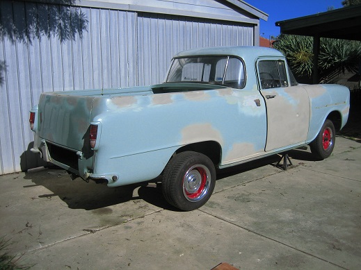

A couple of weeks later it arrived and I actually drove it off the road and into the carport.
Ute in SA 1.JPG (86.19 KiB) Viewed 25687 times
Ute is SA 2.JPG (80.61 KiB) Viewed 25687 times

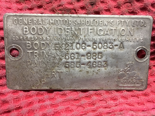

Body number;
Body #.jpg (43.86 KiB) Viewed 25687 times
Although in pieces it looked OK and it would not take much to get it together and registered.
Boy was I wrong as I’m sure a number of others have now found out.

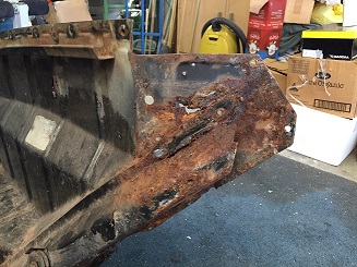

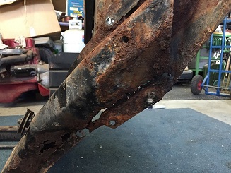

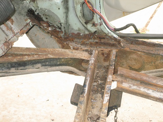

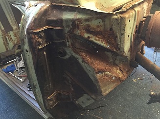

Pulled the front clip off and found more.
Front rust 1.JPG (47.77 KiB) Viewed 25621 times
Front rust 2.JPG (49.62 KiB) Viewed 25621 times
Front rust 3.JPG (54.07 KiB) Viewed 25621 times
By now I’m a little concerned with the quality of any previously repaired sections and my " quick " turnaround look out of the window.
As we have all seen, it looks good when it is filled with bog and painted.
The guys who owned this ute had several other cars in this workshop. HR van with V8, EH premier and a LX SLR 5000 Torana so my brother tells me.
I have started now so the only way in forward.

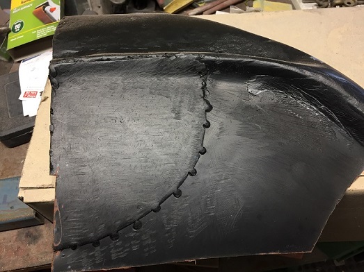

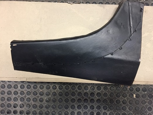

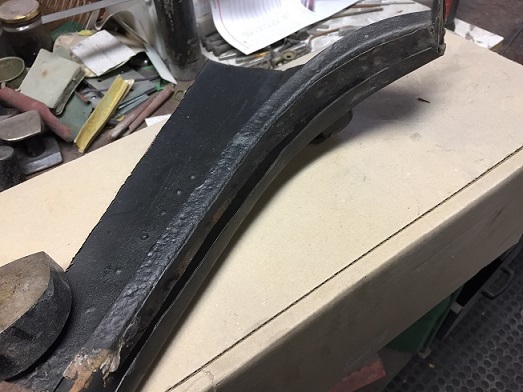

I cut out these and purchased patch panels from Rare Spares.
Guard 1.JPG (80.13 KiB) Viewed 25618 times
Guard 2.JPG (83.77 KiB) Viewed 25618 times
Guard 3.JPG (89.71 KiB) Viewed 25618 times
I thought you only over lapped when spray painting not doing rust repairs.
Made the mistake of welding these in on the bench. When I fitted the guards to the ute the panel were out of shape.
I had to cut the welds open to relax the metal and then slowly re-weld. Another lesson learnt.

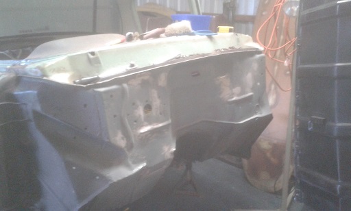

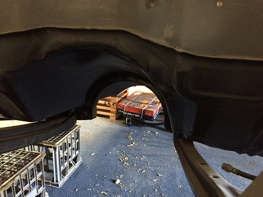

Cleaned up the fire wall and weld up any hole that was not required. Smooth out area that were rough and deleted the battery box. Add a new tunnel for the Trimatic.
You just have to love laying on your back and welding and grinding over your head. As yet no full face mask for grinding and old welding shield.
Fire wall 2.jpg (45.17 KiB) Viewed 25618 times
Lots of advice from Anne-Marie on safety, which is helpful. I so wanted a rotisserie but had to settle for a couple of 44's ( 200 litre ) drums.
