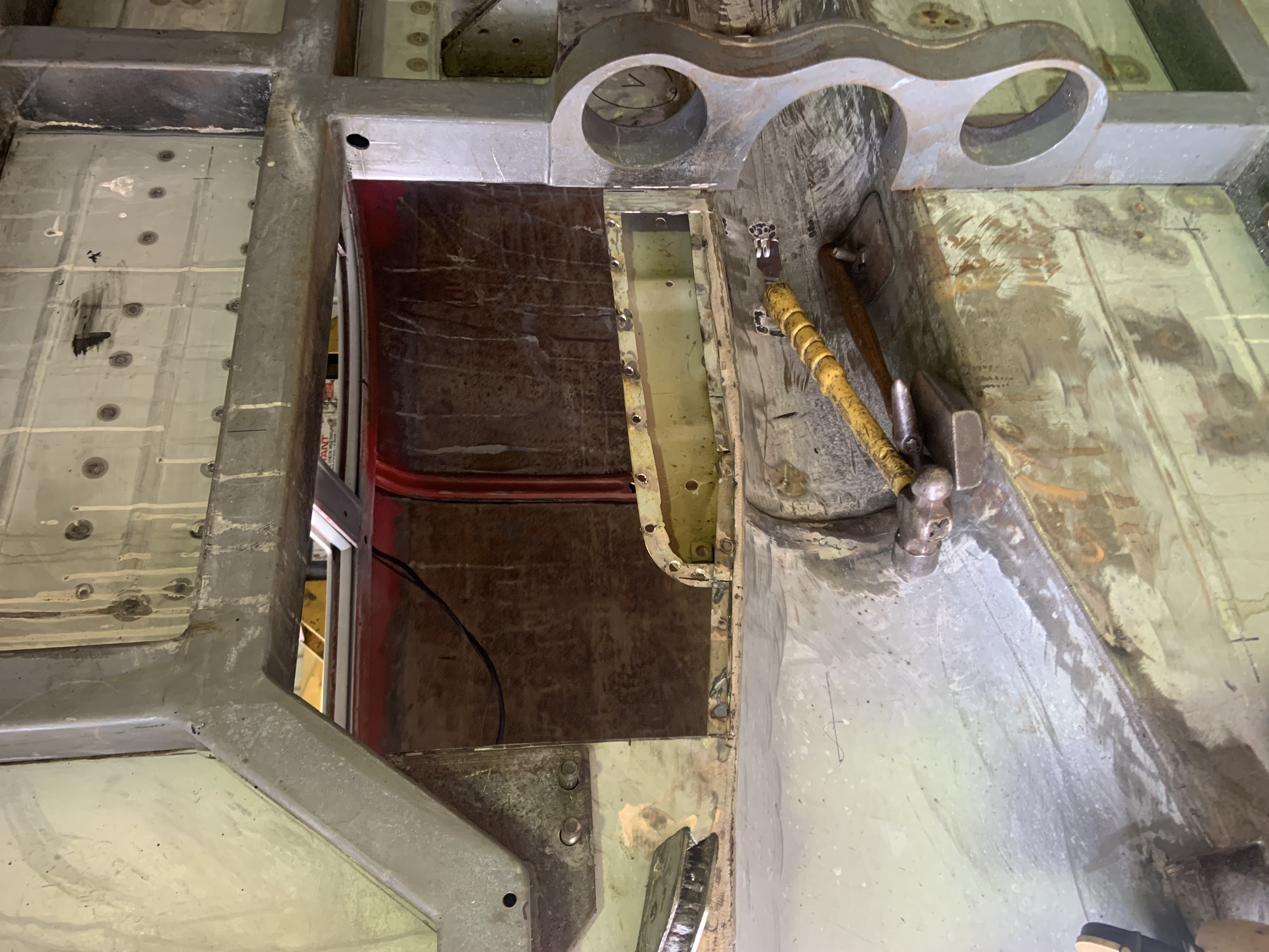

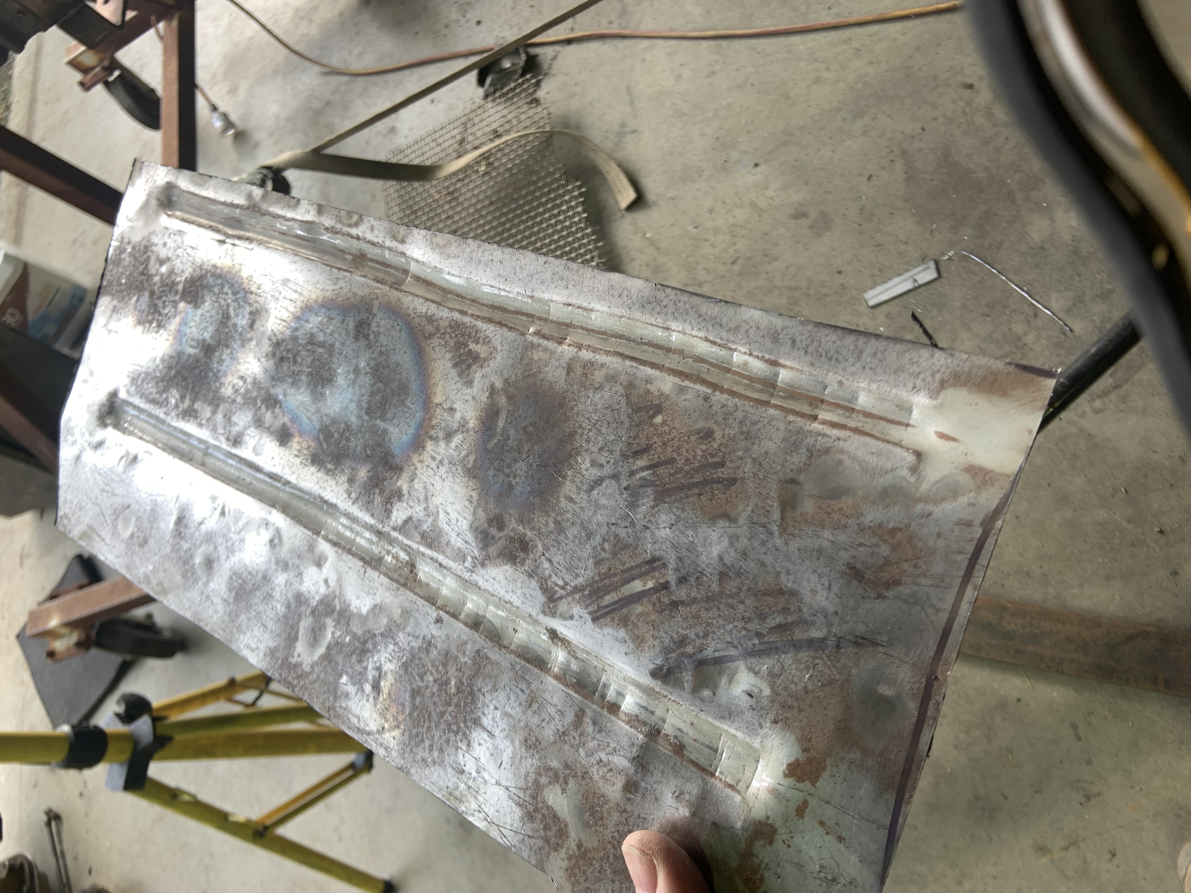

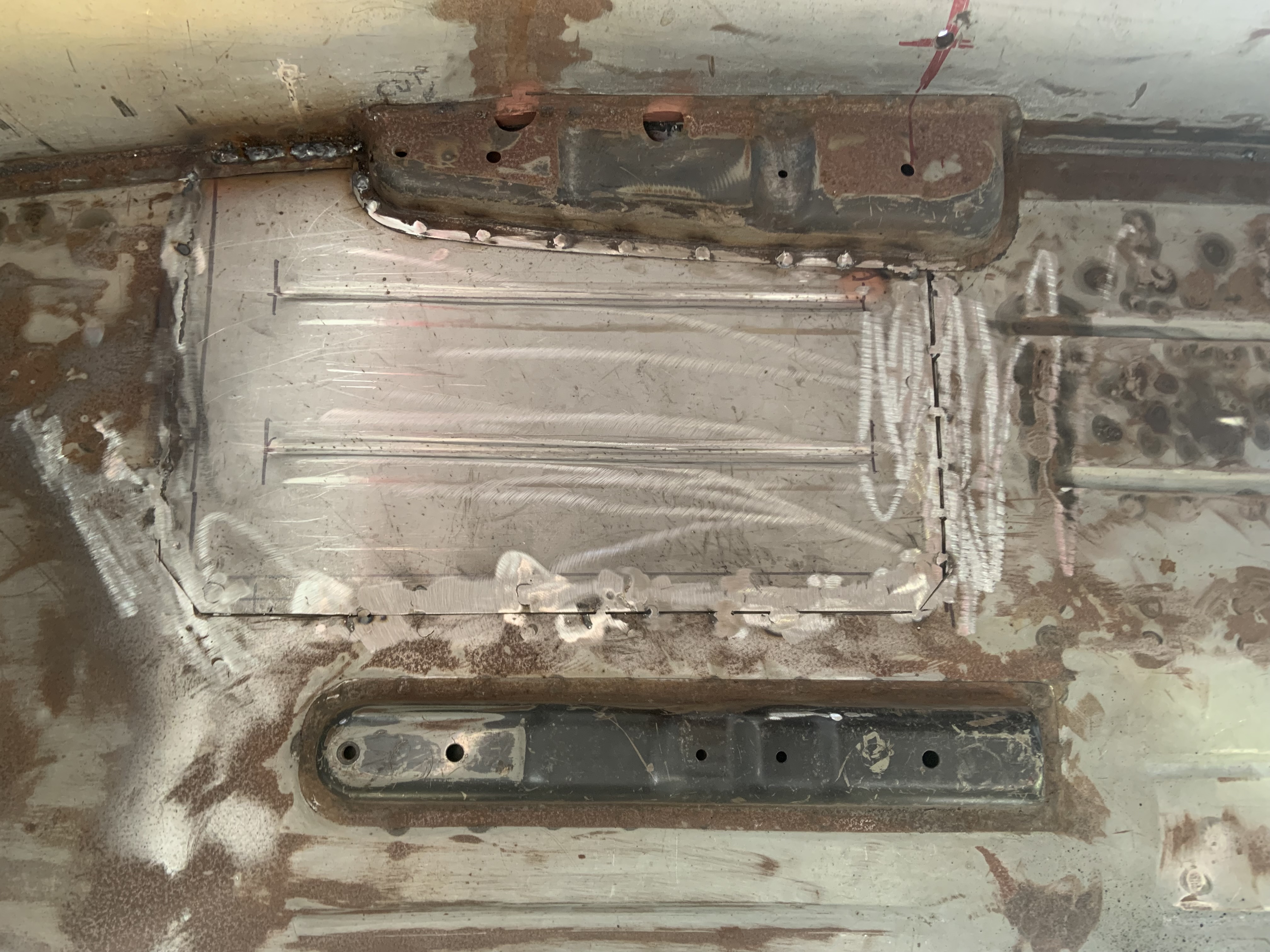

Location: hobart
Re: LS1EK
Post by TAZ »
Well today was a case of going backwards to go forwards. I have been stuffing around with a section of the floor which had oil canning in it for ages. It was giving me the shits, I shrunk it and then it had highs and lows. Hammer and dollied it then it oil canned again.I was going around in circles and it just got worse.
I could had left it as once it was sounded dreaded ect no one would know, well except me. It would had haunted me if I did not fix it. So I bit the bullet and cut the whole section out and redid it, 5 hours latter fixed.
All in all that is all fab work done, no more welding just cleaning up now and mounting of a few items like the overflow tank for the radiator.
Next step is to prepare for expoxy…..
