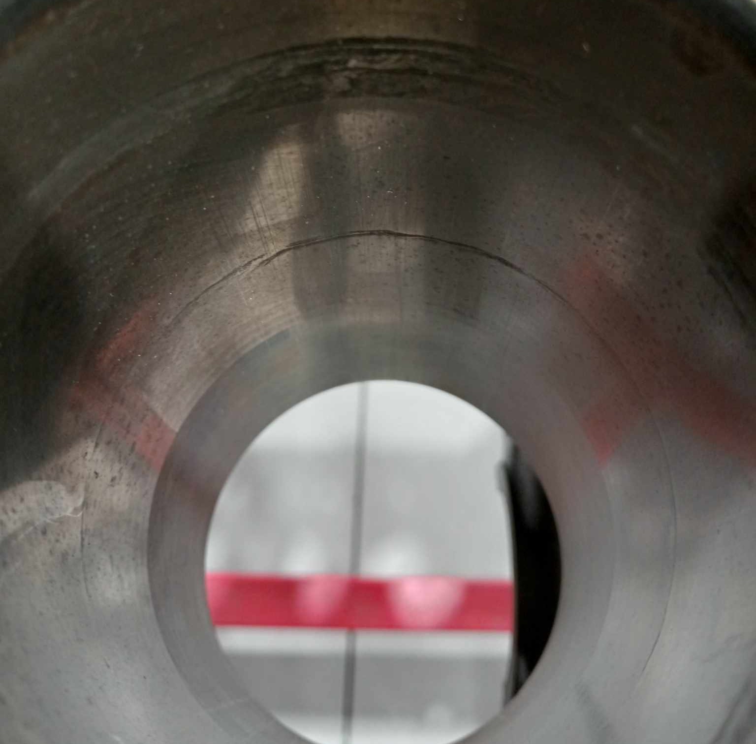

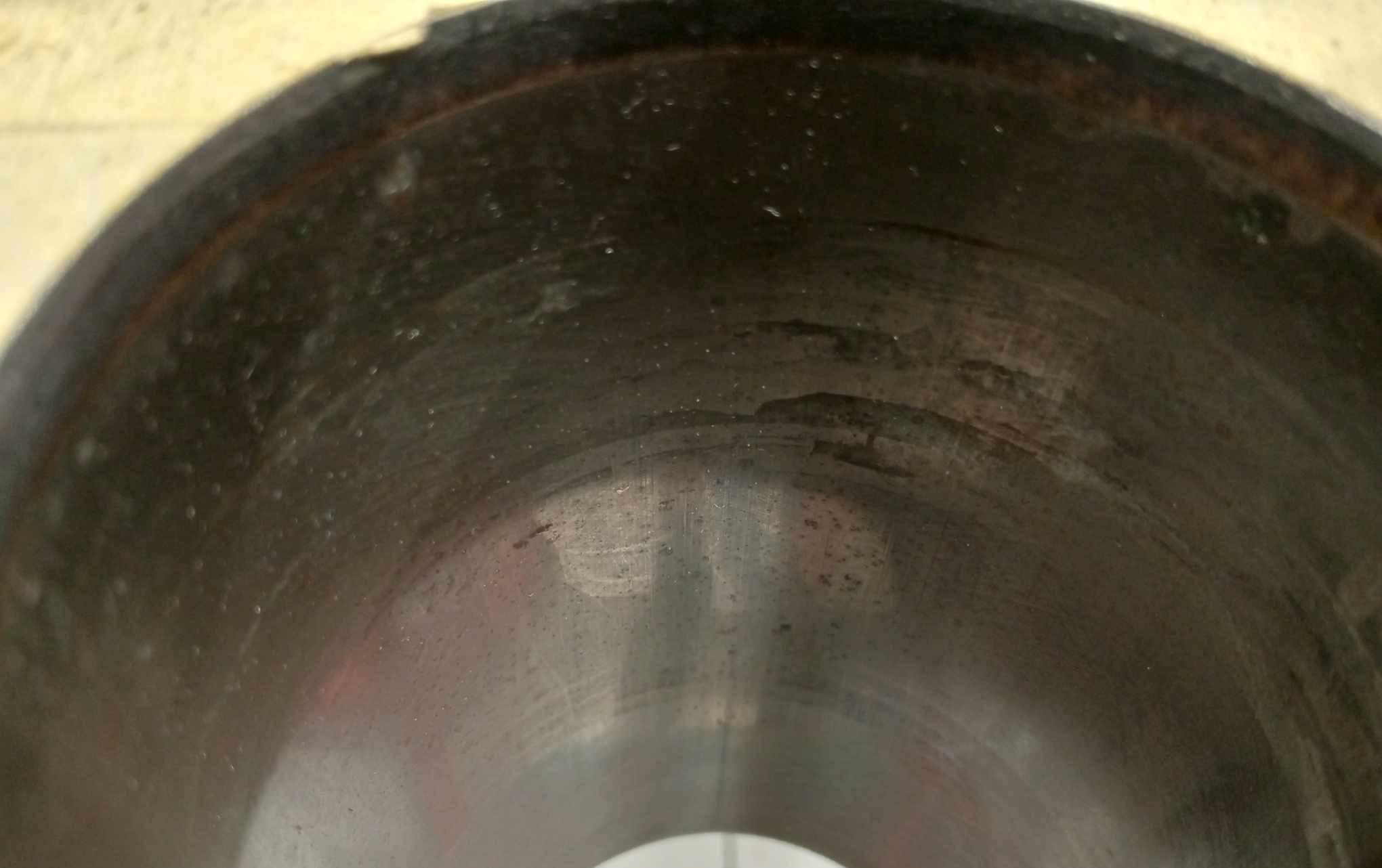

Notably I've pulled the engine to do a rear main seal conversion. During the teardown I found cylinders 3 & 4 corrosion stained and polished out (Glycol is abrasive). The engine was rebuilt by RPM engines many many years ago and the finish cut on the deck surface was very course which had eventually caused a very small leak path between the cylinders and cooling system. This answers the question of a few niggling issues I had with the cooling system. Annoyingly it meant re-honing those cylinders so I've also made the jump to hi comp pistons in the process. I'm going for 10:1 comp.

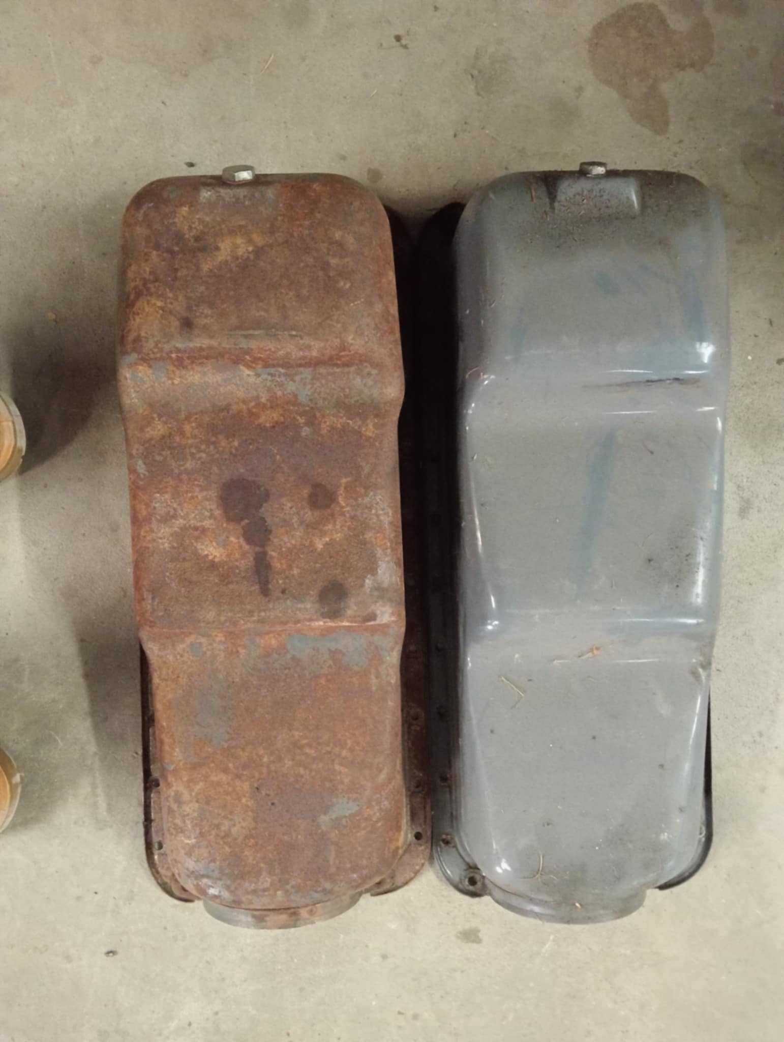

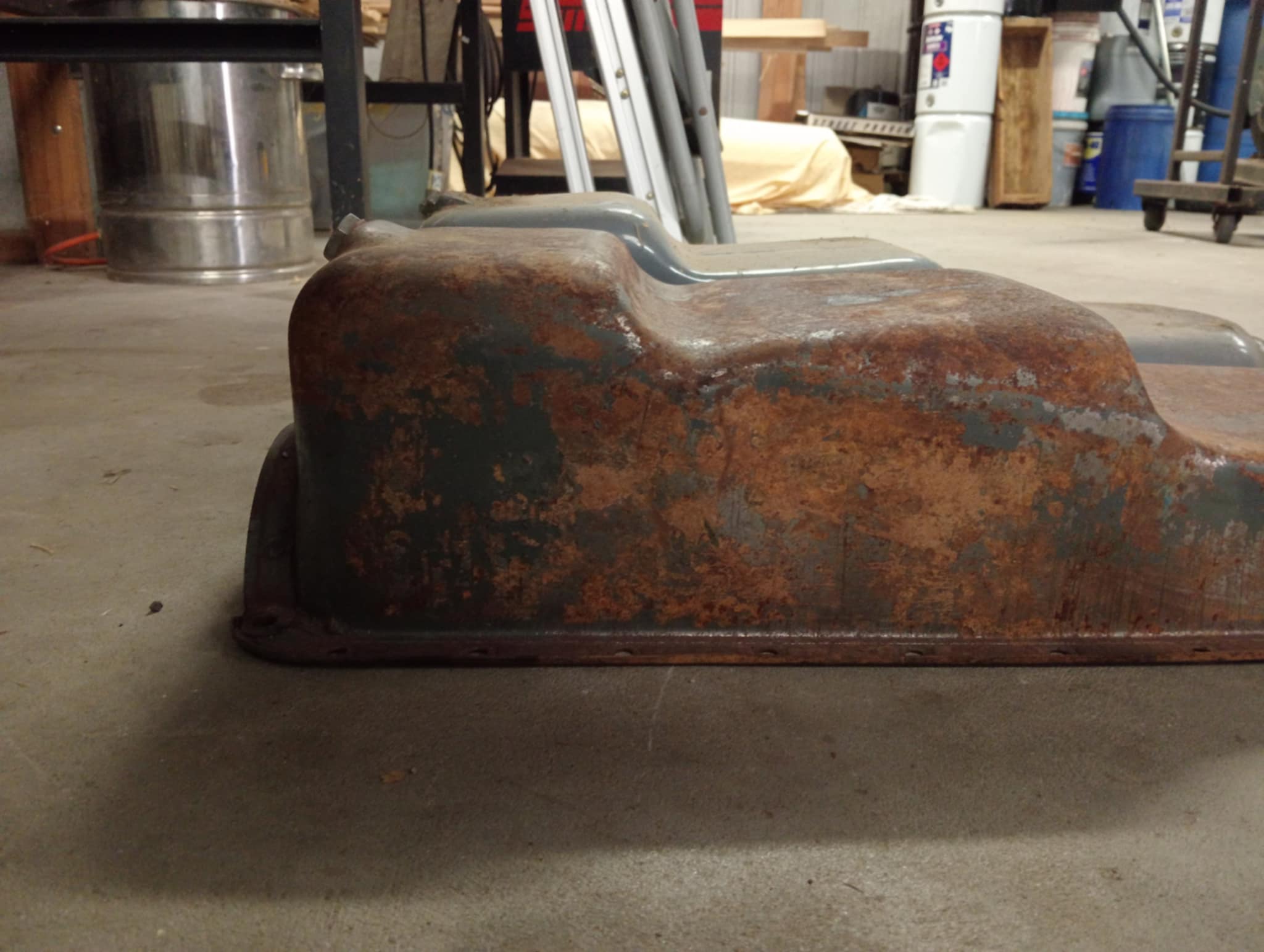

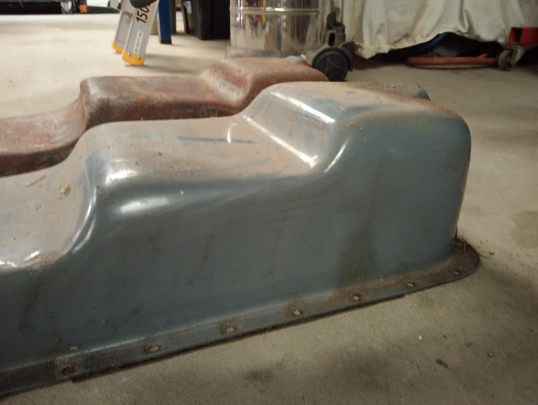

Another issue I've had is the steering connecting rod always rubbed on the sump at full lock. I've now found that EJ sumps are different in shape to previous models. My FB was repowered with a J block back before I bought it.

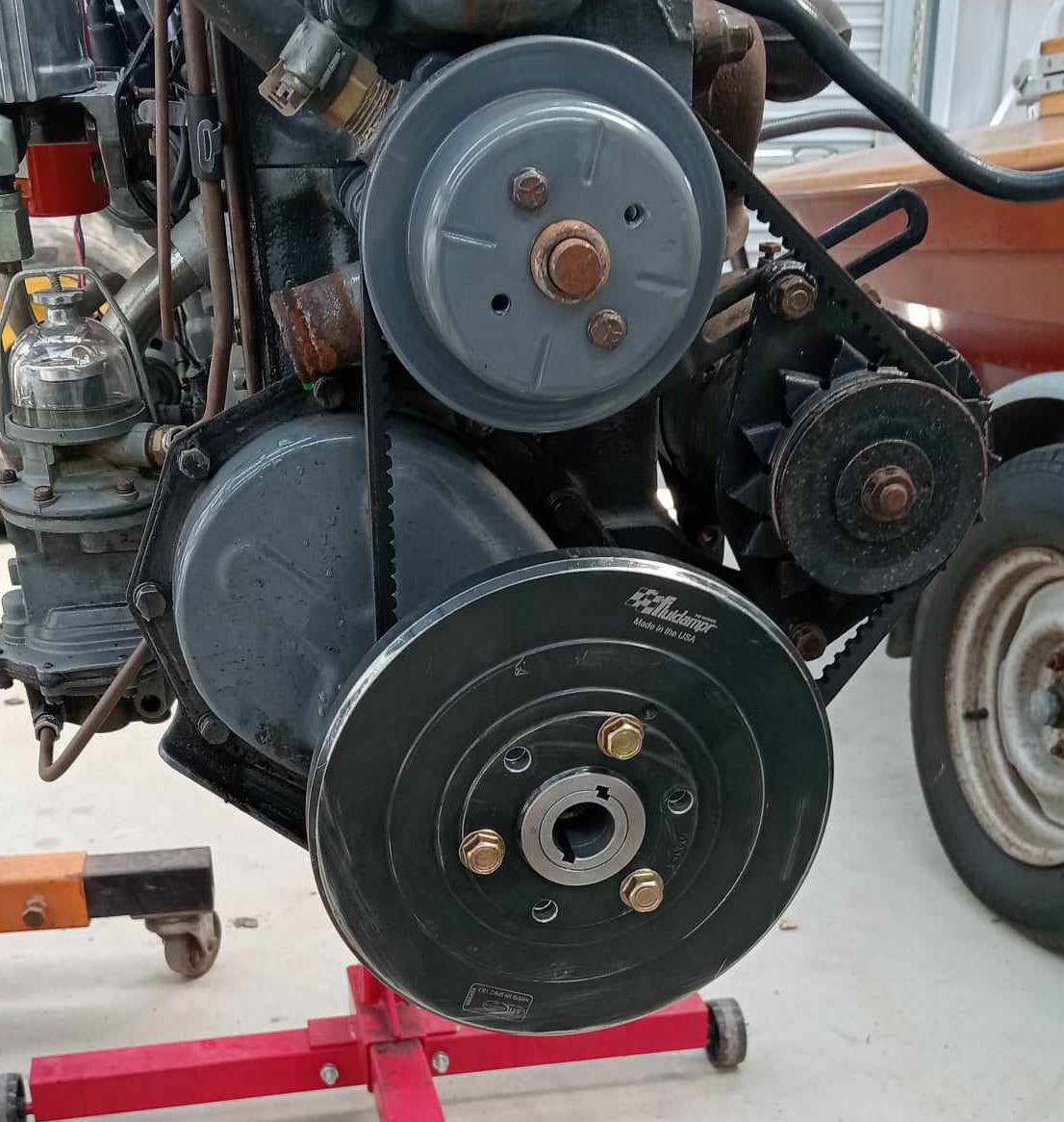

Another little mod I've completed is converting to a viscous crankshaft damper. A change in compression and power output dictates the need for a better damper. These dampers are self tuning over a wide vibration range. It's taken some work to get it to fit. The other intended mods I'm going to do is convert the block to hydraulic lifters and increase the output of the oil pump slightly....watch this space.

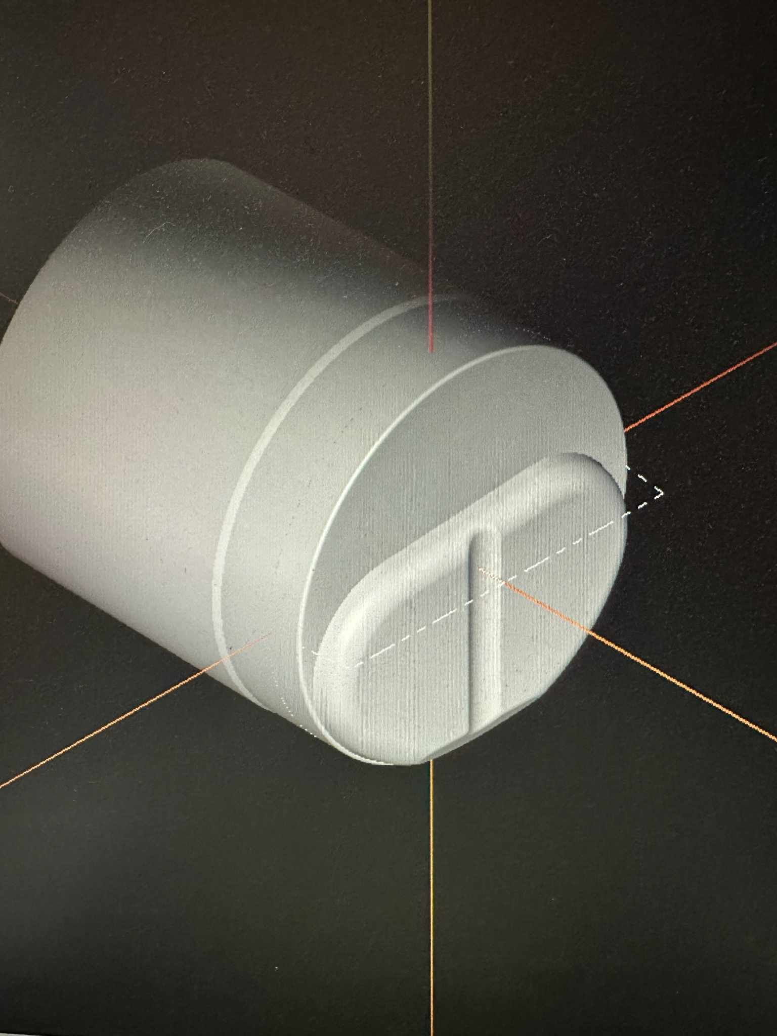

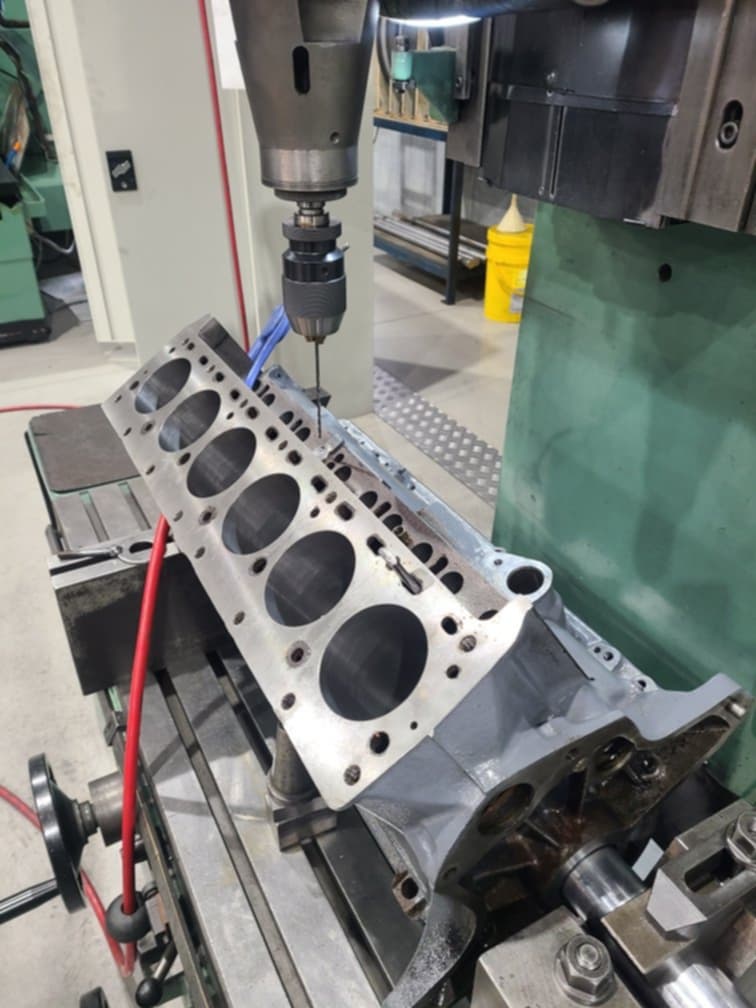

The only real obstacle with the hydraulic set up is drilling the oil gallery from the lifter bore on the correct angle and height to intercept the main oil gallery whilst ensuring correct oil feed to the lifter for the cam lift vs the lifter groove width is maintained.
This means I'll have to manufacture an insert that sits in the lifter bore that can guide the drill bit whilst the block is set on the machine at the correct angle. Fun times ahead.

EH rubs on lock in both our cars and I recall it being an issue in my previous EH sump red motored car. Not by much. I hope your solution works Craig. I suppose you’ve tried shimming up the mounts. I am looking at lowering the body onto the crossmember by a few mm to bring the steering gear down relative to the engine.

Most of the machining done now including converting the block to hydraulic lifters (A grey motor first I think).

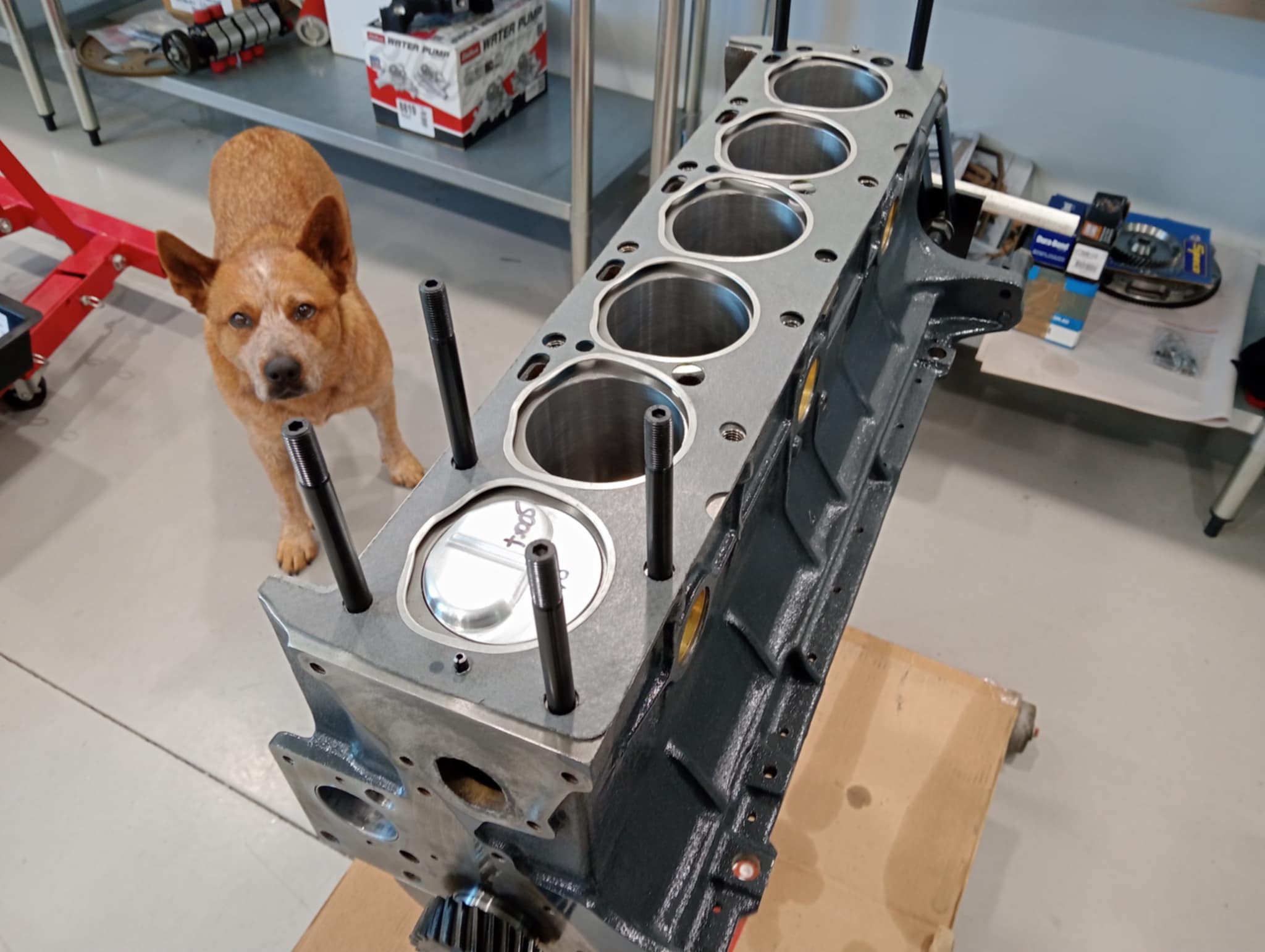

Block dummied up to check piston dome size. Comp now measures 9.9:1.

be VERY interested to see the process involved regarding the hydraulic lifter conversion 8) 8)
