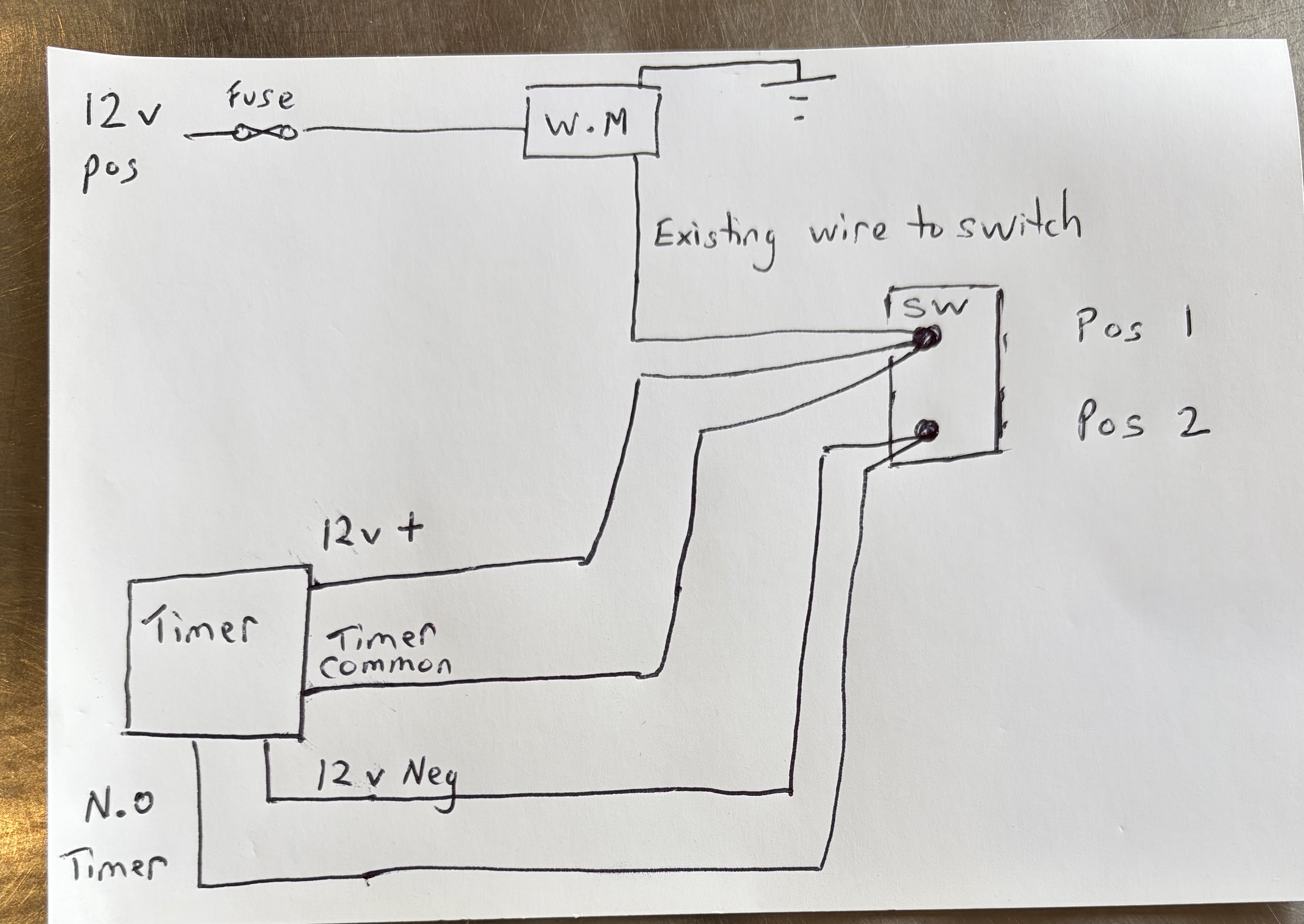

Thanks Clay. This is how I did mine and works ok.

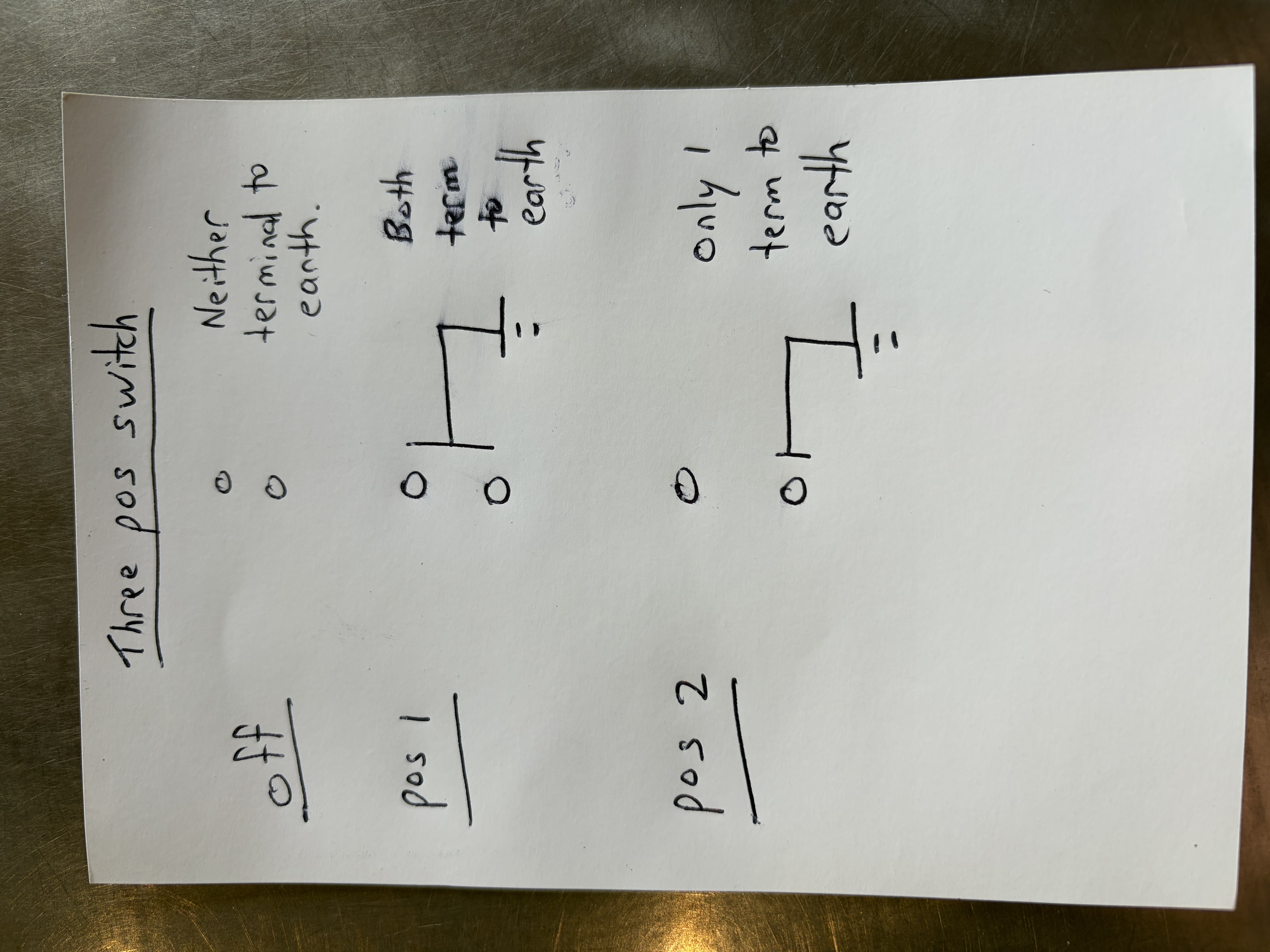

Get your ohm meter to check the three position / two terminal switch functions as shown below.
If that is all good then it can be wired as per below. I understand the timer has an off switch incorporated as part of the adjustment knob. If so the unit would need to be left on and say set for 3 seconds.
When your testing this before re-installation of the switch don’t forget to earth the switch otherwise it won’t work. Hope this helps.

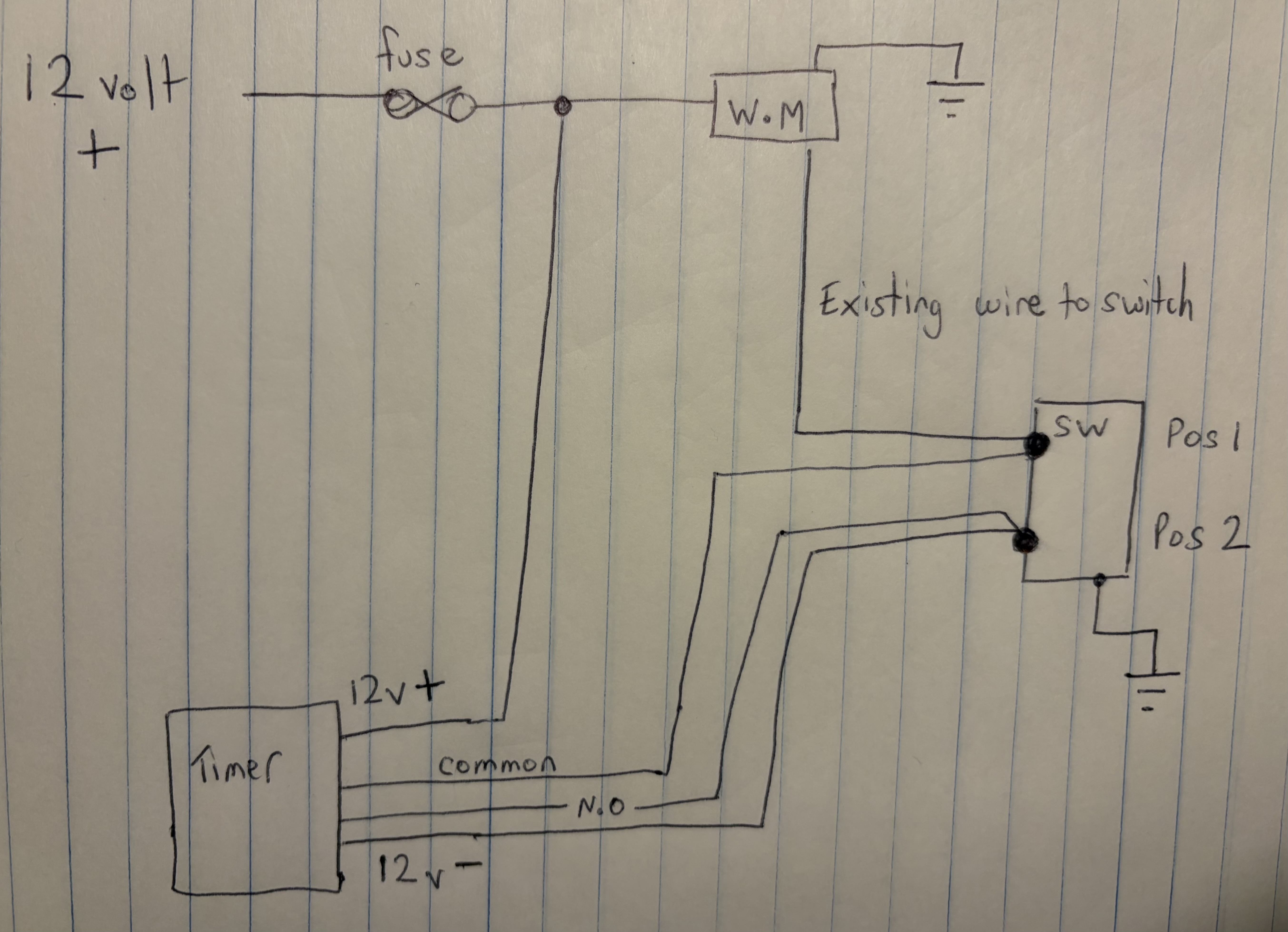

Correction to the earlier diagram, refer to below for amendment 🤔

All done. Int wipers work a treat. Could be faster on the fastest setting, but I put that down to the slow base speed. Thanks to Stephen for supplying a wiring plan I could actually get my head around. I mean, I thought I understood relays but sent me into a spiral. Mounted the switch in the deleted choke hole, which means I finally got round to deleting the choke cable since installing the 390 with elec choke.
