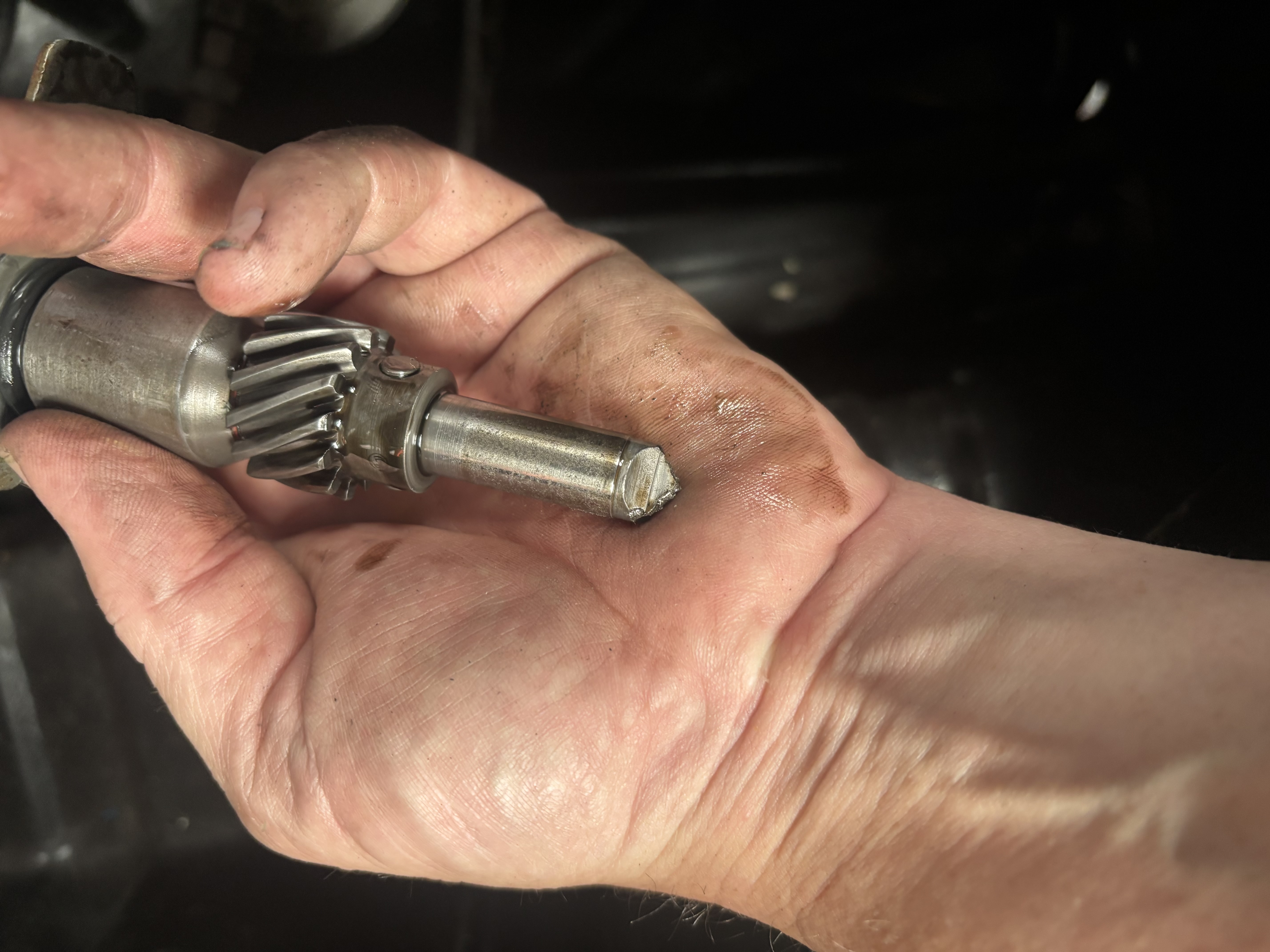

Screwdriver down the dizzy hole, and oil pump is siezed. My bet is that the pump screen has let some crap through, it has jammed the oil pump, and the siezed pump took the tang off the dizzy. It has a steel timing gear, otherwise the fibre one might have let go instead of the drive tang… mebbe.

Pulled the utes dizzy…
Said bad words.
Motor now needs to come out to get at the oil pump. First I need to rig a lifting point in the new shed. One way to christen the shed I guess.
Re: Harv's (Grace's) EK ute
Harv,
That looks fairly conclusive.
The next step depends on whether you like working under a car. Under "Minor Service Operations" in chapter 6 of the EK shop manual, the instructions for oil pump service are somewhat like this -

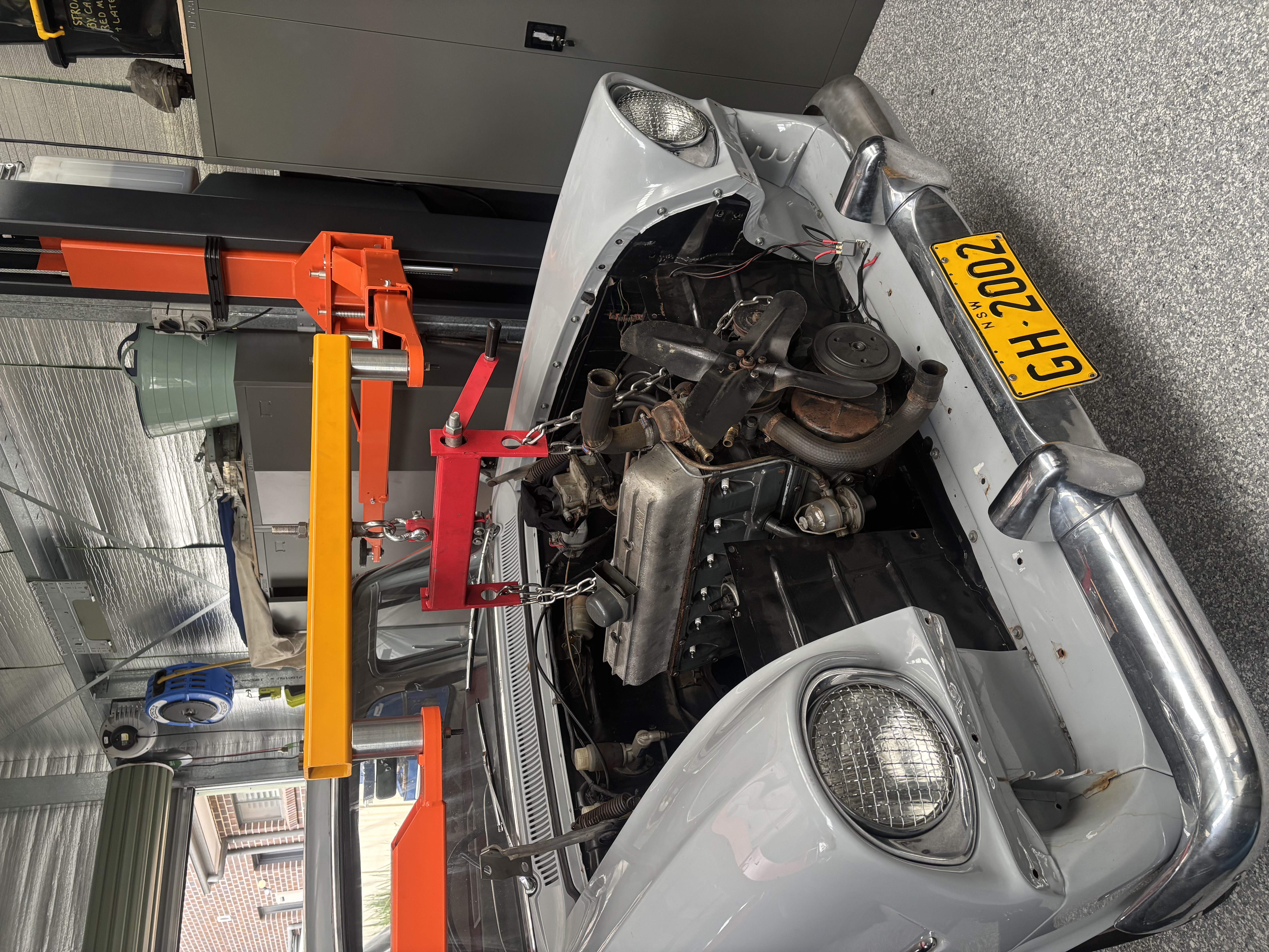

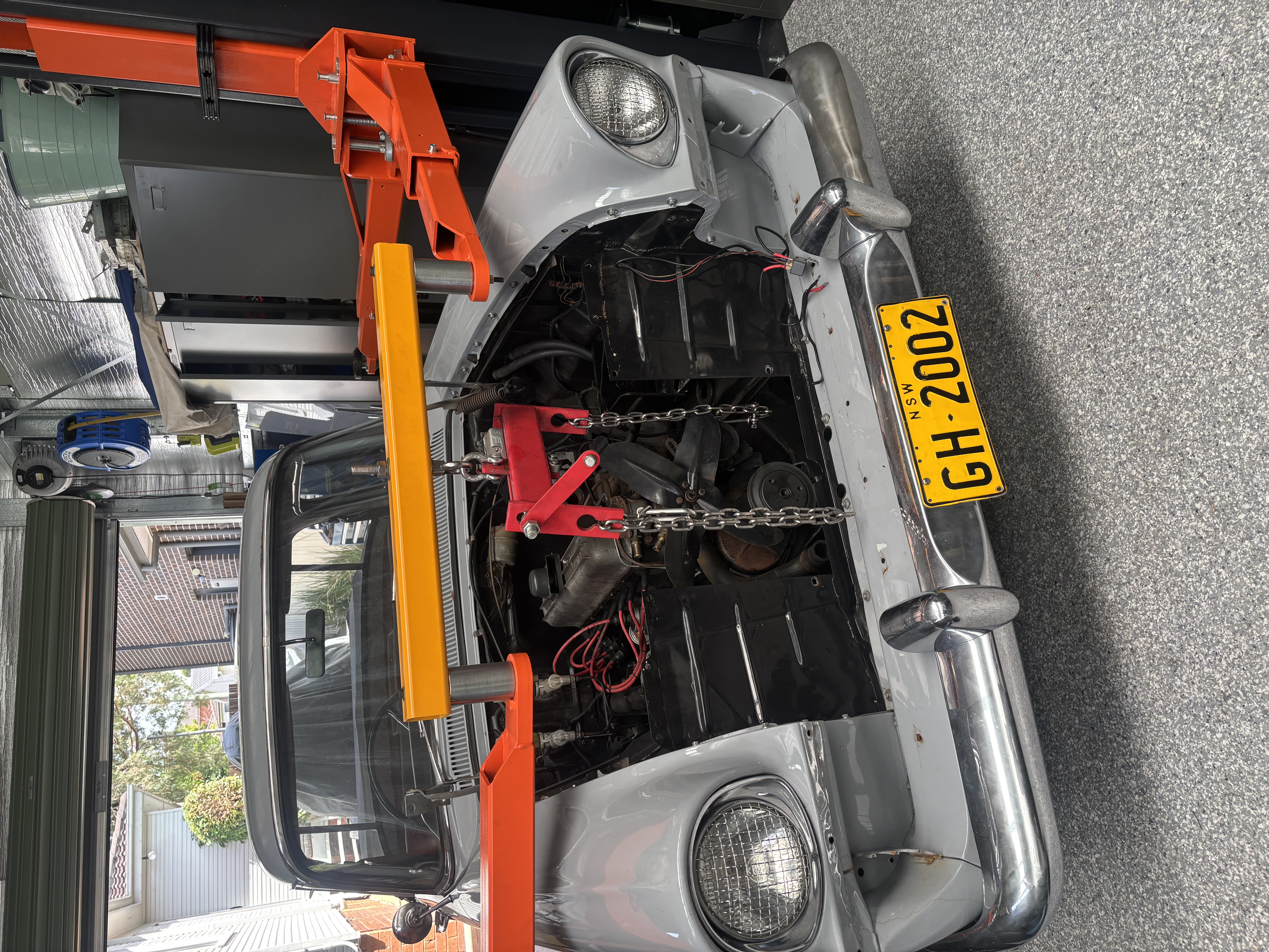

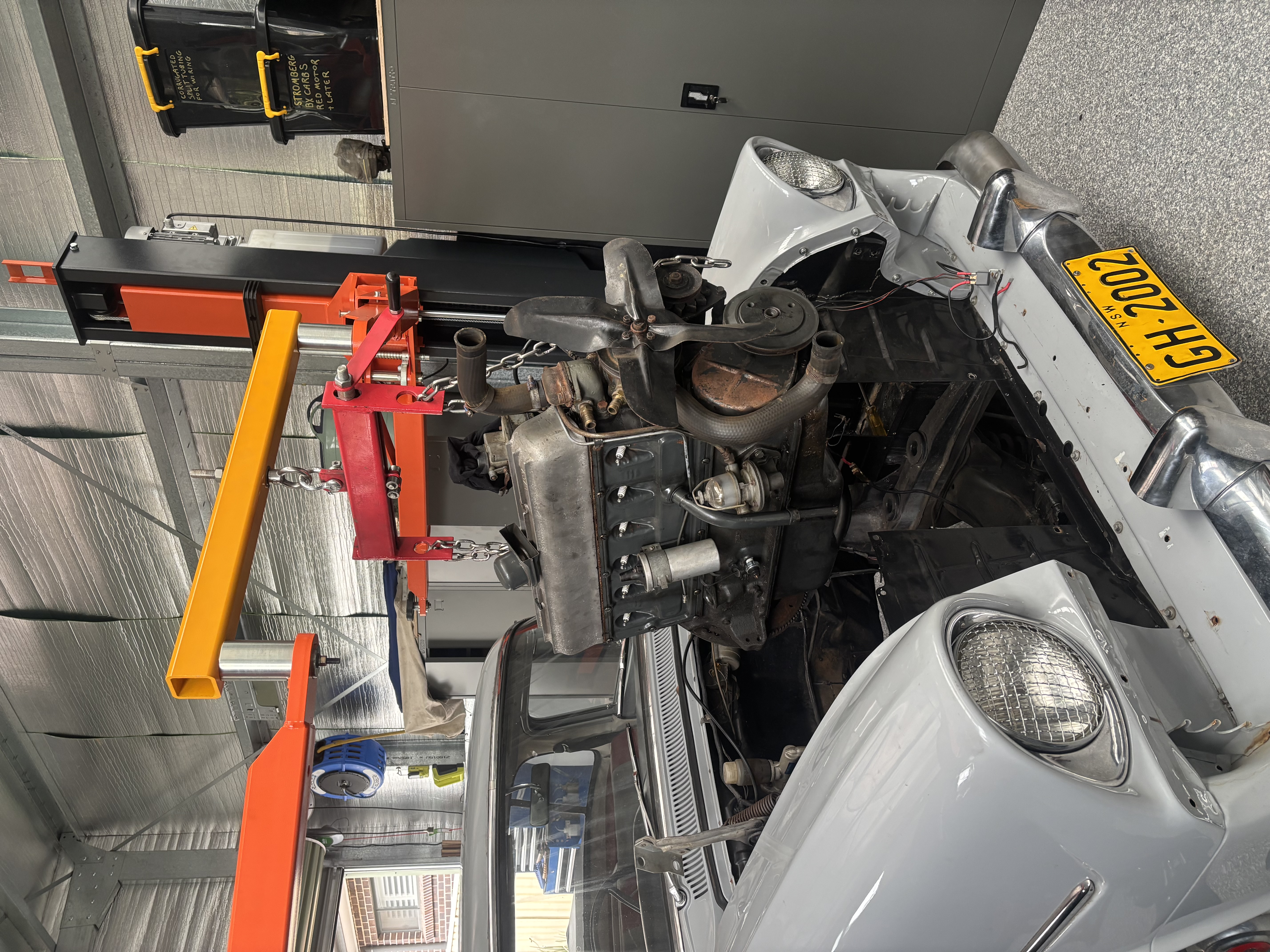

It’s out.
Nice engine crane you got there mate
Very practical thinking there Harv, I like it. Interested to see what you find as you look deeper into the motor.
