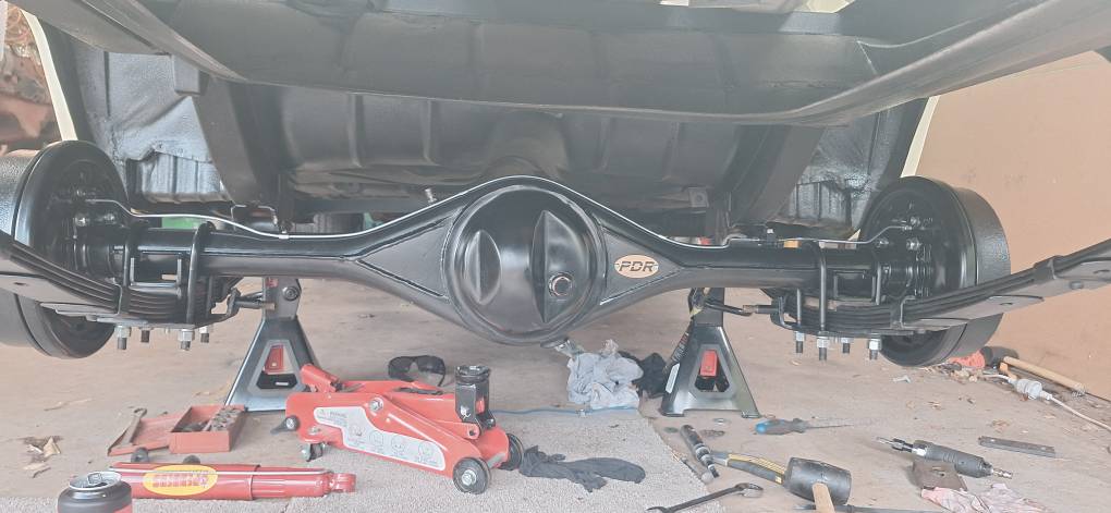

Diff is in finally, gets some tyres this week shocks in next weekend. Motivation is back !

Posts: 11639
Re: Family Affair Ek Ute
Looking good sneezy. Are you using the hilux brakes?

Errol62 wrote:Looking good sneezy. Are you using the hilux brakes?
Hi Errol , yeah mate its all hilux apart from the centre. Thinking we might run an electric park brake to cut down on custom cables.

ardiesse
Posts: 1204
Post by ardiesse »

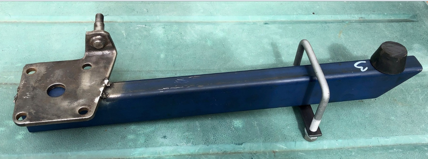

The rear shock/lower spring mounting plates aren't on quite right. They need to be turned over so the shock absorber mounting stud is at the forward, inside corner and pointing forwards. And it would probably be a good idea to put a rear spring rubber and retainer between the rear spring and the shock mounting plate.
Posts: 5734
ardiesse wrote: Sun Oct 12, 2025 9:33 pm The rear shock/lower spring mounting plates aren't on quite right. They need to be turned over so the shock absorber mounting stud is at the forward, inside corner and pointing forwards.
They look OK to me... but then again, I know a bloke who once incorrectly tack welded a set of slapper bars with the mounting plates in that position...

Glad you caught my stuff-up before they were fully welded. Gracias, amigo. :mrgreen:
