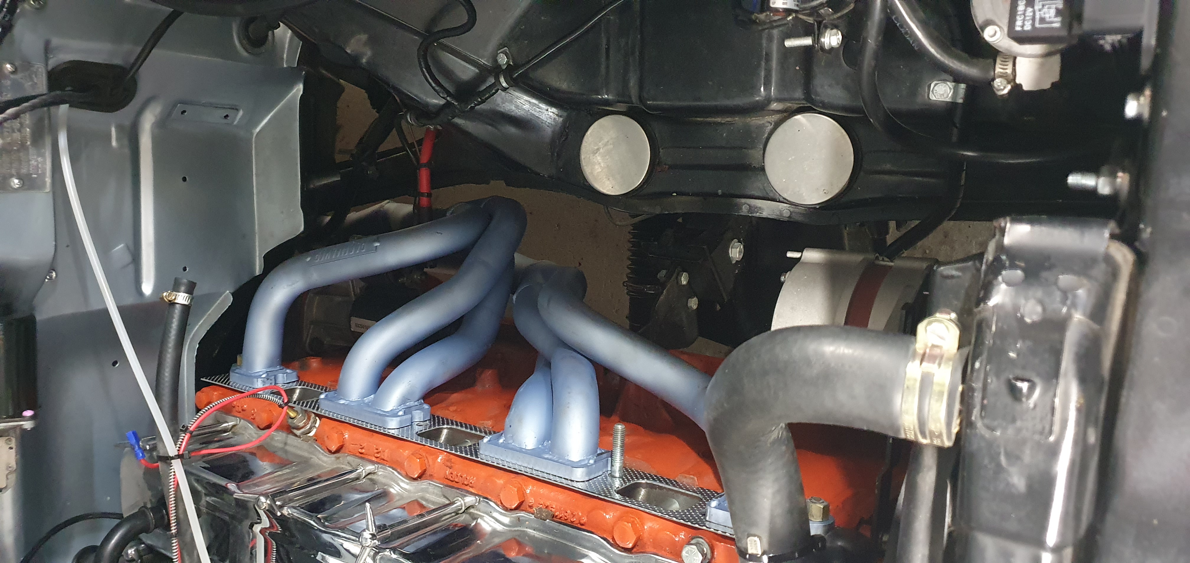

Re: Project 2.
Making some carb changes. While the hole is there, a pic of the extractors for those contemplating.

Post by funkyscooter »
Very handy for me! Have the same extractors along with the triple SU's to massage into that space. Good reference for the firewall massaging required.

Posts: 2535
Re: Project 2.
Scott, the photo may be misleading. I don't think any firewall changes are needed to fit those extractors. The SU's on the other hand might need something done.
Posts: 11659
Re: Project 2.
Depending on manifold and filters used.
Posts: 14263
Re: Project 2.
I had to put a fairly sizeable recess in the rattler firewall for the blower installation - pics would be in the build thread. It's on page 7 of the thread if its any help.
I think I have screenshot of your mods on file Blacky - but I'll take another look. Brett, it's mainly space for the SU's I'm interested in (my set up had 2 front mounted fuel bowls and the rear one is facing the firewall) but with the work I have to do, might as well keep a bit of extra clearance for the headers

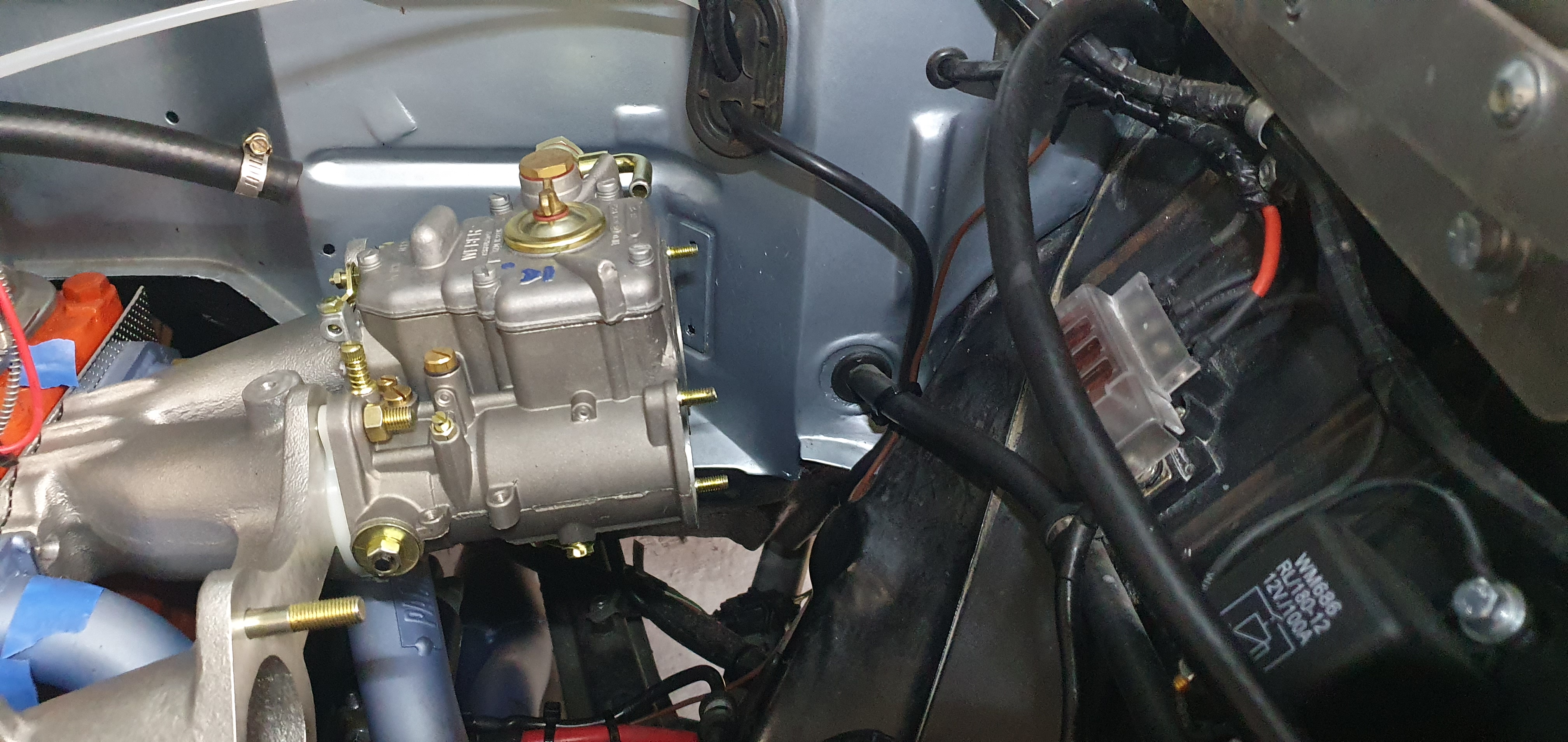

Re: Project 2.
Mucking about with Webers today. My firewall indent is not going to accept a Weber with an aircleaner. This is a pain in the butt to change, but I'll have to do it.🙄

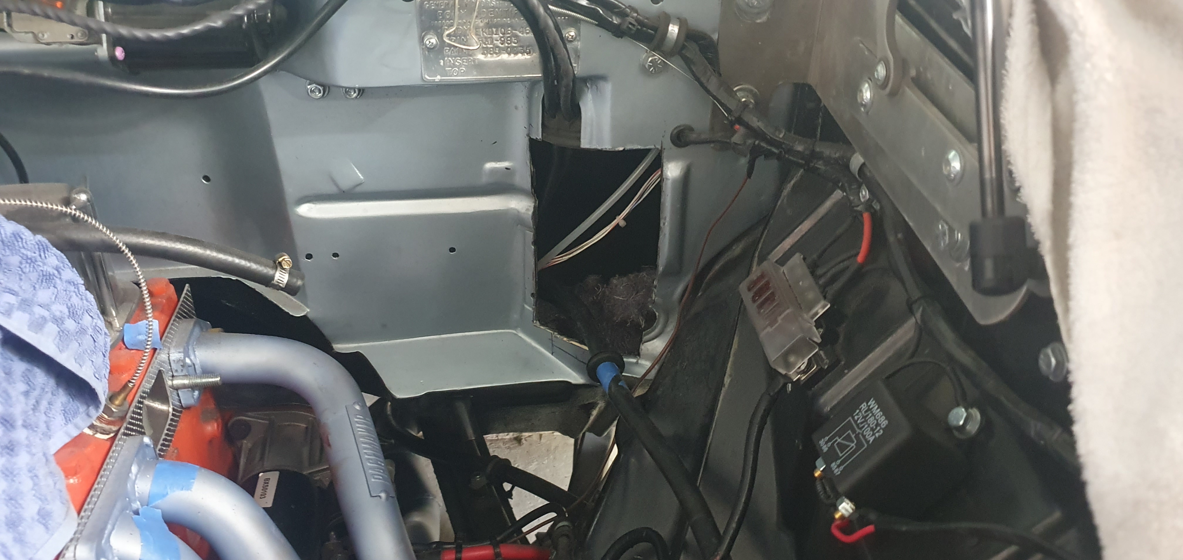

Re: Project 2.
Firewall indent #2

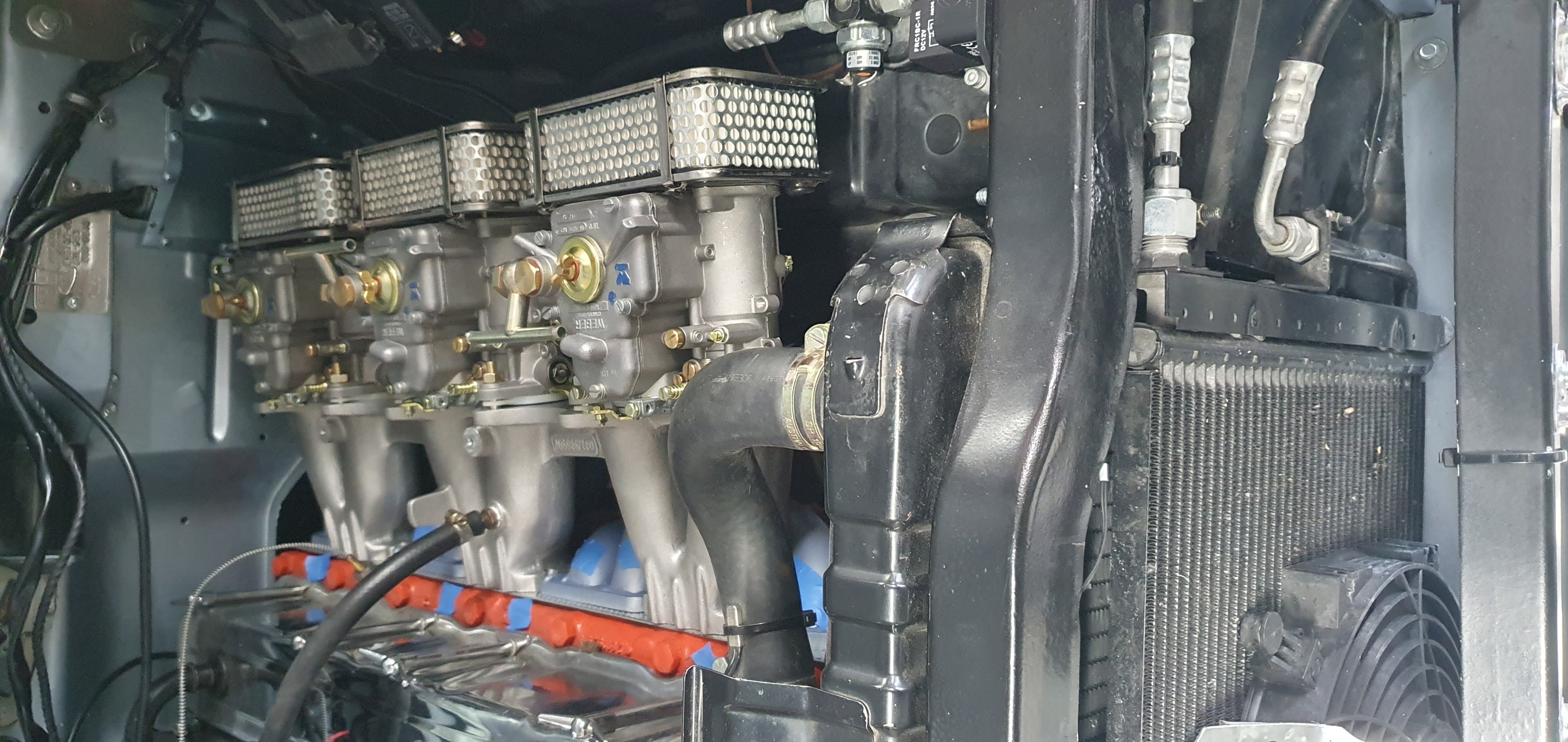

Posts: 2535
Re: Project 2.
Looks a bit agricultural, but it works. Rough mock-up of things.
