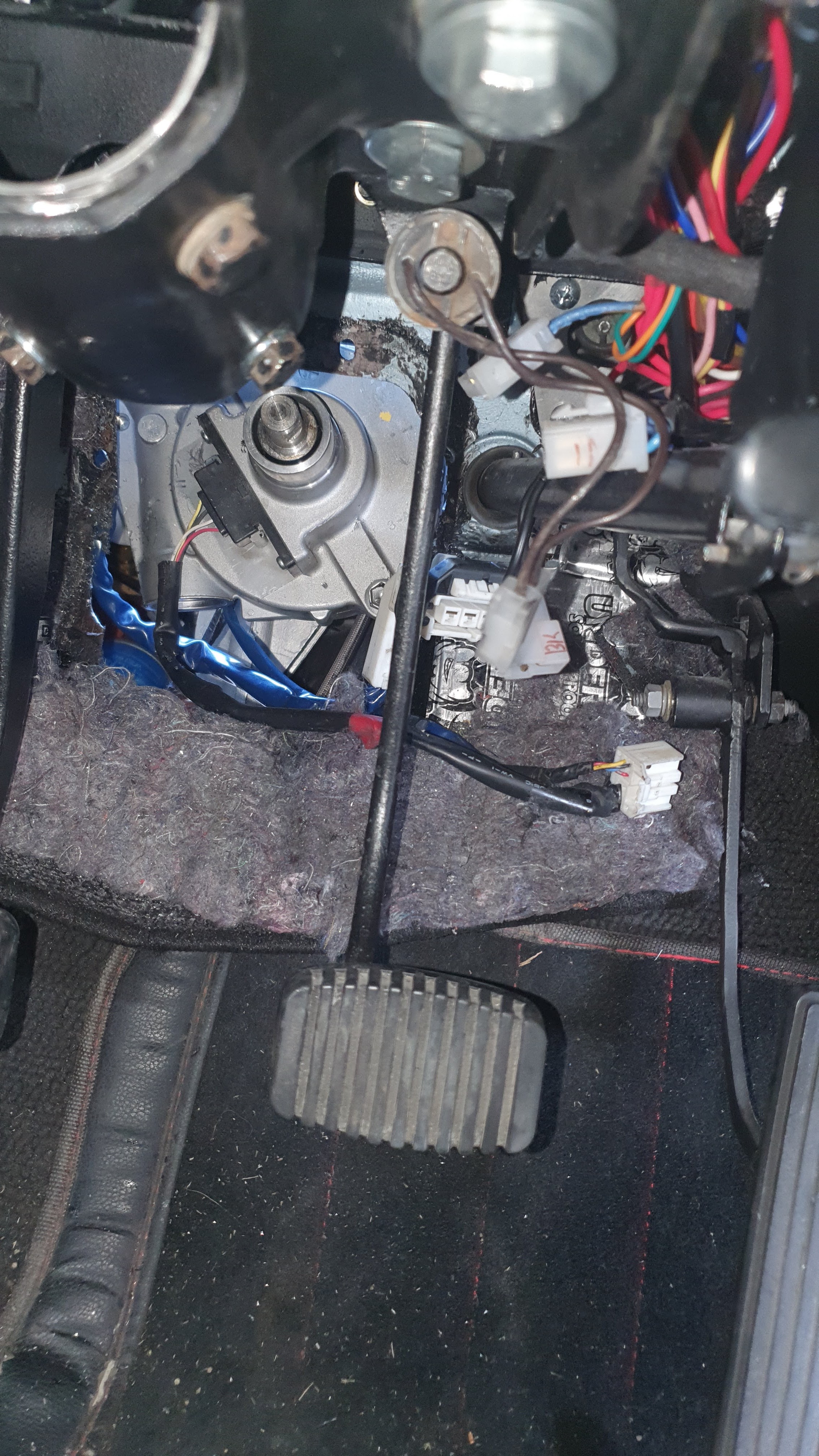

I have spent a fruitless few days attempting to add a Prius electric steering unit to the ute. The unit itself attaches fairly easily to the standard steering box. However, once on, there is 75mm or so of the input shaft and housing entering the cab through the firewall hole. The problem with this is that the space left to fit a universal joint and collapsible column section and breakaway mounts is just not enough. I have been working with George from Alien Retro columns ( very helpful fellow) and he made a rough up column as short as he could, but it still was not short enough to work in the space available. The Prius project is officially canned.
The rear mounted shortened Comodore rack project has officially begun😃

Yes. The concept is sound, but the logistics don't work. A pic of what causes the problem.
Posts: 14059
Re: Project 2.
Thats a shame, I know Rob Hardman managed to have EPS installed on his ute but it retains the grey motor and to the best of my knowledge it is a non collapsible column
Posts: 2515
Re: Project 2.
Yes Blacky, for a standard column, space is a liitle easier but still with the issue of connecting the units up and supporting the end of the column. For collapsible setup with the mandatory 127mm length of çollapsible column and space for the breakaway fittings, it makes it impossible ( for me anyway🙂) to fit in a connecting uni/ fitting to join everything together.
I have a rack currently being sorted in Victoria and my drag car fabricator in Collector has agreed to fit it, so easy job for me.
Now just got to put ute back the way it was last week. I'm going to remove the steering lock and go back to standard ignition switch in the reinstall, which gives me a few spare mm to raise the steering wheel. The Torrie column has the switch on top of the tube which fouls the dash and prevents mounting the column at full height.
