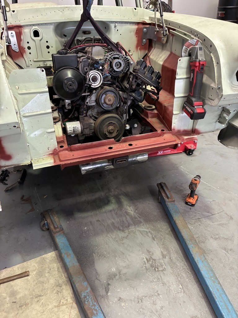

Got into the workshop this weekend and after having the engine and gearbox in and out 3 times I finally got it to where I think it is closest that I can get it to the right angle and the tailshaft again as close as I can get it.

Welded the mounts in fully.
