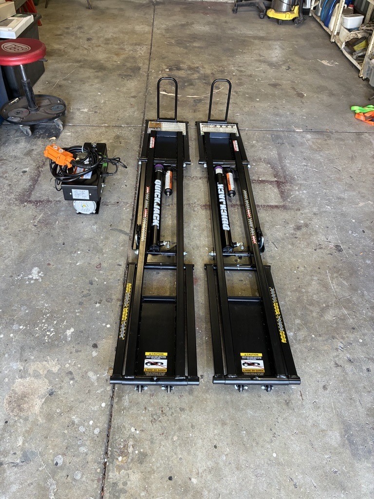

Well things have finally settled down a bit since the move so have had a bit of time to get back onto the wagon.
I don't have a hoist or anywhere to put on know so decided to buy a Quickjack hydraulic stands.
Gets really good height and much more clear when sliding underneath than being on car stands. After I filled them with oil and bled them they worked really well. Went to the workshop on the weekend sand got the engine into the engine bay so I can set the angle and work on getting the engine mounts welded in also come up with a gearbox mount.

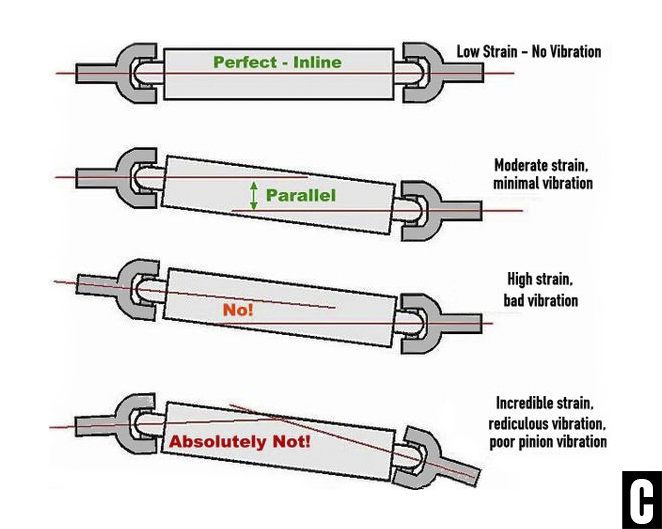

That’s good, so you can keep the two axis parallel. That doesn’t negate the issue of the driveline to tailshaft angle though. This shouldn’t be more than three degrees, so I’m told. By the same token, there needs to be some angle, or the needle rollers don’t precess and therefore wear unevenly.

Surely the rear end has some degree of driveline angle built in, as Clay has suggested 3 degrees maximum.
If you get the gearbox shaft at the same angle that should eliminate drivetrain vibration, i would hate to do all that work then end up with the dreaded teeth chattering !
Actually because your diff center dosent move that is really optimal if you get it right.

For those who are scratching their head, this picture explains it. Greg

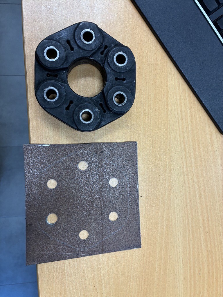

Hi Greg;
Yes the diff does have some angle set in to it, it is a little hard to get a good reading on the angle but now that I have it up in the air and really accessible I can get under and get a good reading. So the photo above is the VE rear coupling or whatever you call it, as opposed to a universal joint, I have made a plate (needs to be cut down some more) to bolt to the coupling once I bolt it to the diff, this will allow me to put my magnetic angle box thingy (same one Blacky showed in the post on the 4 speed) the plate will also allow me to put my cheap (TEMU) laser alignment tool and point it forward towards the gearbox while I align the engine to the diff.
Does this make sense

Greg’s first example I was advised to avoid as it doesn’t allow the roller bearings in the uni joints to precess and share the wear. The issue I am tslking about is the opposite extreme of this, the extreme version of example two, where the angles between tailshaft and the two parallel axis is more than three degrees.

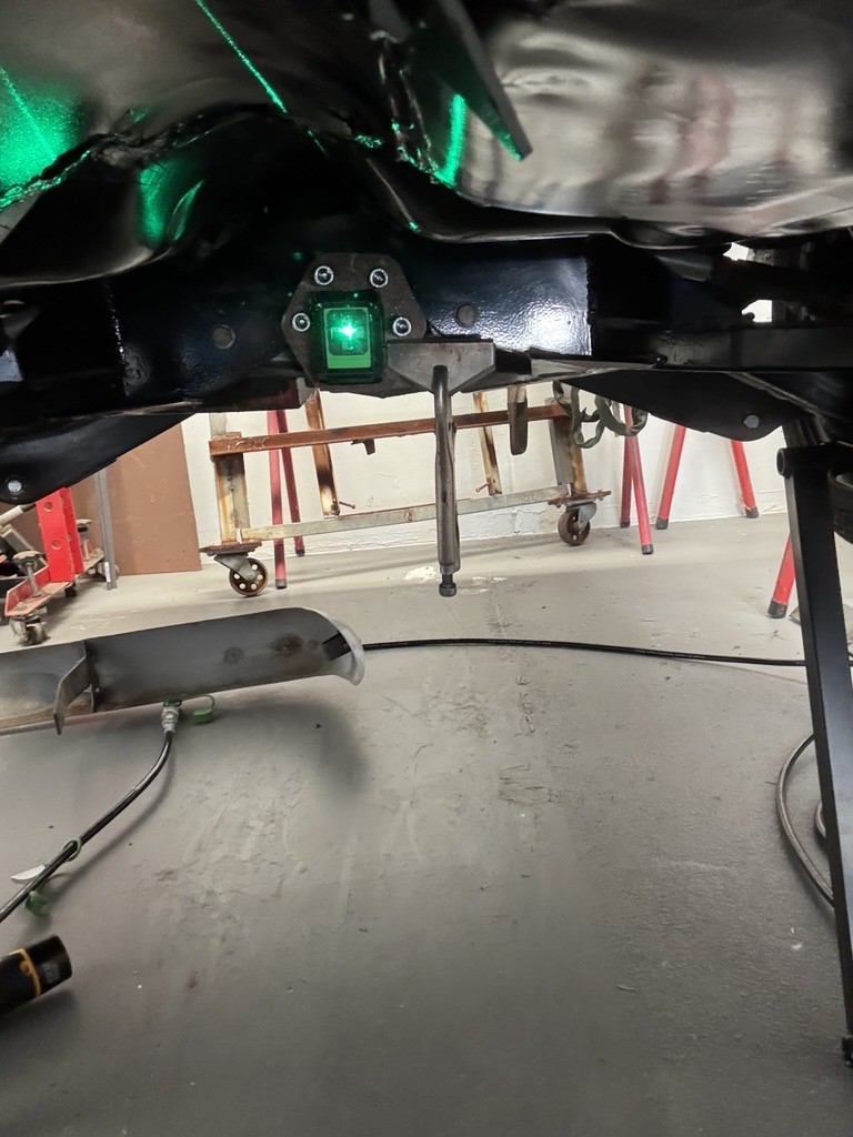

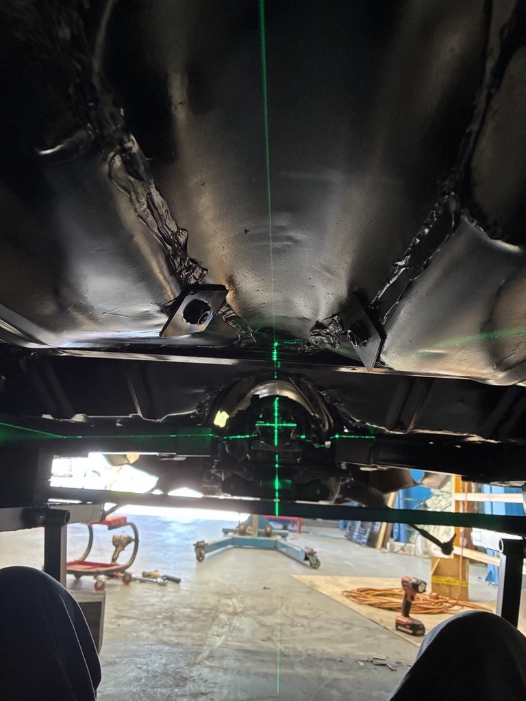

Had a pretty good day yesterday, setup the laser on the diff
Messed around with the engine mounts, once I had the right angle I cut the mounts down to match and tacked them in, went back under and checked the laser and I'm pretty sure I am close
Need to figure out the gearbox support then all back out again fully weld mounts, mark where shifter will go through etc etc.
