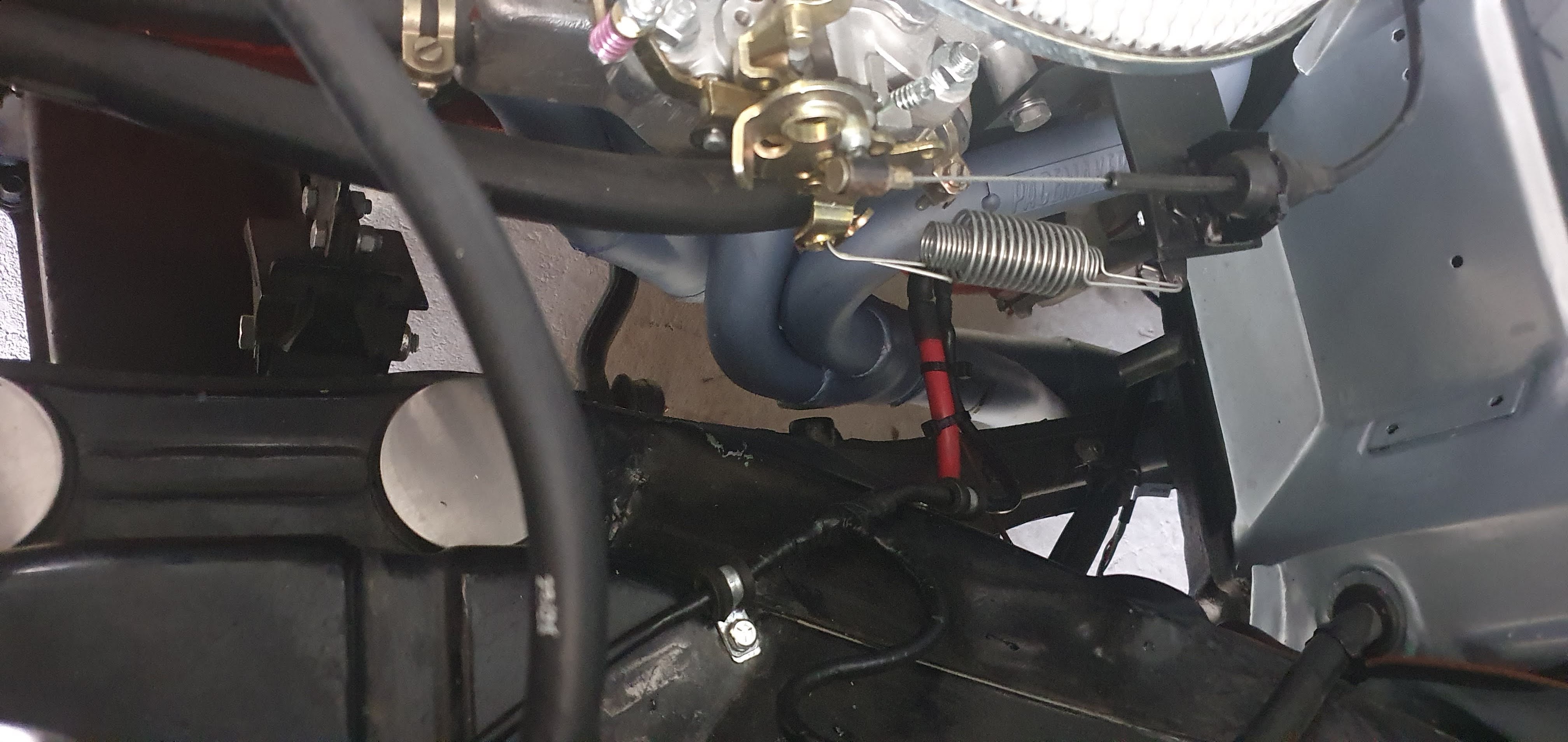

A bit of an update. Pacemaker headers fitted and instant improvement. Had to make a pipe to move across to the mufler which is closer to the sill. Also had to change my power supply to starter slightly, to make a bit of space. The headers are a good fit on the head and bolt on evenly with the standard washers. Engine was running a bit rich for my liking so backed off main jets from 63's to 61's. Static timing reset to 14.5° BTDC. It wouldn't beat my mates 351GT, but it's respectible.

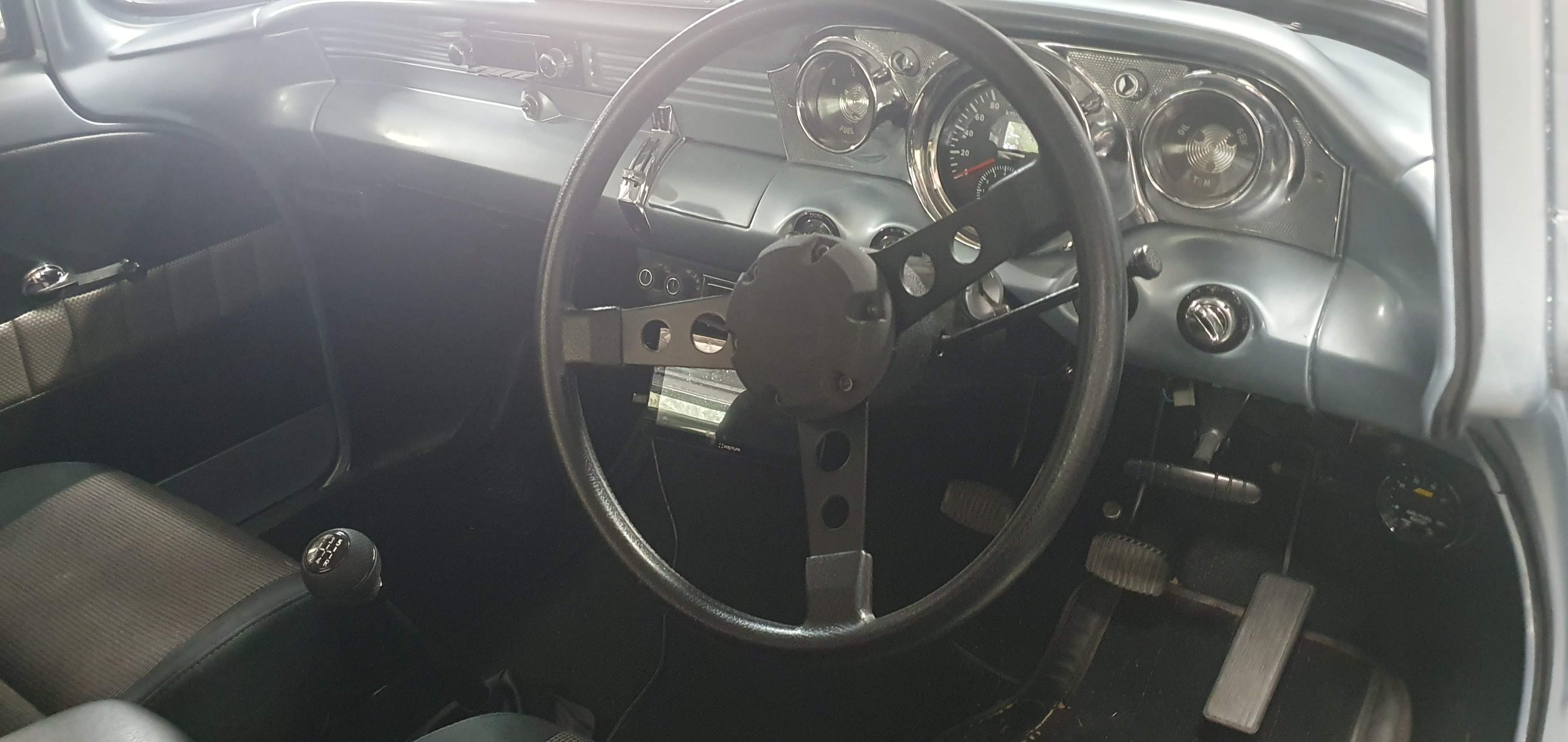

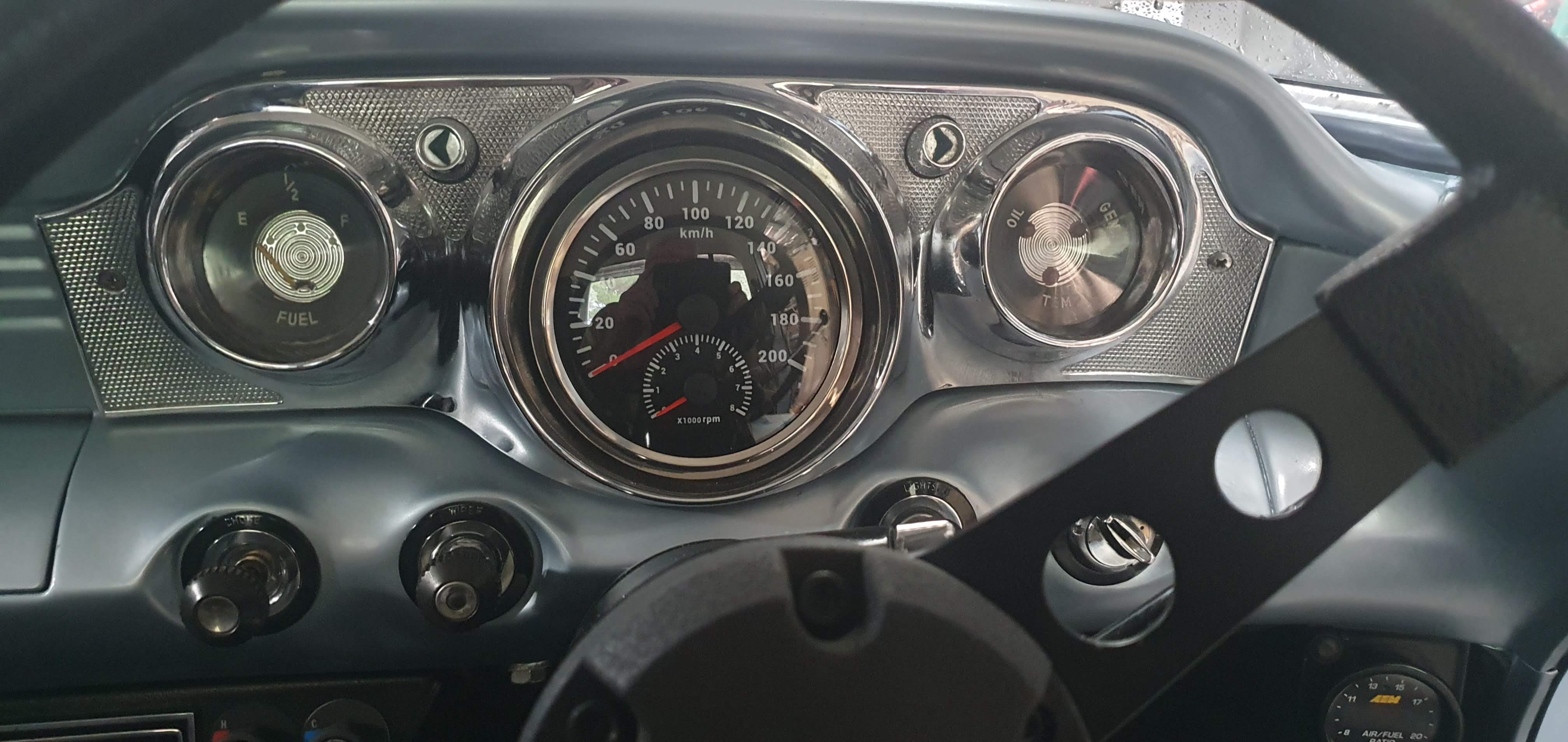

Fitted a cheepie GPS speedo/ tacho combination (purchase discussed in a seperate post). I gave it a run today and speedo (kms) is reading exactly the same as my heads up display unit. Having extra turn indicator lights in the unit is good for me as the steering wheel obscures the originals a wee bit. Tacho has infinite adjustment to match it to the ignition and I have a bit of tweeking to get that spot on, but it works and is easy to adjust. I think the ICE unit may be scaring it a bit. Overall it is a good unit for the $100 I think. Fits straight in the hole where the original speedo goes and is easy peasy to wire in, as all the connections (except the tacho pulse input wire) are already there on the instrument panel to join to. Took me about 4 hours all up.
While I was there I sorted out a glitch that has been there from day one on the road. Turns out I had mucked up wiring a 2 pin flasher to replace the original 3 pin setup. The fix required earthing the dash indicator bulbs and swapping the centre wire on the bulb holder to the coloured wire instead of black which originally returned to the 3rd flasher can pin. An easy fix, which also sorted a phantom headlight relay fuse issue that was also related to the indicators. Also changed my voltmeter +ve wire connection while I was in there.
Photos of headers and speedo attached.

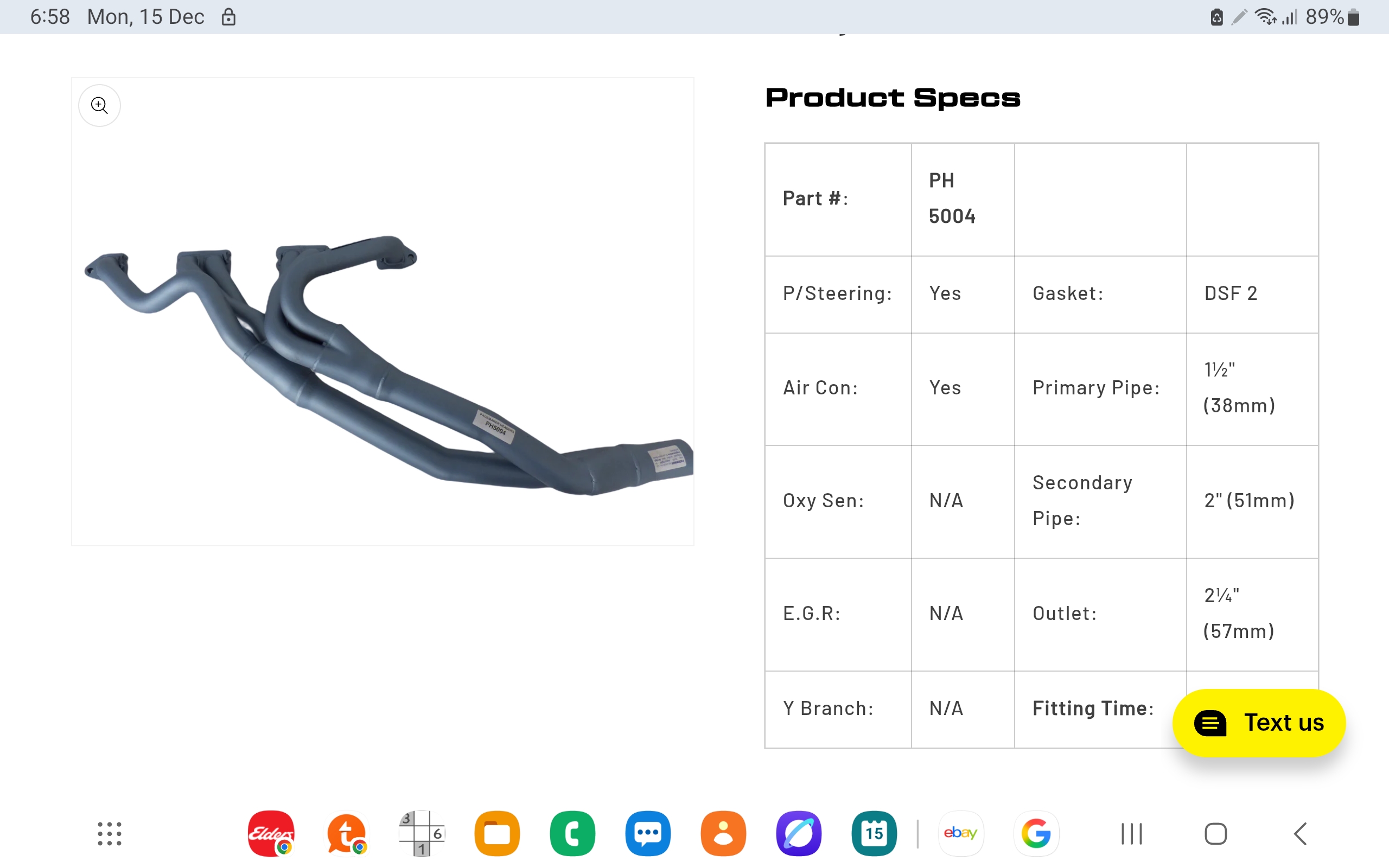

Thanks for the update Brett. Is the Pacemakers you went with the PH5004?

Yes, PH 5004. No issues with chassis kit or anything else. They are about 15mm from steering idler arm support, but not close to anything else.

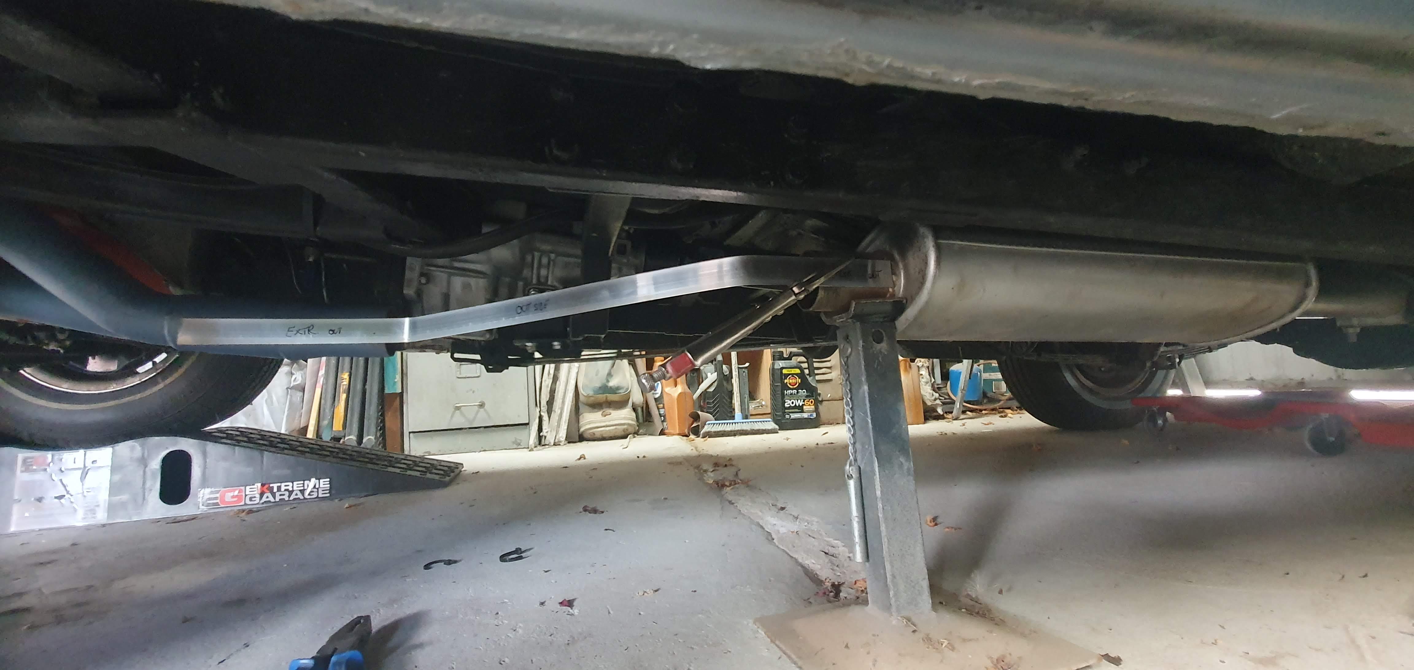

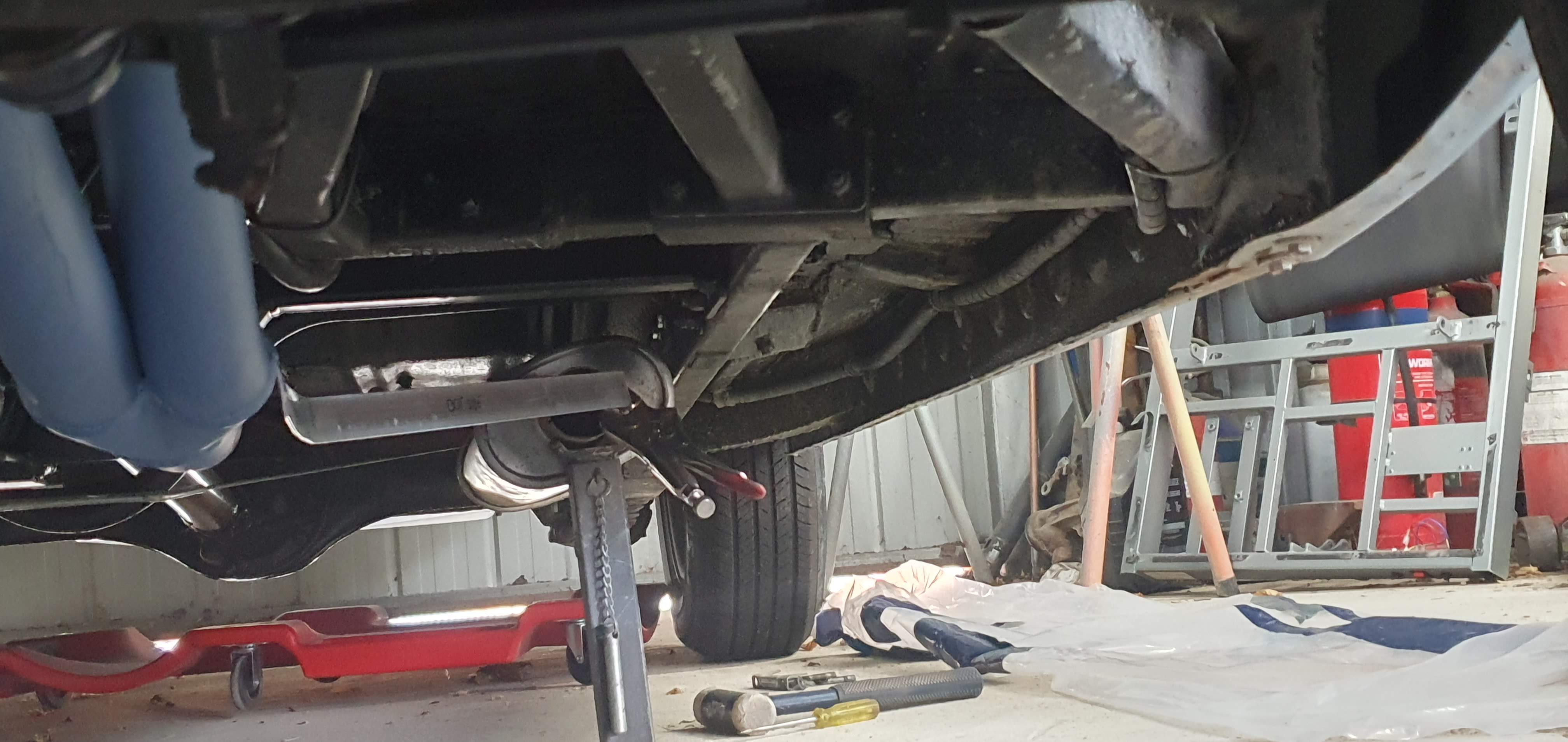

Pics I took before I had pipe made. You can see extractors are miles away from chassis kit and gearbox crossmembers etc.
- 20251216_104231.jpg (469.53 KiB) Viewed 1457 times
- 20251216_104141.jpg (439.34 KiB) Viewed 1457 times

Looking at the specs, they are a decent diameter, primaries and secondaries, and 2.25” outlet is ideal. I will go with 2.25” system next time as it seems to work and sound good on the sedan.
