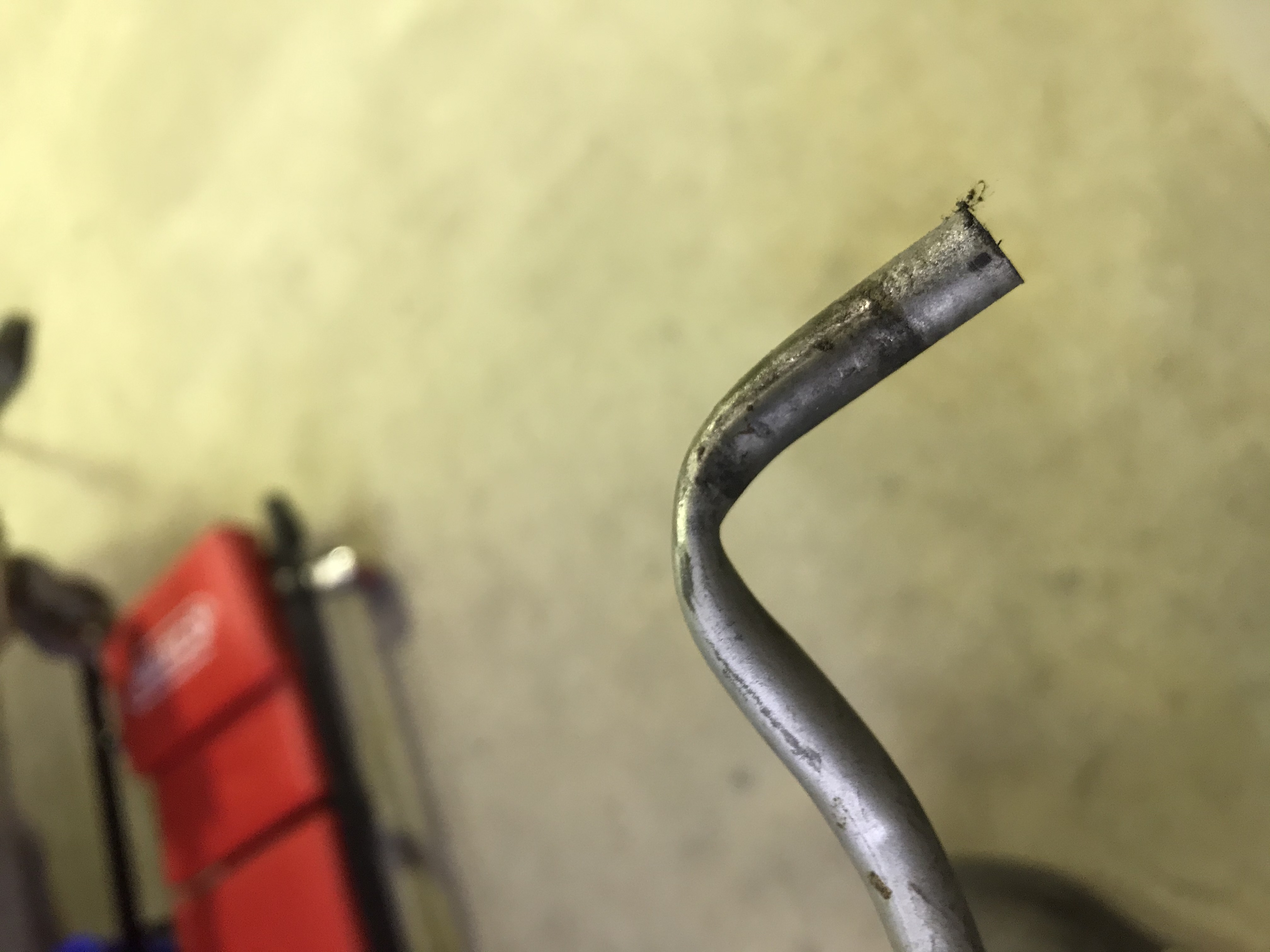

Well I've been knocking up a few K's in Frank since I got him registered, have just gone over a 1000K's, but I suppose like a lot of our builds I have been dealing with a couple of bugs and trying to sort them so I thought I would share.
First - Frank decided to go into "Limp Mode" twice while I was driving, Limp mode was a mode that commodores had to allow you to "limp" home if there was an issue. I didn't understand what this was but with a little research it pointed to "Fluid Levels" I hadn't checked the gearbox oil level after I had a workshop; which will remain nameless; fit the high stall torque converter (they did some other stuff you I still can't believe) so when I checked I found it took 2 1/2 Ltrs to bring it up to full, I didn't think this was a lot but Frank hasn't gone into Limp Mode again.
Second - When the gearbox was changing gears it felt like there was a fairly bad vibration when changing between gears and when I did get up to 80 or 90 it would start to lose revs and always wanted to kick back into second so #1 I adjusted the kickdown cable as per the book #2 I went looking at the gearbox oil lines up to the radiator and back and found that the return line to the box had a kink in it :eh: :crazy: :roll:
The pipe is only 5mm I.D. and the kink looks like it has almost completely closed the return off; I know nothing about the oil flow in these boxes but I cut the piece of pipe out and fitted a rubber hose section (for now) and Robyn and I took Frank to a show with the club that afternoon and the gearchanges were heaps smoother and the box did not try to kick back all the time and obviously my fuel consumption has improved.
